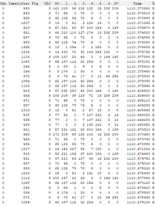

Having trouble with Gen 3 charge controller activating charger.
12kw charger with only 2 modules US version. Controller is sending 12V+ and 5V to both modules but NO activate or enable signal.
Using Cool Term serial port terminal, setup to work without EVSE. What am I missing?

Assuming this is the unit I had back recently it has been confirmed working so one of three things is happening :
1) There is an open somewhere in the wiring loom between the controller and charger.
2) Something is pulling down the signals before they reach the power modules like a short.
3) The unit is improperly configured. (unlikely as it was configured to activate all 3 modules by me).
What I would do is use a bench power supply to apply 5v and 12v and enable signals to each module in turn to see if they wake up and show their red leds. Then work backward from there looking for wiring problems.
All wires from controller to modules have been ohm checked pin to pin. I have noticed once I supply 12v to the controller both charger modules red led light for about half a second then go out. Pin 3 active on charger is looking 3v, what voltage is pin 4 enable looking for?

Ok so controller disconnected I applied voltage to pins of 12 way plug as follows 1 = ground, 2= 12V+, 3= 5V+
6= 3V+, 7= 3V+, 9= 5V+, 10= 5V+ and both modules red LED turn ON. CAN bus reads 121 ohms disconnected from controller and 60.5 ohms when connected to controller. So bench test seems successful.
This is the setup of my system, battery 248V connected to charger, controller parameters 1= Off, 2=123, 3=Master
4=1, 5=1, 6=280V, 7=5A, 8=500, 9=500, a=Off, b=On,
t=290V
When I apply 12V to controller the red led #2 on the controller turns on stays on and the modules leds turn on for milliseconds then turn off. I press the “s” command and LED #1 on the controller turns ON, but nothing on the charge modules happens? I’ve tried this with the AC mains (240V single phase) disconnected and connected same result. Is there a way to debug the CAN to see what the charger is saying?
t=290V
Does the controller look for the correct CAN messages from the charger before it sends the activate and enable signals?

That all sounds good. Do you have Digital input 1 (IN1) pulled up to 12v? This is the charger enable signal.
Know I do, looks like it’s active now. I’m going to connect to a 400V battery will see how it does. What is the low voltage dc limit of this charger? Thanks for the help
