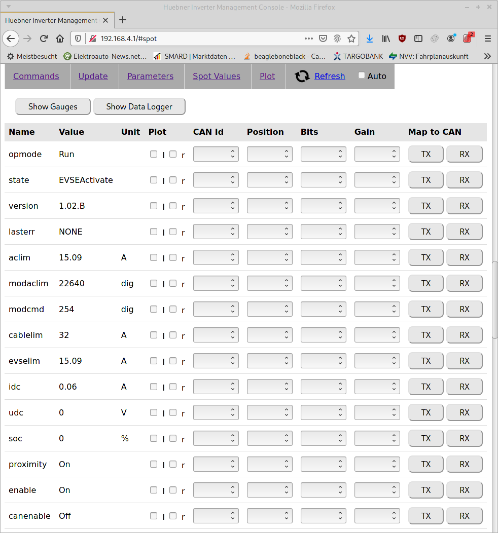

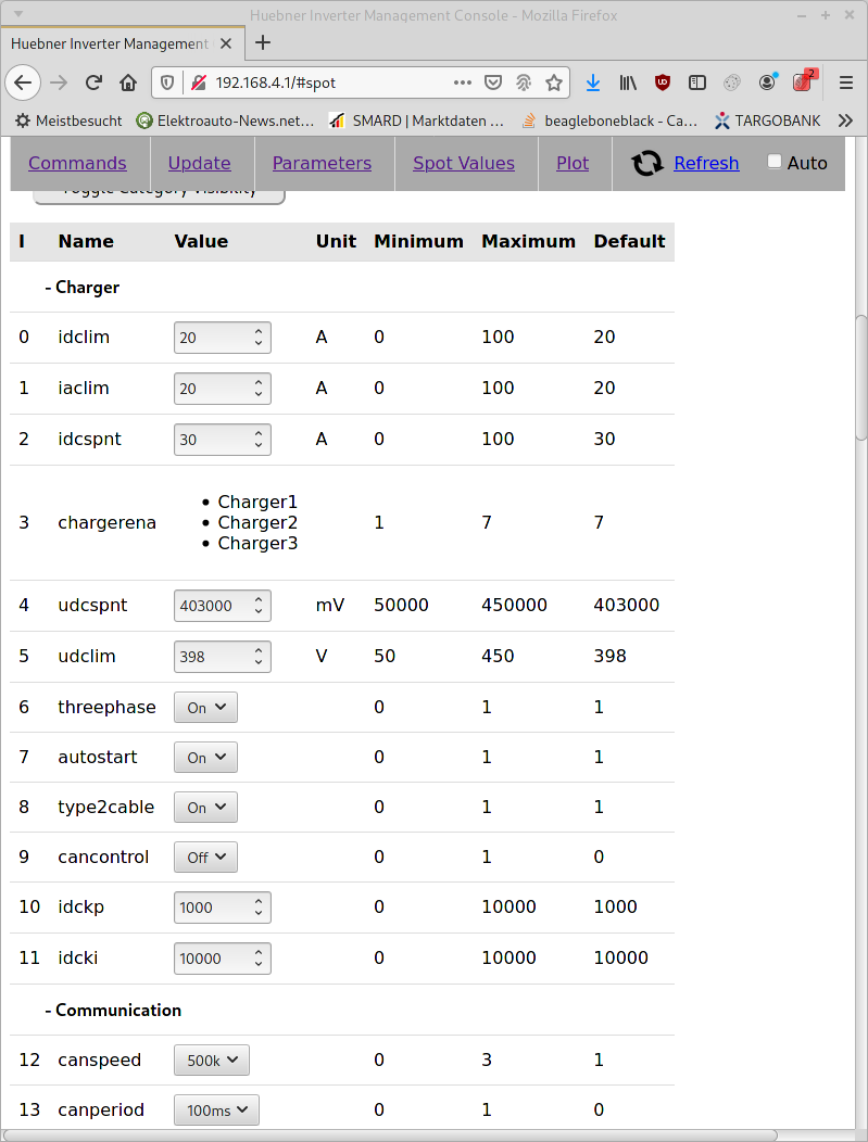

More specifically it features
  • All features of the original firmware
  • openinverter parameter handling via web interface
  • openinverter spot value handling via web interface
  • Over The Air update via bin file
  • Plotting and logging
  • DC current set point
  • external CAN control

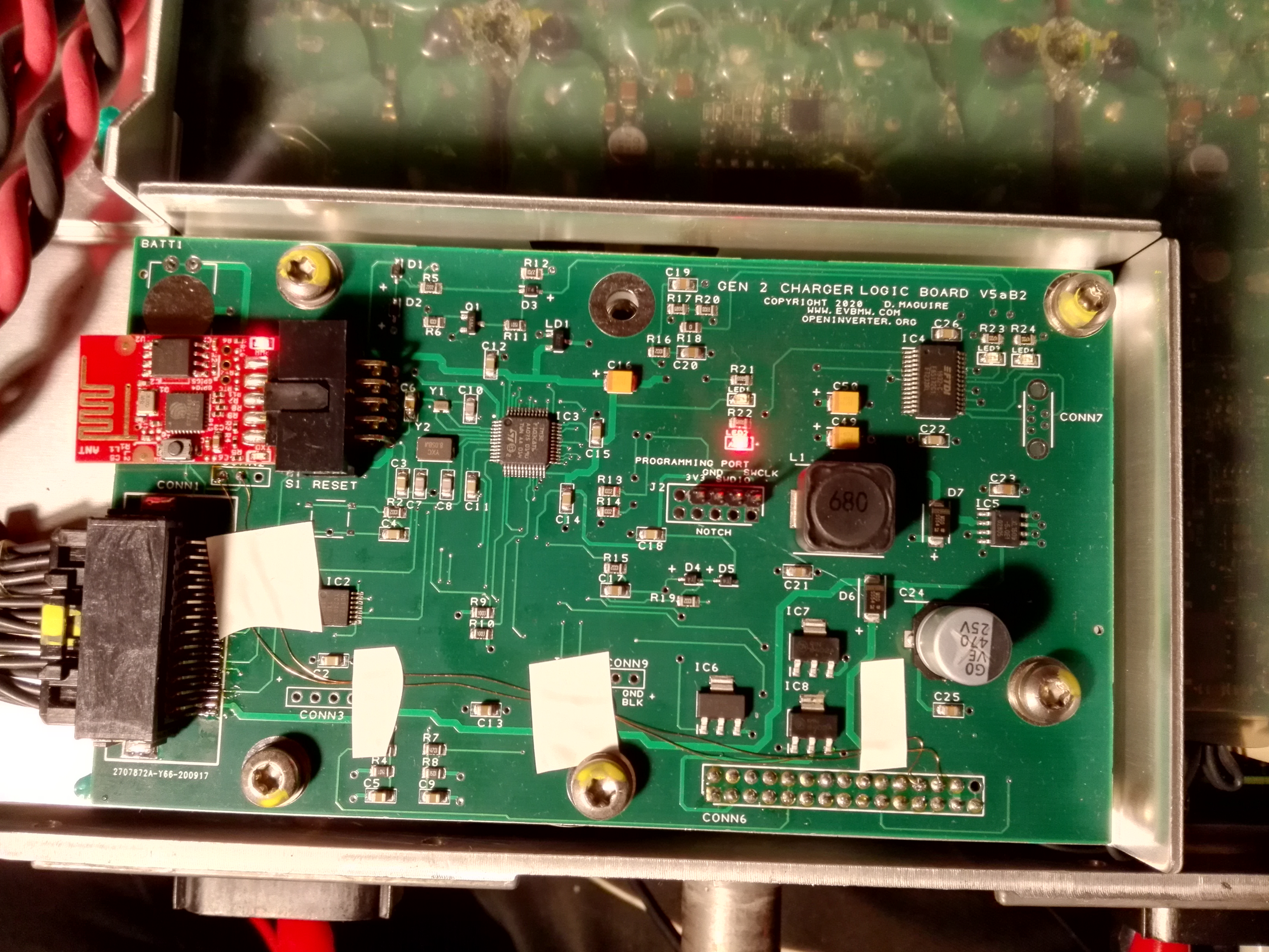

External CAN control requires routing to internal CAN bus onto the external header as shown on the picture. It has quite a few IDs on it so check for collisions with your existing CAN infrastructure before doing this.
