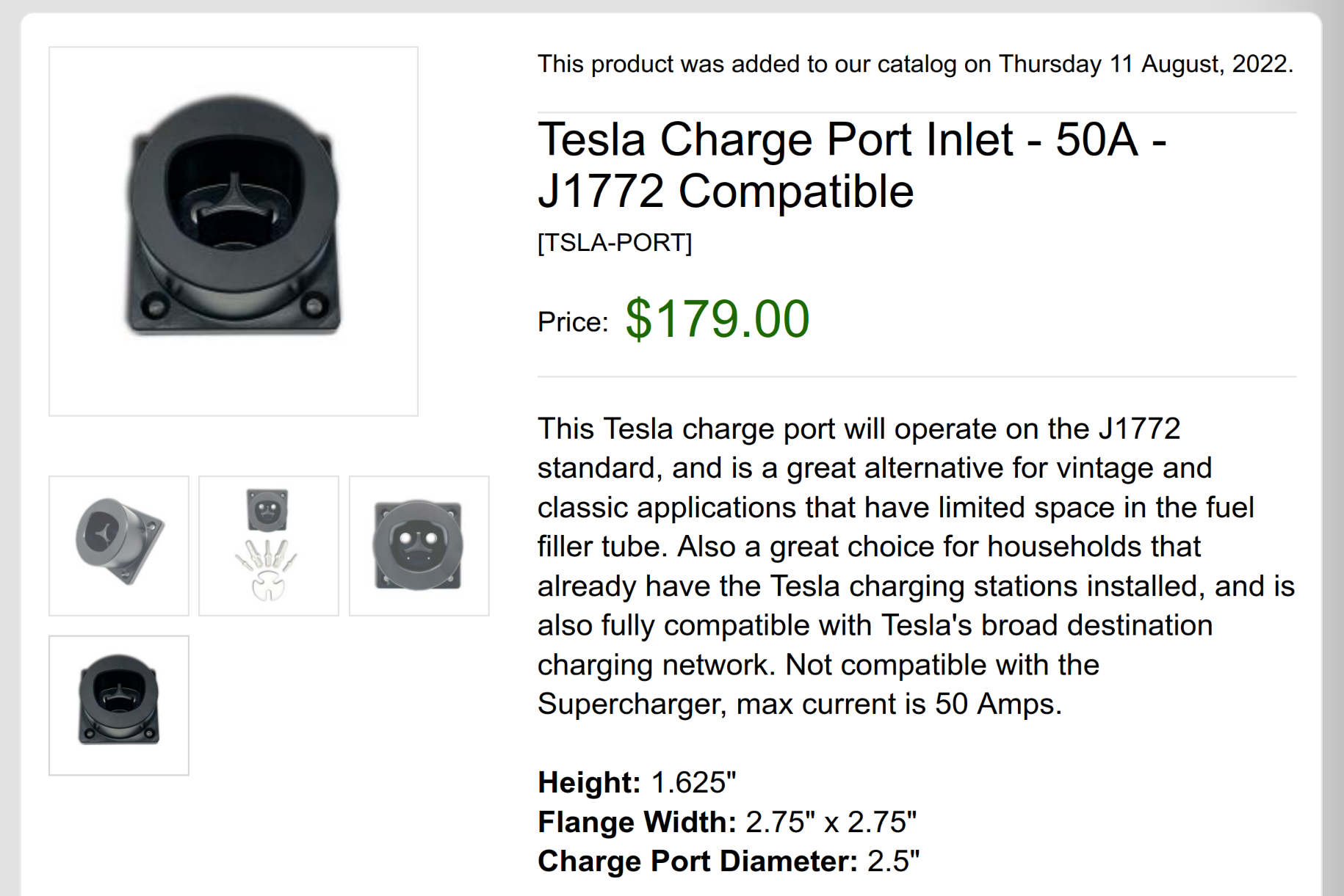

For a while there was considerable effort being made to adapt the Model 3 inlet port and controller for DCFC:
viewtopic.php?t=1040
The landscape has changed, we have other CCS add-on options, but now in the US NACS is ascendant. If I wanted to install a NACS inlet, for purposes of DCFC, and use a non-Tesla controller for the CCS comms (BMW i3 LIM, AR7420, or QCA700x), what options are there for the physical port?
EVWest sells a NACS charge inlet:
Tesla Charge Port Inlet - 50A - J1772 Compatible
But it's limited to 50A, and offers no nozzle lock. For my purposes, I desire 125A and nozzle locking.
Are there NACS charge inlet options other than used Tesla bits?
