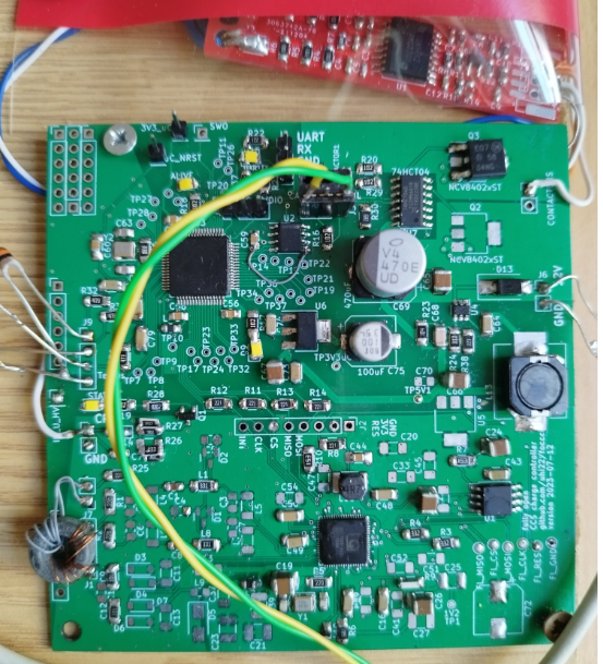

Very valuable inputs. I want to say a big "thank you".
I added the most important changes to the board ( https://github.com/uhi22/foccci#finished-todos ), and the others to the todo list ( https://github.com/uhi22/foccci#todos-for-later )
Regarding the contactor driver: Yes, non-inverting is better. Now using two inverters in series, and pull-down at the input. At the output no pulldown is needed, because when it is powered, it will drive actively, and if it is unpowered, the clamp diodes pull hold the outputs near to ground.
Also added pdf schematic.
This is how it looks now. More complex than initially thought. But yes, it's not only the QCA and STM. Also lot of power supply stuff, the contactor driver, CP logic, analog inputs, programming and debugging connectors, and a bunch of unconnected spare holes for extensions and workarounds.

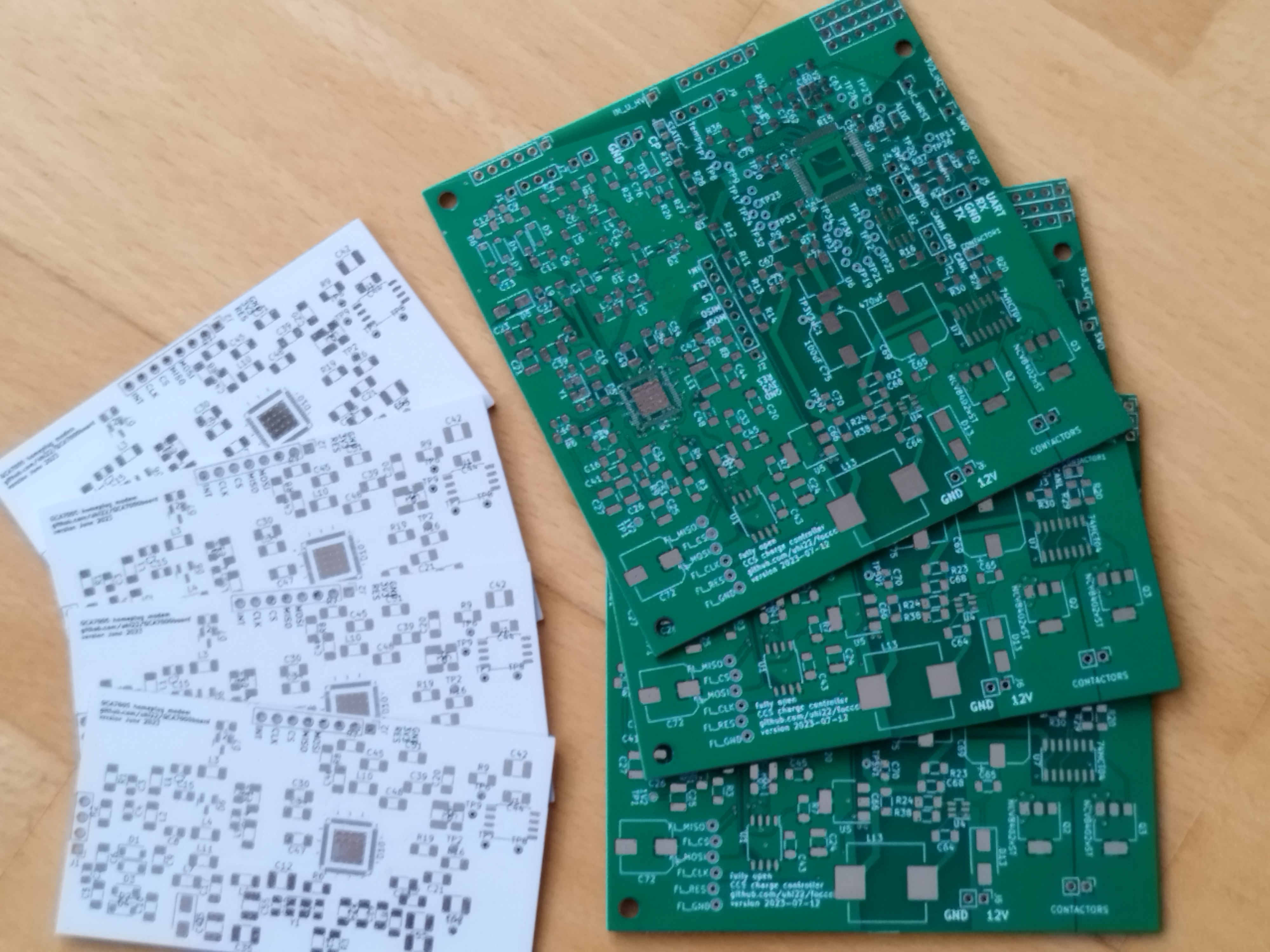

While the new board is travelling from Asia to Europe (btw: $4.54 for 5 boards from https://jlcpcb.com/, including all shipping, taxes and so on), prepared some software which runs on an STM32F303 NUCLEO board. It is based on the ESP32-with-arduino-variant https://github.com/uhi22/ccs32berta, and the major task was to kick-out the Arduino specific things. Now it is pure C code, and the controller-dependencies are concentrated in a single file, main.c, which is anyway generated by the CubeIDE. So further porting to other platforms should be easy now. Here it is: https://github.com/uhi22/ccs32clara

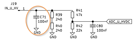

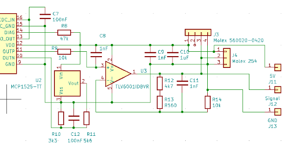

Regarding the HV sensing board from @muehlpower (thanks for providing a sample): Just realized, that the board has a voltage output, not a current output. Found this in the LIM thread:
Together with the proposed opposite in the foccci
I see the risk that the amplifier is not happy with the high capacitive load. I did not study the data sheet, but from my experience capacitive loads on operational amplifiers could cause instabilities. I would tend to NOT populate the C71.
And an other question: The series of 240 + 240 ohm is 480 ohms. Is this the original circuit of the LIM? Or is 470 (with some tolerances) used?
- muehlpower
- Posts: 807
- Been thanked: 186 times
Re: Develop a QCA7000 board?
The 4 resistors are in the LIM, there are also the two capacitors, but I don't know their value. With BMW and Lars' board, a current signal is transmitted, with me a voltage. As long as the total pull down resistance is 476.7 ohms, all boards should work. The input capacitor can also be small, since the second one effectively smoothes

I studied the data sheet 20 times, and see it in the same way: The SN65HVD234 needs the EN pin on high. I considered this in the current prototype, and populated the chip which has the correct '234 on the label. But: It does not output dominant levels on the CANH and CANL. It only loops-back the TX data on the RX data pin. If I just disconnect the EN pin, it works correctly. This is strange. The only explanantion which I have, that the cheap chinese source sold wrongly labeled chips, which are in fact not the original SN65HVD234.
Progress: The STM32F103 is running on the board version 2023-07-13, flashing the software works, the serial line, the LEDs and finally also the CAN. Next actions will be to populate the QCA and run more tests. The only findings so far are too small footprints for some bigger capacitors, and a lot of unreadable silk screen texts due to collision with components or solder mask. Overall a good progress.

The combined board with STM32F103 and QCA starts talking CCS
https://github.com/uhi22/foccci#2023-07 ... op-reached

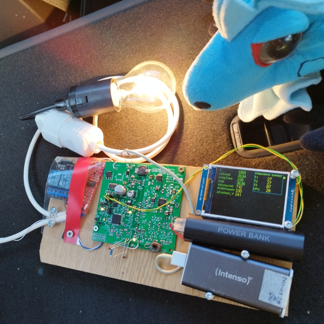

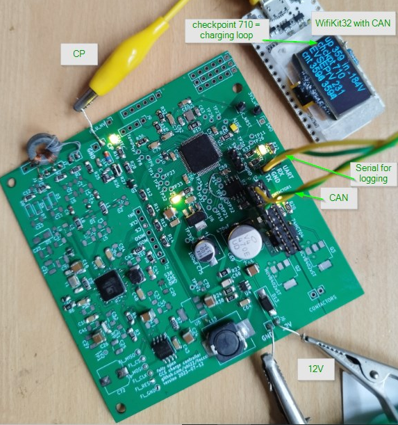

First bulb-demo-charging on Alpitronic worked at the first attempt. The red board is the voltage sense board from @muehlpower. The display gets some status data via CAN.
Some key facts:
* Board: The Foccci from July (https://github.com/uhi22/foccci)
* QCA7005 modem chip. The protection and filtering circuit in the RF path have not been populated so far. Also not all C's on the supply rails have been populated.
* Only one Contactor driver populated (not the planned one, just a n-channel-power-MOSFET for testing).
* CAN running with 500kBaud
* Display project: TFT driven by a STM32 "bluepill", gets status data via CAN. https://github.com/uhi22/TFT-with-CAN and powered by a separate 5V USB power bank.
* Contactors: Cheap chinese relays with 5V coil (just for testing).
* High-voltage sensing: The muehlpower board.
* Controller: STM32F103RE
* Software: The Clara (https://github.com/uhi22/ccs32clara), developed in the STM CubeIDE. Includes the exi decoder/encoder for DIN schema, copied from https://github.com/Martin-P/OpenV2G.
* Powered by 5V USB power bank. This is not ideal. The 3.3V are fine, but the muehlpower board would need 5V, and gets only 4.3V.
* RF transformer: RIK10 from https://www.reichelt.de/ringkern-aus-fe ... search=RIK
* Temperature sensors: Two channels with real NTCs (10k, VISHAY NTCLE100E3, https://www.reichelt.de/index.html?ACTI ... NG_TDS.pdf). Third temperature channel connected to a fix 1k resistor (just for testing).
* Power supply: Only one 3.3V linear regulator populated, which drives both, the STM32 and the QCA.

Since the JLCPCB has a minimum quantity of five, and the boards are working better than expected, I could provide it if somebody is interested. Could also bundle it with QCA, controller and SPI-FLASH. (I do not plan to create a shop, just offering the few leftover parts.)

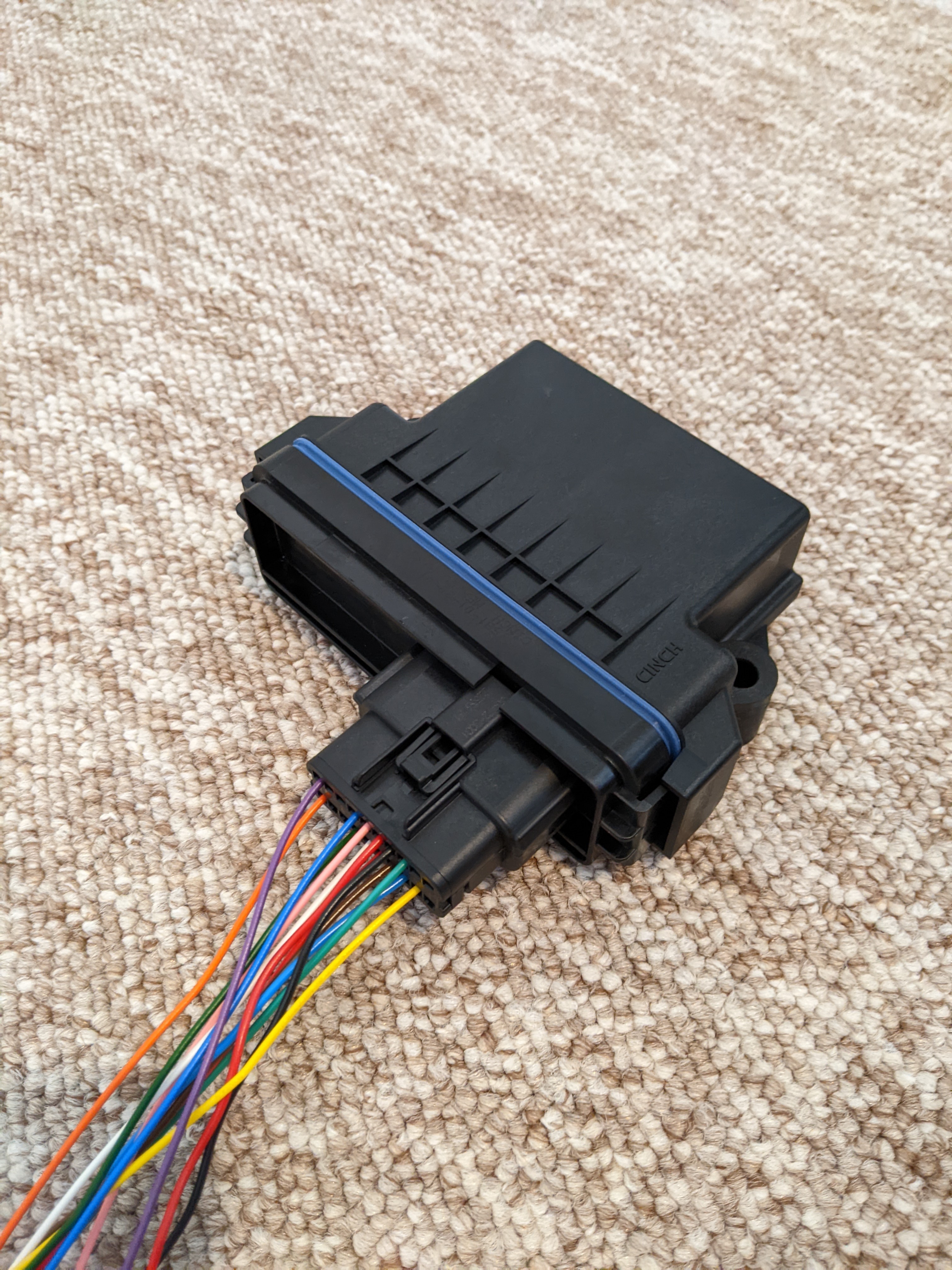

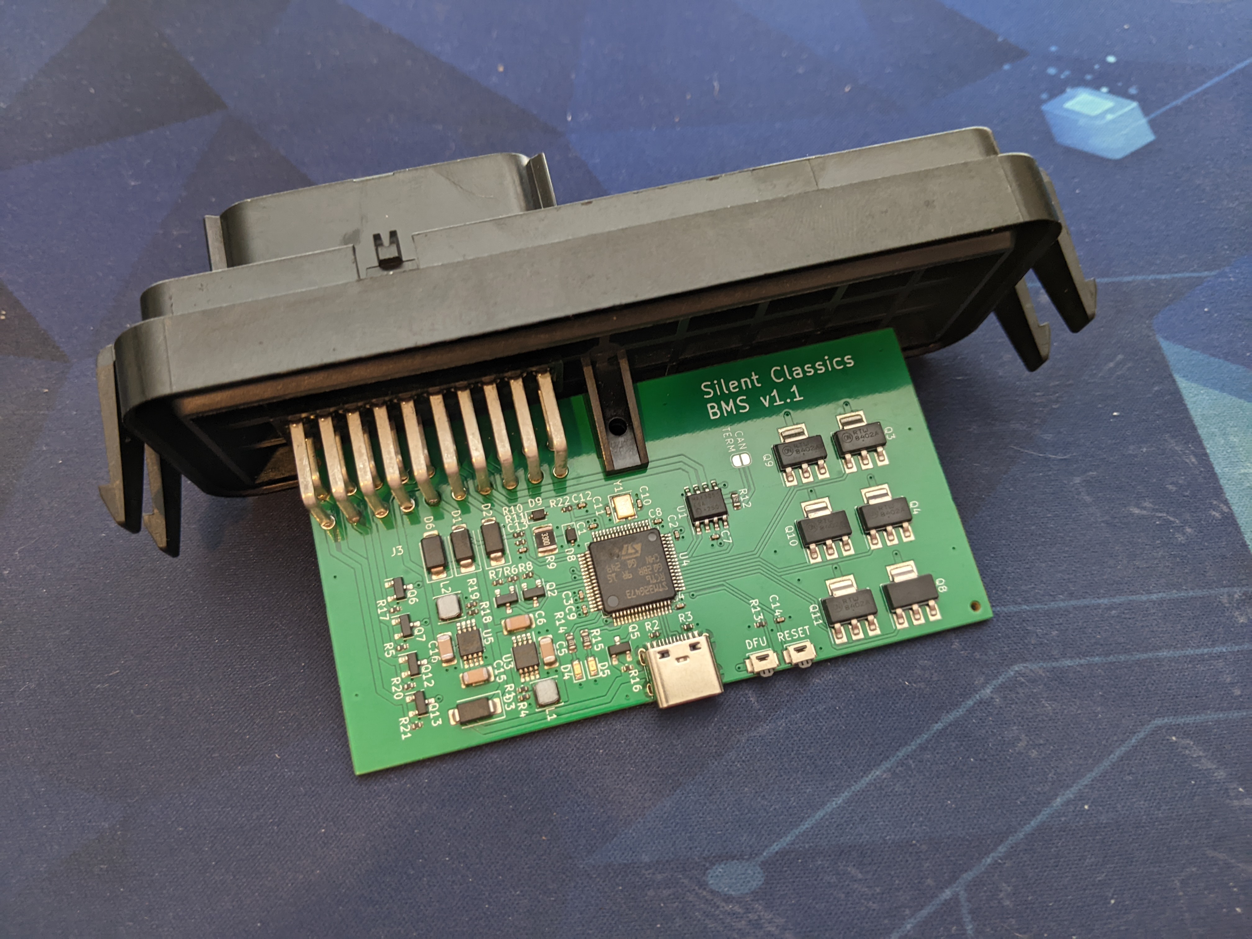

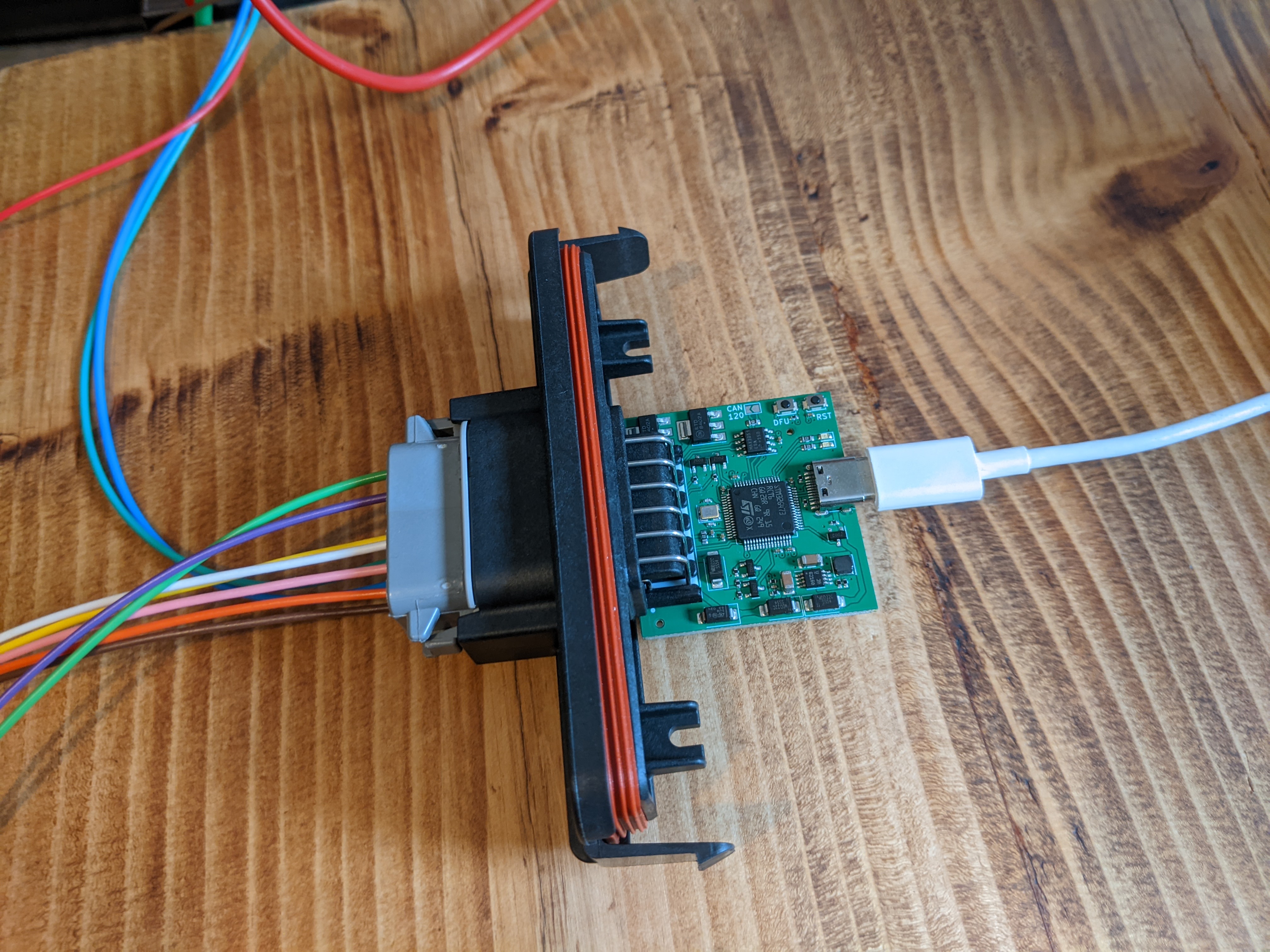

I spent a decent amount of time researching housings recently. I'm a big fan of the following options, depending on how many sockets / pins you need:
DTM13-12PA-R008 - 12 pins
DTM13-12PA-12PB-R008 - 2 x 12 pins
5810120011 - 20 pins
These all offer a robust connector and easily mountable waterproof housing and in my opinion are well worth the cost. I personally prefer the Deutsch connectors, assuming 12 or 2x12 connectors is suitable.
