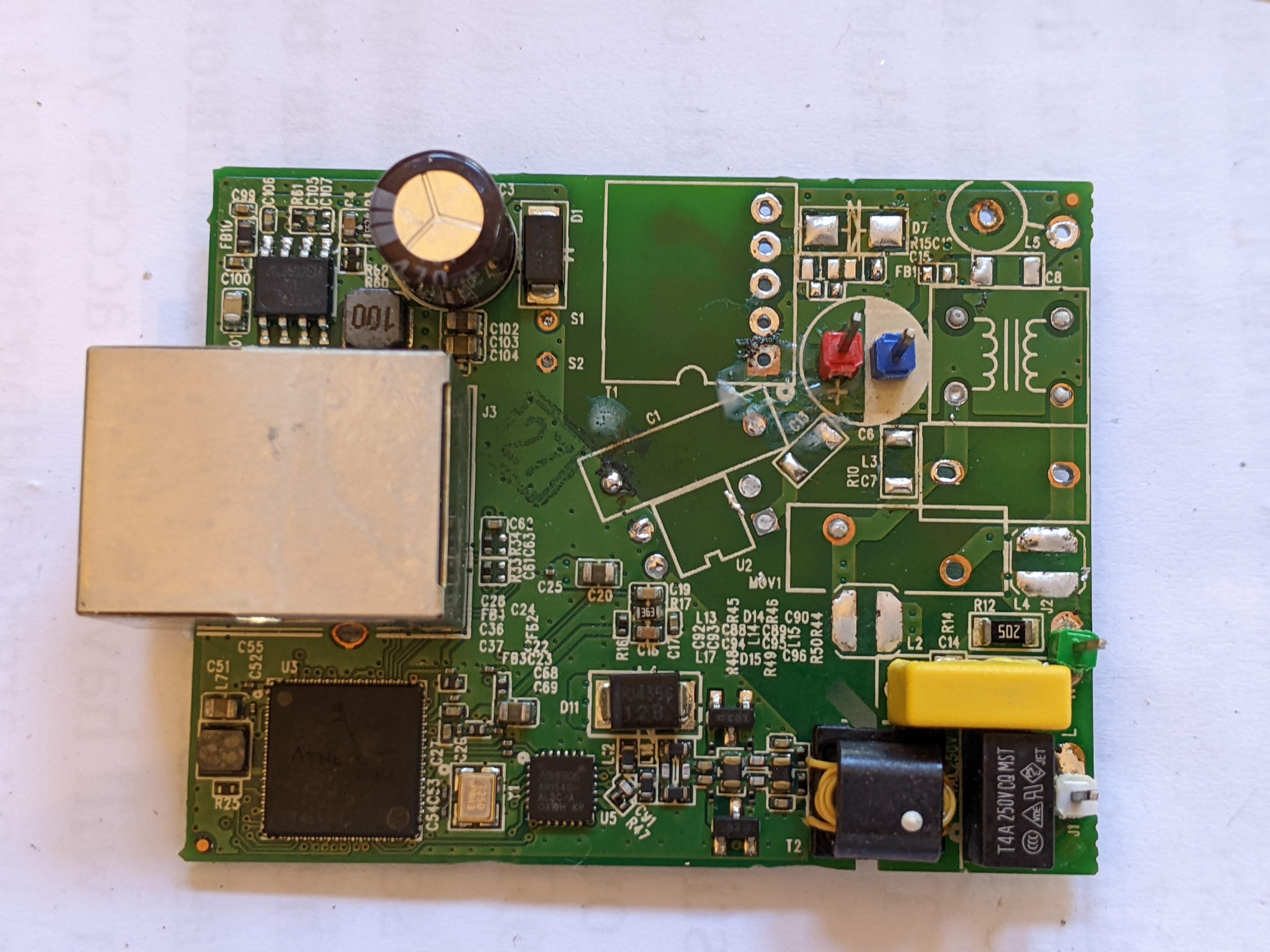

I found this article, which shows how to easily modify a TL-PA4010 to remove its AC power supply, power it from 12v, and wire its data lines to DC: http://www.helicopting.de/
I've ordered a couple of these, which I will modify accordingly. This will allow me to verify communication with a CCS charger. I have also ordered a powerline adapter with a QCA7500, to see if this chip supports the EVSE side.

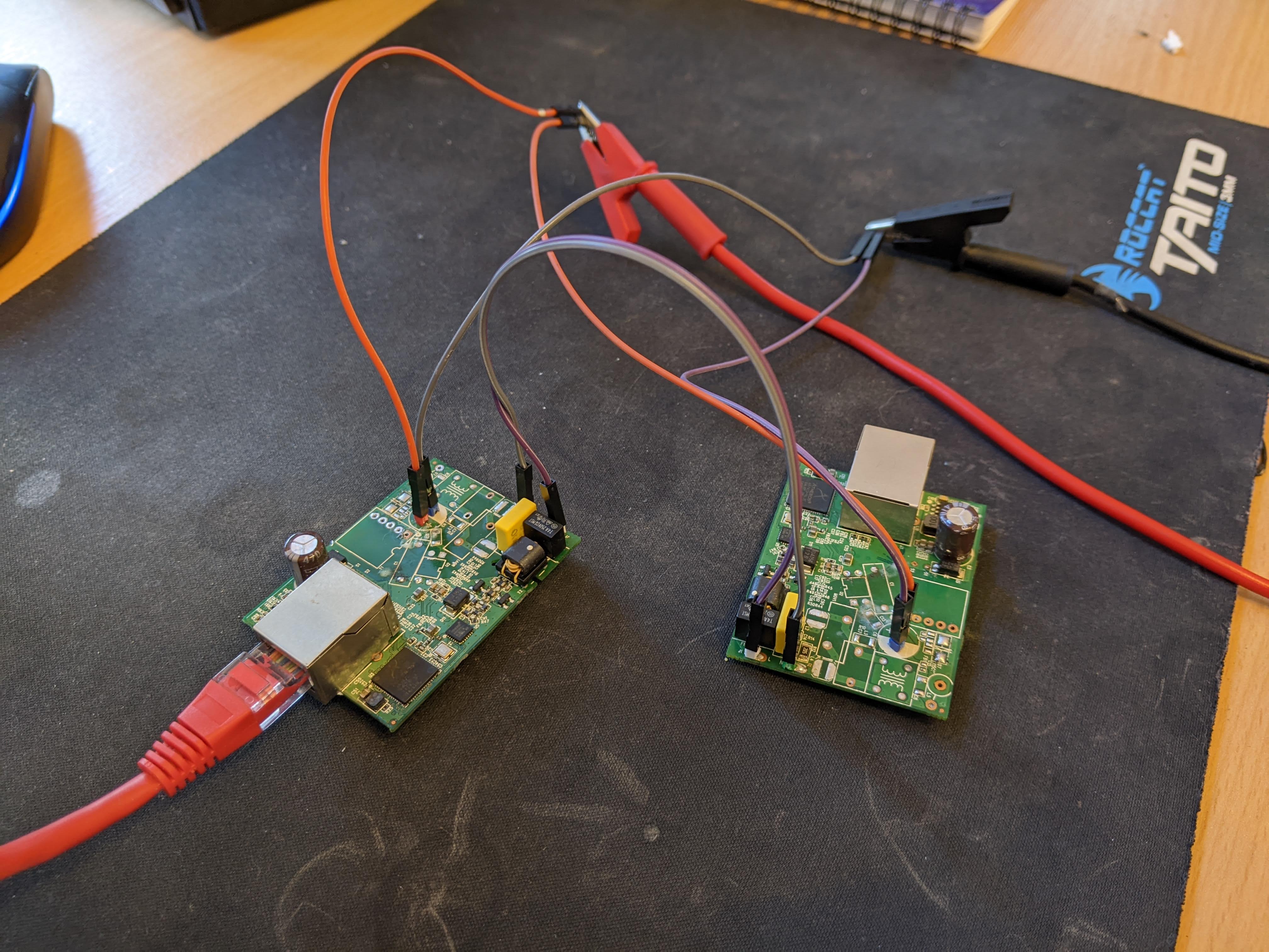

I've now modified a TP-Link TL-PA4010. The device now runs on DC, and the data lines are exposed directly. This modification appears to work, and should now be ready to hook up the the CP and PE lines of a charger.

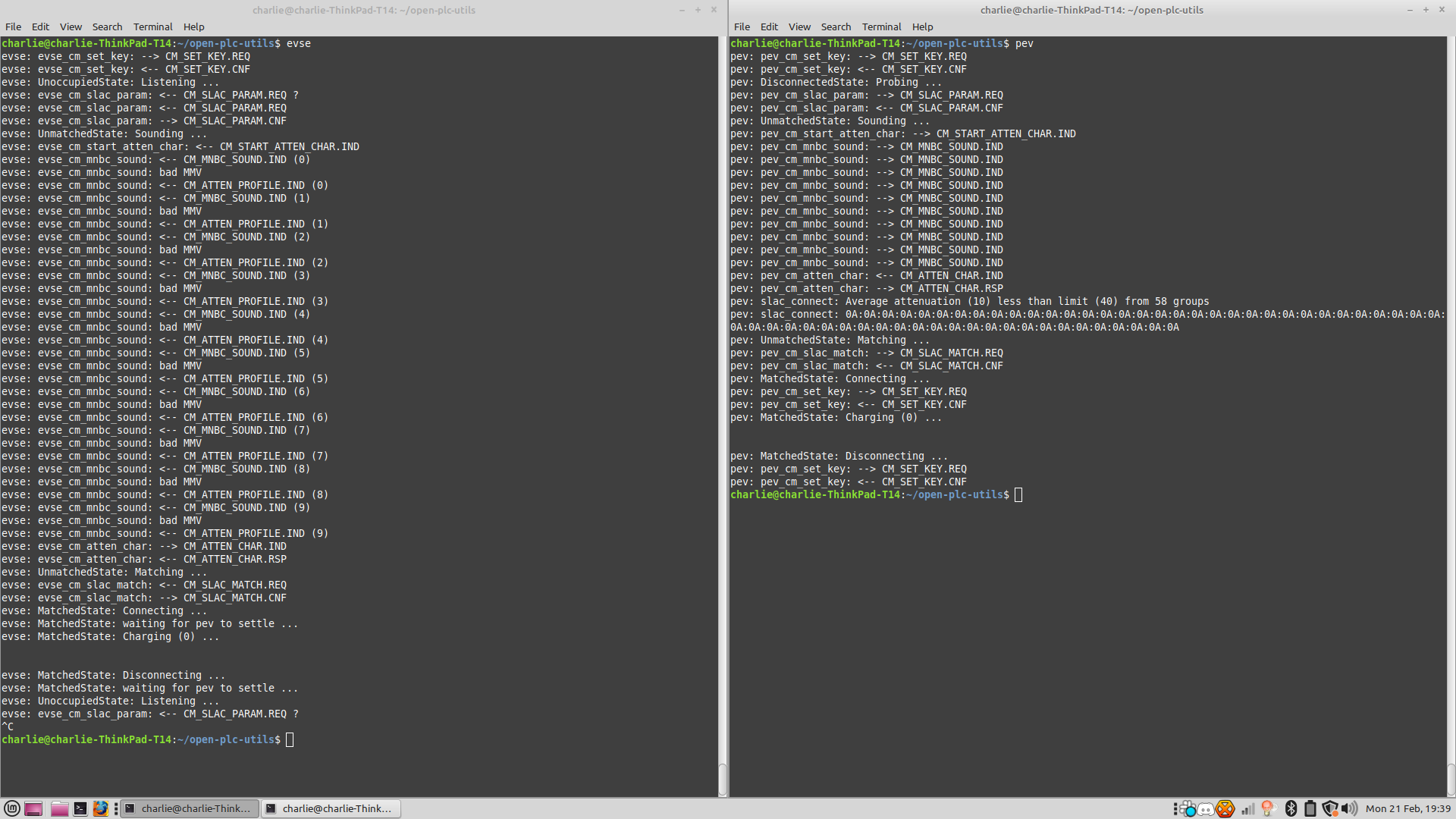

I've tested using two of these boards - one simulating the EVSE and one simulating the EV. The AR7420 does not appear to be capable of signal attenuation measurement, so I've had to fake the signal levels on the EVSE side, but this isn't a problem for this project. SLAC negotiation completes successfully and a network is formed. Definitely need to try this against a real EVSE before diving into the higher layer protocols.

Here's a verbose example of my successful run, including the firmware version I'm using:
charlie@charlie-ThinkPad-T14:~/open-plc-utils/slac$ pev -i enp0s31f6 -d
pev: slac_session: session.RunID 54:05:DB:40:48:C6:00:00
pev: slac_session: session.APPLICATION_TYPE 0
pev: slac_session: session.SECURITY_TYPE 0
pev: slac_session: session.RESP_TYPE 0
pev: slac_session: session.NUM_SOUNDS 0
pev: slac_session: session.TIME_OUT 0
pev: slac_session: session.NumGroups 0
pev: slac_session: session.AAG 00:00:00:00:00:00:00:00:00:00:00:00:00:00:00:00:00:00:00:00:00:00:00:00:00:00:00:00:00:00:00:00:00:00:00:00:00:00:00:00:00:00:00:00:00:00:00:00:00:00:00:00:00:00:00:00:00:00
pev: slac_session: session.MSOUND_TARGET 00:00:00:00:00:00
pev: slac_session: session.FORWARDING_STA 00:00:00:00:00:00
pev: slac_session: session.PEV_ID AA:AA:AA:AA:AA:AA:AA:AA:AA:AA:AA:AA:AA:AA:AA:AA:AA
pev: slac_session: session.PEV_MAC 54:05:DB:40:48:C6
pev: slac_session: session.EVSE_ID 00:00:00:00:00:00:00:00:00:00:00:00:00:00:00:00:00
pev: slac_session: session.EVSE_MAC 00:00:00:00:00:00
pev: slac_session: session.RND 00:00:00:00:00:00:00:00:00:00:00:00:00:00:00:00:00
pev: slac_session: session.NMK 3F:94:65:6F:A8:20:42:42:A0:90:26:C7:93:9F:1F:C5
pev: slac_session: session.NID 44:EB:DC:73:F9:76:0B
pev: slac_session: session.original_nmk 3F:94:65:6F:A8:20:42:42:A0:90:26:C7:93:9F:1F:C5
pev: slac_session: session.original_nid 44:EB:DC:73:F9:76:0B
pev: slac_session: session.state 1
pev: slac_session: session.sounds 0
pev: slac_session: session.limit 40
pev: slac_session: session.pause 20
pev: slac_session: session.chargetime 3600
pev: slac_session: session.settletime 10
pev: slac_session: session.counter 0
pev: slac_session: session.flags 0x0006
pev: pev_cm_set_key: --> CM_SET_KEY.REQ
pev: pev_cm_set_key: CM_SET_KEY.KEYTYPE 1
pev: pev_cm_set_key: CM_SET_KEY.MYNOUNCE AA:AA:AA:AA
pev: pev_cm_set_key: CM_SET_KEY.YOURNOUNCE 00:00:00:00
pev: pev_cm_set_key: CM_SET_KEY.PID 4
pev: pev_cm_set_key: CM_SET_KEY.PRN 0
pev: pev_cm_set_key: CM_SET_KEY.PMN 0
pev: pev_cm_set_key: CM_SET_KEY.CCoCAP 0
pev: pev_cm_set_key: CM_SET_KEY.NID 44:EB:DC:73:F9:76:0B
pev: pev_cm_set_key: CM_SET_KEY.NEWEKS 1
pev: pev_cm_set_key: CM_SET_KEY.NEWKEY 3F:94:65:6F:A8:20:42:42:A0:90:26:C7:93:9F:1F:C5
pev: pev_cm_set_key: <-- CM_SET_KEY.CNF
pev: pev_cm_set_key: CM_SET_KEY.RESULT 1
pev: pev_cm_set_key: CM_SET_KEY.MYNOUNCE 15:ED:B4:D2
pev: pev_cm_set_key: CM_SET_KEY.YOURNOUNCE AA:AA:AA:AA
pev: pev_cm_set_key: CM_SET_KEY.PMN 255
pev: DisconnectedState: Probing ...
pev: pev_cm_slac_param: --> CM_SLAC_PARAM.REQ
pev: pev_cm_slac_param: <-- CM_SLAC_PARAM.CNF ?
^C
charlie@charlie-ThinkPad-T14:~/open-plc-utils/slac$ plctool -aI -ienp0s31f6
enp0s31f6 00:B0:52:00:00:01 Fetch Device Attributes
enp0s31f6 14:CC:20:4D:B7:C3 QCA7420-MAC-QCA7420-1.5.0.26-02-20200114-CS (1mb)
	PIB 0-0 8836 bytes
	MAC 14:CC:20:4D:B7:C3
	DAK 91:F1:F8:7C:DD:DC:47:06:59:C1:64:BF:53:19:94:36
	Security level 0
	NET Qualcomm Atheros Enabled Network
	MFG tpver_401013_171025_901
	USR PEV
	CCo Never
	MDU N/A
If you can't make this work, there's also the Qualcomm proprietary SET_KEY message which will probably work instead. You can capture it using this command.
plctool -ienp0s31f6 -K50:D3:E4:93:3F:85:5B:70:40:78:4D:F8:15:AA:8D:B9 -M
I'm going to get this plugged into a real CCS charger tomorrow to see what happens. Will attempt to establish a layer2 link as above, and if successful, then send this small UDP message which should cause the charger to reply with its own address.

I was able to initiate a SLAC negotiation with the charger, fetch the network key, and apply it to my AR7420. I was then able to send a muticast UDP discovery packet to the charger and received an appropriate discovery protocol response, so the connection is definitely established.
Full PCAP of my testing session is attached!
ccs1.pcapng.zip
(6.15 KiB) Downloaded 1063 times

Wow, that is truly exciting! We really need a full open source implementation of CCS that lets everyone play with it until it works with all chargers. Had some bad experience with a Chinese car (video coming) that only worked on every other charger and would have loved to break out my laptop and fix it :)
What brand charger did you try?

FYI in your PCAP the CM_MNBC_SOUND.IND messages (soundings) appear to be malformed. It appears you are not sending the “random number” portion, bytes 55 - 63 are zero and bytes 64-70 are missing. The station in this case does just fine but don’t know if others will accept this.
You’re also supposed to send CM_START_ATTEN_CHAR.IND three times, you’re sending it once. I think stations are likely to be more tolerant on this.

CCSknowitall wrote: Sat May 21, 2022 11:58 am Cool stuff!
You don’t happen to have an ABB charger locally, do you? If you can get to SDP on one of them, you should be mostly fine with everything else. You don’t even need an account as those stations will try to establish vehicle communications immediately upon plugin. You’ll need the correct resistance between CP and PE of course.
Thank you for taking the time to go through my pcap in such detail! The current implementation is Qualcomm's open source example, so I will go through the points you raised, compare with the CCS spec and ensure I do it correctly.

This project looks promising. I've ordered my own set of TL-PA4010's, see if I can replicate your progress.

stracky wrote: Tue May 24, 2022 7:34 pm This project looks promising. I've ordered my own set of TL-PA4010's, see if I can replicate your progress.
Fantastic. There's a guide here to modifying them which shows a version slightly different to mine. http://www.helicopting.de/
My progress is pretty minimal so far. The next step is to learn EXI, which is required to encode requests.
