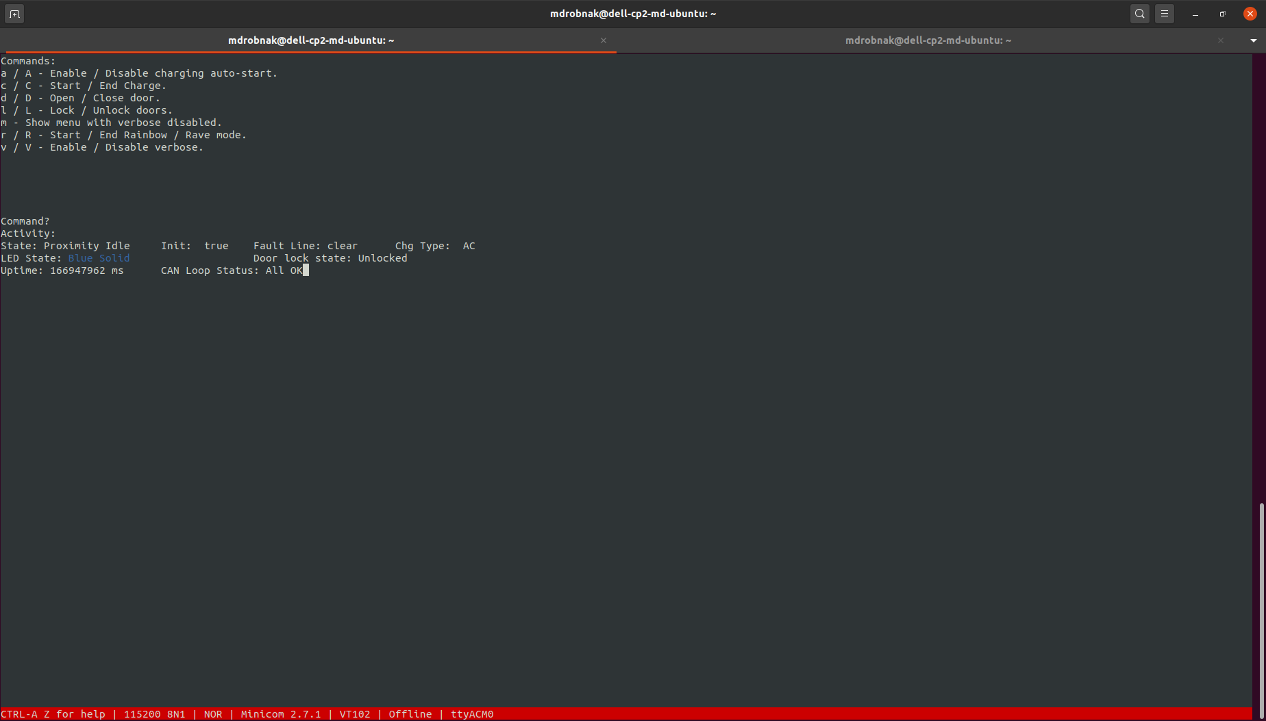

Moved software to use RTIC which is a scheduling framework in Rust. Working well, no more timeouts, and consistent timings. CAN driver timeout optimized to not give false alerts. Verified it wasn't just driver by going back to old code with new settings, still had timeout issues. Migrating to RTIC was the right thing to do.

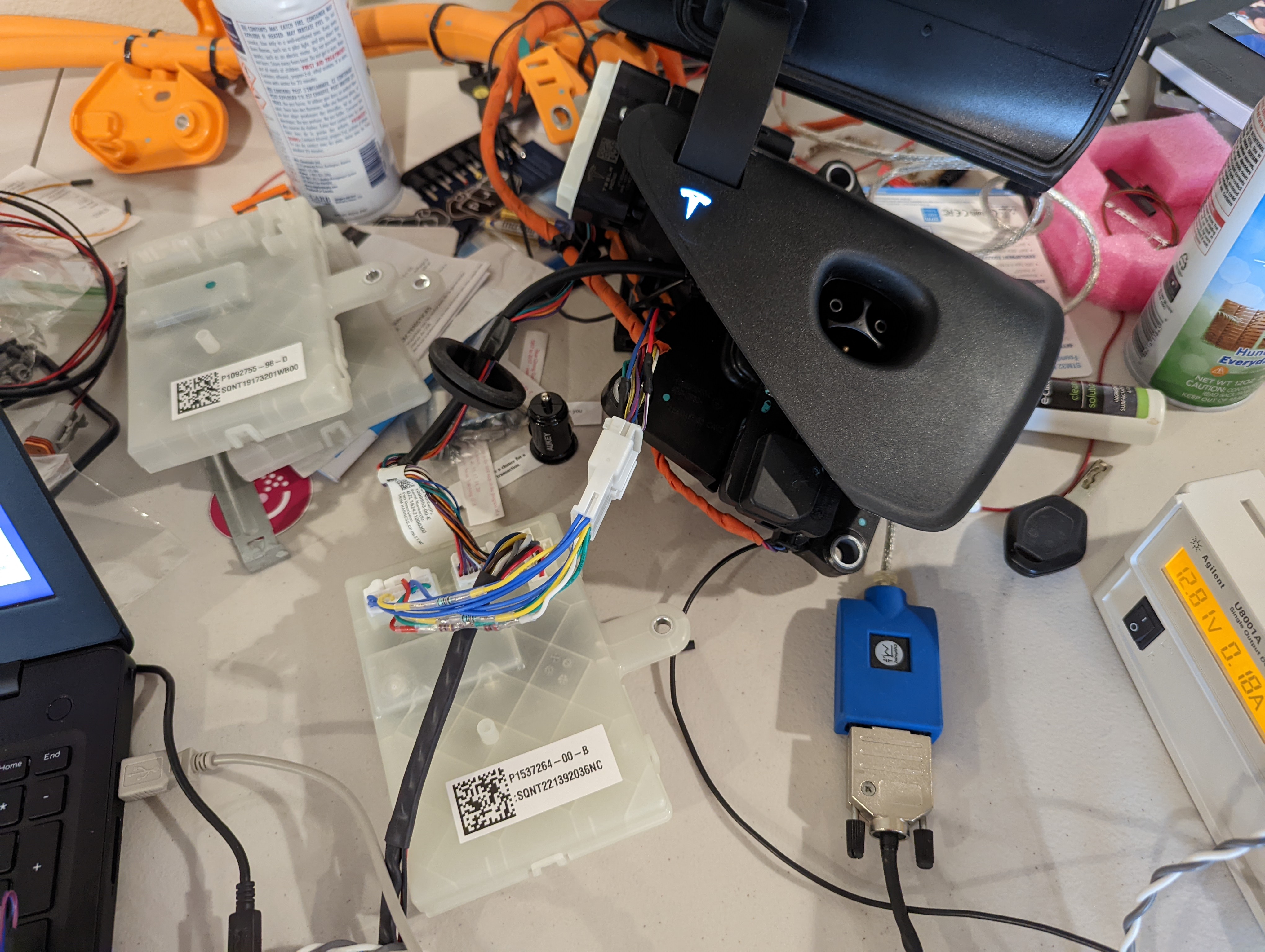

Did some initial CHAdeMO adapter tests. With 'baseline' firmware, it works to the point of where it will stay in standby. I don't have the proper setup created to test further yet. Older firmware US reports unsupported EVSE. Therefore it is recommended to get a unit from a 2019+ car (noted above now).
State of the World as of 2020-11-23:
Fault line reading still ignored. However, latch voltage control and CAN messages are sync'd, fixing an error. Older firmware US, and EU now working. Newer firmware works, but requires non-backwards-compatible changes to enable. Older messages don't break medium term firmware, but do break new firmware. Need to add configuration items to enable modified messages. Working on getting app CRC to match to a list of known values to switch to the new style.
State of the World as of 2020-11-16:
Latch control is working, fault line reading is implemented but currently ignored. Initialization takes a few seconds but is consistent and works. As a result of stability, the touch sensor (inductive door sensor) is working as expected now. Unfortunately no additional ECU support as of yet, working on EU support.
State of the World as of 2020-10-21:
Charging auto-start works now. Latch control being tested and fault line reading implemented. Created a utilities module with a common checksum routine. Fixed issue in said routine. Renamed some variables to be better (like hv_can instead of control_can). Disallowed any warnings in all files. Released redacted version of code on github.

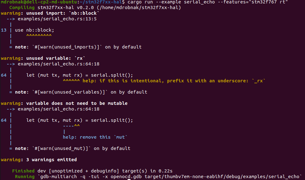

First draft of code written in Rust. Running on STM32F7 processor. Code is in similar state to 2020-09-25, as there have been no major logic changes yet, only porting of the code. Serial console improved with last 4 activity items with uptime timestamp, not just the most recent. Code has no warnings, and only 1 unsafe block that is used during initialization to turn on the TIM2 timer interrupt. Plenty of room for refactoring and optimization, but manual charge does work as expected.
State of the World as of 2020-09-25:
Code is written in C++, using little C++isms except for sed 's/struct/class' for the most part, and using the OO-wrapper on the FlexCAN library from Collin Kidder. Code is being built in Sloeber for Teensy 3.2 (SimpBMS board), which is Eclipse + 'magic' to make Arduino stuff work...but I can make it build via Makefile too. No .ino files (that is what the Sloeber magic part is for, handling .ino files), but still making use of the Arduino core library functions such as Serial.write().
Init code for CP ECU is weak. It definitely gets upset in certain situations. Having the door open makes it happy. :: shrug ::

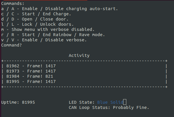

State machine for Insert cable -> start charge not there yet. Insert cable -> idle -> start charge via serial command is working.
Serial console code is OK but too scattered. I should be able to rewrite things to pass in the needed data to the console.
Code will be rewritten in Rust for the STM32. The opinionated nature of the language, plus memory safety items, plus speed, leads me down this path.

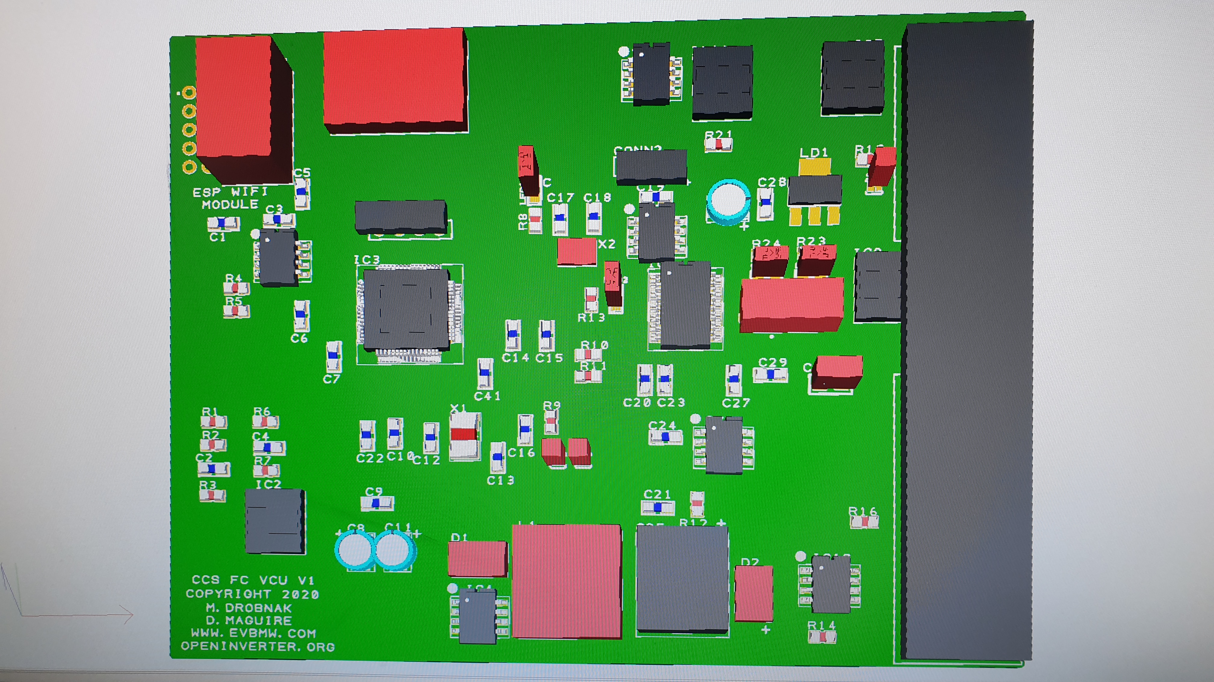

I'll rough out a hardware design soon. STM32F105 ok ? It has two can controllers. I'd like to dedicate one to the CP ecu and one for external services.

Hmm. Given the Teensy 3.2 is a Cortex M4, maybe? I wish there was the embedded equivalent of "top" to see the utilization of the processor. But assuming the CAN stuff is up to snuff, that should be sufficient, yes. We're averaging 650 messages/sec across the different timeframes.
There are three pins of note from the CP ECU:
Latch - Needs to be fed 5V. Unclear if it's always 5V. One of my tests on my car says no, but I need to redo that test perhaps.
Fault - Useful information perhaps?
Proximity - Not sure what to do with this yet, I'm not currently using it.
At some point the ECU does go into 'sleep' mode. So I assume with your choice you're looking for a lower powered CPU as in theory it'll be always connected like the SimpBMS et al, as you may want to charge the car at any given time...
Edit: On a related note, I have my development environment set up on Ubuntu 20.04, and thankfully Crossover runs the almost-latest version of Vehicle Spy, so I can at least do my analysis in there without having to reboot into Windows. I like SavvyCAN, but the UI is hard for me, and one of the really nice features of Vehicle Spy is highlighting changed bytes between messages.

Ok so I'm roughing this out based on an STM32F405RGT6 64 pin part.
-Housed in 32 pin modice enclosure like all my vcu designs.
-2 x CAN. One for CP ECU one for external
-3 x low side drivers
-2 x push pull 12v drivers
-2 x 12v digital inputs
-2 x 5v analog inputs
-USB onboard
-JTAG via Tag connect header
-SWD via 2.54mm 4 pin header
-256k EEPROM
What am I missing ...

Most of that looks great.Jack Bauer wrote: ↑Mon Sep 28, 2020 9:48 am Ok so I'm roughing this out based on an STM32F405RGT6 64 pin part.
-USB onboard
-256k EEPROM
What am I missing ...![]()
256k EEPROM is more than enough. We could probably put a USB flashing program in that amount of space!
What is the logic level thresholds for the 12V digital inputs? On my Motec I'm used to being able to dictate thresholds, rising/falling, and hysteresis, so doing this by hand is...interesting.
My counts so far are:
The proximity signal is 12V. (Input from CP ECU)
Fault voltage is 4.X volts, but the SimpBMS pulls it down to like 1.6V, which I'm guessing the input is low impedance. (Input from CP ECU)
We need to be able to switch on/off or generate a 5Vish signal for the latch enable. (Output to CP ECU)
Charge Enable signal for whatever is controlling the actual charger (Output to other device)
For the DC Fast charge part, we need to control contactors. But for the US people, we need to control contactors for anything other than the simple "AC only" mode. (I guess I theory we could allow a DC only mode too, but that's all software.) So we'd need... 4 contactors for single phase AC or DC. We probably want to support both economized and non-economized ones. Can we simply low-side PWM @ 100% duty for economized ones? My assumption on the non-economized ones is to do 100% duty for a few seconds, then ramp down to a hold duty cycle.
Battery slot for RTC for scheduled charging, please.
So by my inexperienced thought process, I'd say we need one more low side driver for contactor number 4 and the battery slot. That's all I think we're missing at the moment.
It's nice to be doing what I went to school for - Computer Engineering instead of Systems Administration, but I'm definitely a little over my head due to lack of experience here - so feel free to tell me I'm an idiot where necessary.
-Matt

Sounds good to me. Schematic on the way:)

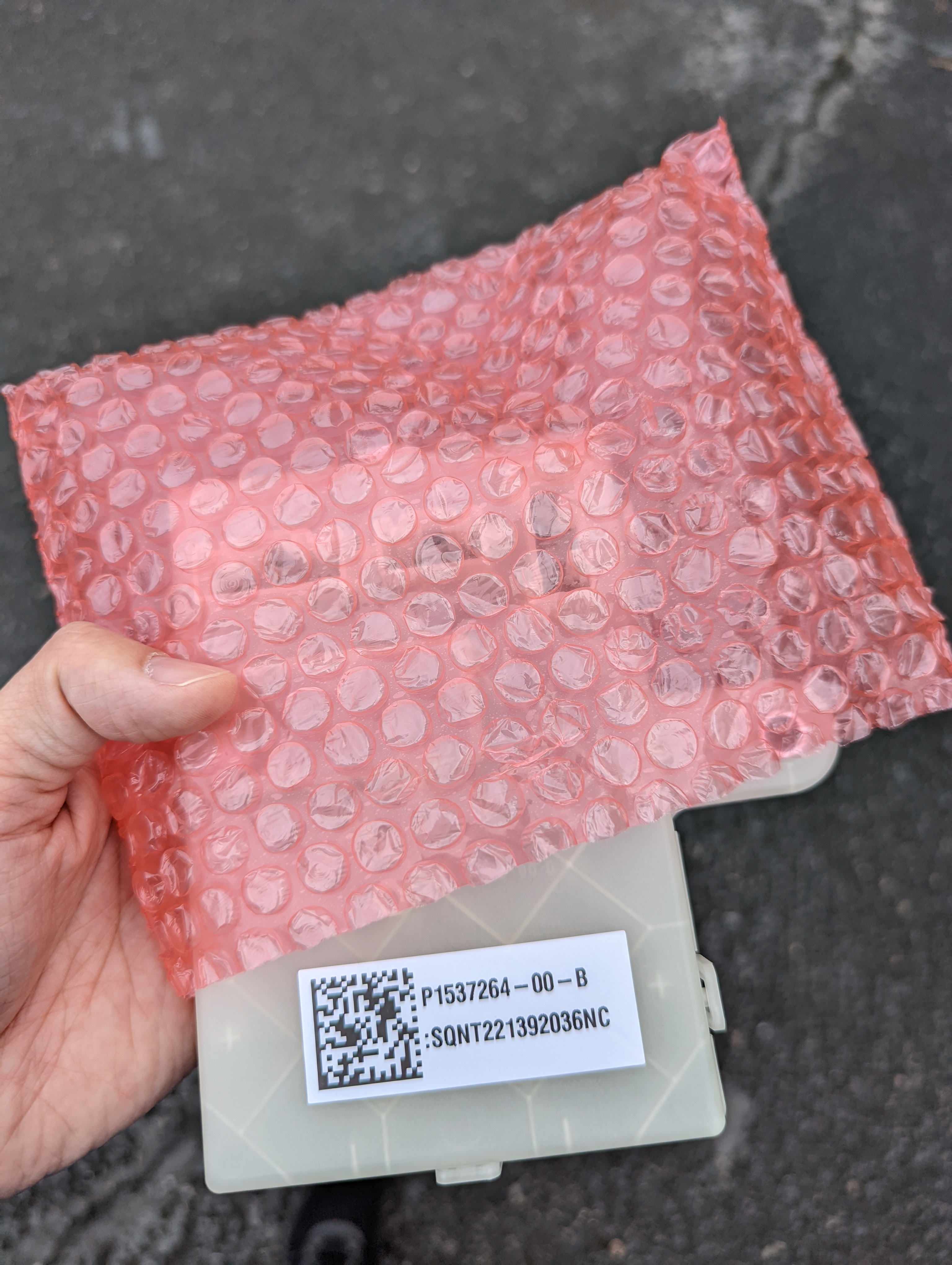

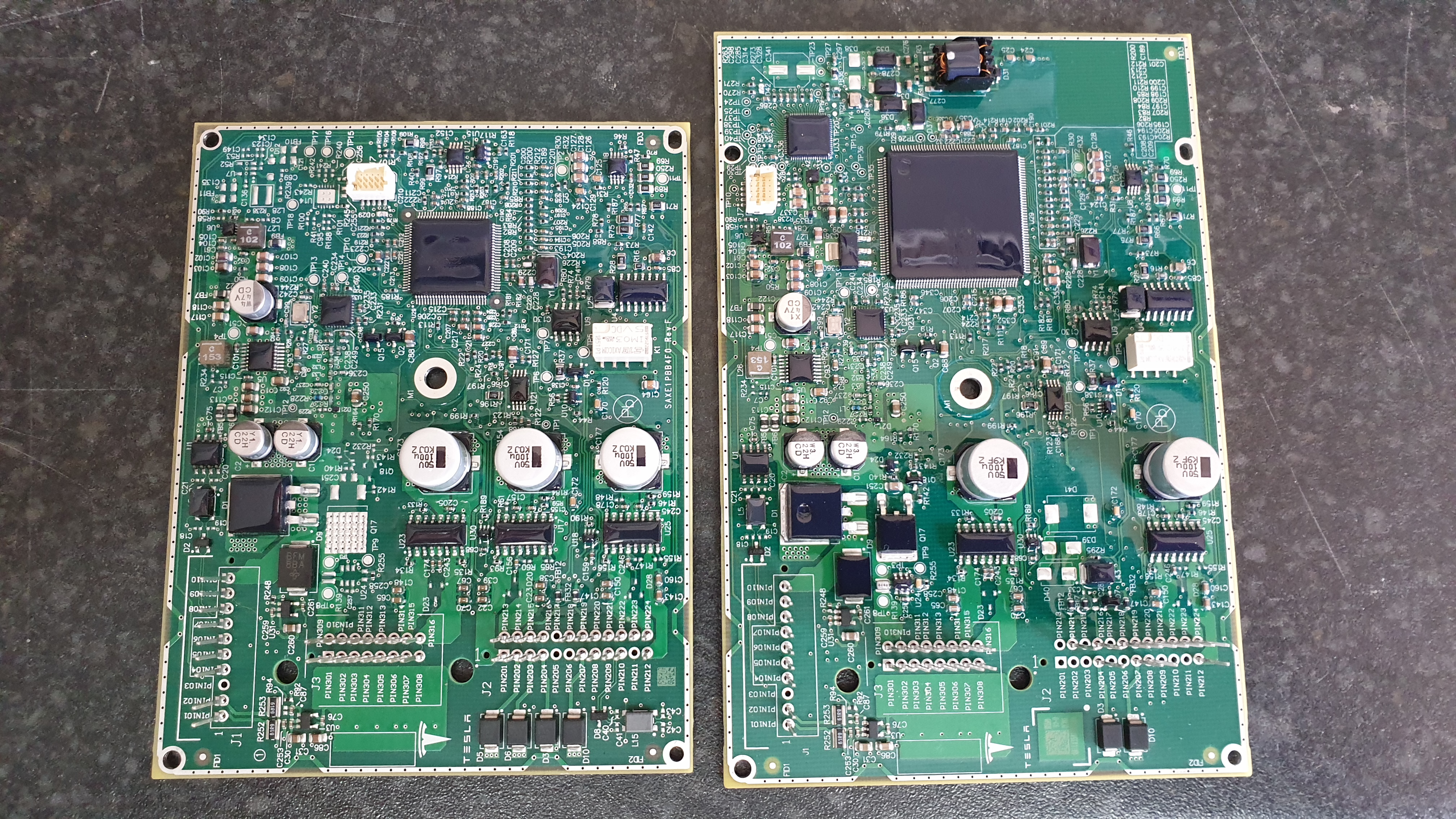

Quick look inside the CP ecus for both US and EU CCS. EU on the right (larger board and micro).
Main micro on the US board seems to be : spc5605bm but a quick search reveals nothing.
On the EU board it is :SPC56EC70L7
https://www.st.com/en/automotive-microc ... c70l7.html

Nice. Now it's fairly obvious the differences in the two. Looks like a potentially more powerful CPU on the EU one. Also, wow those specs..FlexRay, 6 CAN...
"Nexus 1 on all devices" but "Secured device boot mode", so who knows what a debugging interface would show. If we can get a firmware dump I can run it through IDA as I have the PowerPC decompiler.
For now will keep trying to refine what I've got. I know handle pushing the button on the handle while the relay is enabled correctly, so that's something.

Ok so finally here is a first cut at the schematic.
Added in the battery and extra driver.
Programming via swd. Can add jtag if necessary?
USB on USART1
WiFi on USART2
USB on USART1
WiFi on USART2
CCS_M3_VCU_V1 - Schematic.pdf- (207.33 KiB) Downloaded 1118 times

As of now I can manipulate LEDs and I've got a way to print to the serial port in Rust. In the grand scheme of things, the amount of code is still way less than with the Arudino support library backing things. There will probably be a bit more setup code, but I think overall it'll be pretty good.
I appreciate things like this: The code to make the example run is:
#![deny(unsafe_code)]
//#![deny(warnings)]
#![no_main]
#![no_std]
extern crate panic_halt;
use core::fmt::Write;
use nb::block;
use cortex_m_rt::entry;
use stm32f7xx_hal::{
delay::Delay,
pac,
prelude::*,
serial::{self, Serial},
macro_rules! uprint {
($serial:expr, $($arg:tt)*) => {
$serial.write_fmt(format_args!($($arg)*)).ok()
macro_rules! uprintln {
($serial:expr, $fmt:expr) => {
uprint!($serial, concat!($fmt, "\n"))
($serial:expr, $fmt:expr, $($arg:tt)*) => {
uprint!($serial, concat!($fmt, "\n"), $($arg)*)
#[entry]
fn main() -> ! {
let p = pac::Peripherals::take().unwrap();
let cp = cortex_m::Peripherals::take().unwrap();
let rcc = p.RCC.constrain();
let clocks = rcc.cfgr.sysclk(216.mhz()).freeze();
let gpiod = p.GPIOD.split();
let tx = gpiod.pd8.into_alternate_af7();
let rx = gpiod.pd9.into_alternate_af7();
let serial = Serial::new(
p.USART3,
(tx, rx),
clocks,
serial::Config {
baud_rate: 115_200.bps(),
oversampling: serial::Oversampling::By16,
character_match: None,
// Get delay provider
let mut delay = Delay::new(cp.SYST, clocks);
let (mut tx, mut rx) = serial.split();
loop {
uprintln!(tx, "Hello there, the answer is {} ", 40 + 2);
delay.delay_ms(500u16);
Most of this is setup code, and overall will be a small portion of code. The syntax of certain things seem weird, like the

First glance looks good, but as mentioned, definitely a hardware design `newb` so I'll let others chime in here.Jack Bauer wrote: ↑Fri Oct 02, 2020 9:31 am Ok so finally here is a first cut at the schematic.
USB on USART1
WiFi on USART2
Is SWD enough to do the whole gdb remote debug thing? That's how I'm programming the Nucelo right now. (I think yes as SWD is single-wire-debug, right?)
-Matt

I'll put in a full jtag just in case using a tag connect : https://www.tag-connect.com/
pcb layout commencing:)
- mdrobnak
- Posts: 692
- Been thanked: 5 times
Re: Tesla Model 3 Charge Port Controller Standalone Development
Nice, ok that seems reasonable.Jack Bauer wrote: ↑Sat Oct 03, 2020 8:48 am I'll put in a full jtag just in case using a tag connect : https://www.tag-connect.com/

- Posts: 3999
- Been thanked: 1114 times
Excellent. Will have prototype hardware from JLC in about 2 weeks.

So it turns out that my calculation was off-by-one, and now we have liftoff:
Both boards are working. Now I will start figuring out how to pass the data around like I did with the C program. Then I'll hook it up and give it a whirl.

All the sending IDs are implemented, and I've go the absolute basics for CAN receive implemented. So tomorrow I'll work on that. So my original "I'll get it going by Friday" wasn't exactly right, but I never said what getting it going meant.
Also, last 4 activity items: -Matt

It's not perfect, but I'm pretty happy for how well it worked for the first time being connected to the CP ECU:
Next items:
* State machine fix from "Stop Charge" back to correct place depending on what is the cause for stopping.
* Review logs of J1772 charge to ensure the state machine flows correctly for that case.
* Review voltages of latch and proximity pins under various scenarios
* Review ADC docs so I can get the actual state of the fault line voltage.
* Review DAC docs so I can appropriately control latch and proximity pins.
