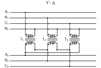

Re: Car inverter as a 3 phase inverter ?
I believe ideally you want 3 transformers. This should give you both the filtering, and a 3P+N output.Pete9008 wrote: ↑Sun Oct 23, 2022 3:54 pm Have thought about this too, for single phase I was wondering whether a 110-240V isolating transformer (of the type used with power tools) would provide enough inductance to convert the PWM to cleanish AC and also provide isolation?
Assume there must be equivalent transformers for three phase but not sure what to search for to find them?
The downside is that I suspect this will be a rather large transformer.

I hadnt realized that one. So rotate the field in MG1 and phase load MG2? How to connect N lines to MG1 phase outputs then? Just plain copy of the MG2 positions? Would we have to time the MG1 in respect to MG2 say via current sensors? Or would simply timing driver outputs be enough?
Possibilities...
True, my 3f autotransformer variac weighs about 50kg dry! And it supposedly has a rating of 10kW.I'd estimate the magnetics to be heavier than the inverter if you're looking for more than 10 kW.
Yes you need to consider that transformers also translate any noise on the primary line to the secondary. Filters!
Maybe this is why most "hybrid" inverters are single phase.

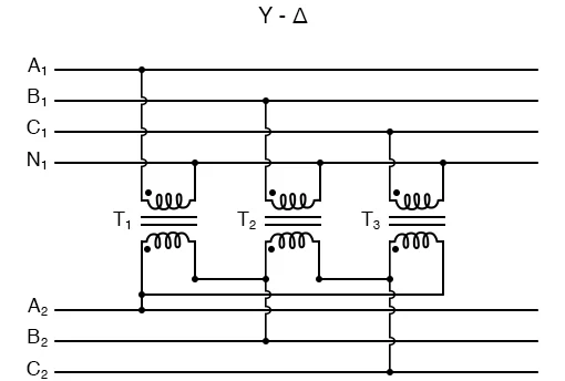

Yes you can have 2 three phase outputs connected to a transformer that has two input windings one delta the other star unearthed. Output of this would be a third earthed winding for connection to your load. These three winding transformers are routinely used for the old 6 phase thyristor controlled mine winder controls etc, so you may pick up one at a salvage yard. But lots to consider: winding voltages etc...
If you have a small installation single phase for example, you can use a DC/DC boost inductor out of a Prius V2 inverter for getting rid of the high frequencies and smooth them for an iron cored transformer. If you have a few microwaves lying around, pull the 2kV 1uF capacitors out of them and place on the output of the boost inductor and create a low pass filter. You can even use 1 or a few microwave transformers in parallel to get you the power output you want.
I have pulled these 1uF capacitors out of microwaves and put into boxes and plugged into power points in my house to reduce being exposed to harmonics in the house (PPS: tried motor running capacitors but they don't last long across the mains continuously).
PS: when you have a star delta transformer, the delta gets rid of the third, ninth, twelth and other 'triplen' harmonics automatically.

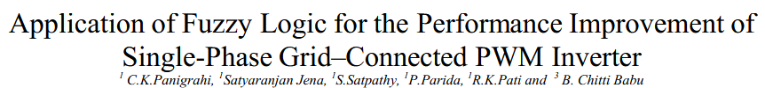

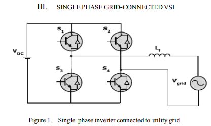

I just happened to see a paper on a full bridge single phase sinusoidal source:
from this:
here are the interesting values they use in this paper:
Current for this circuit is ~12 amps peak.
Hope this helps.

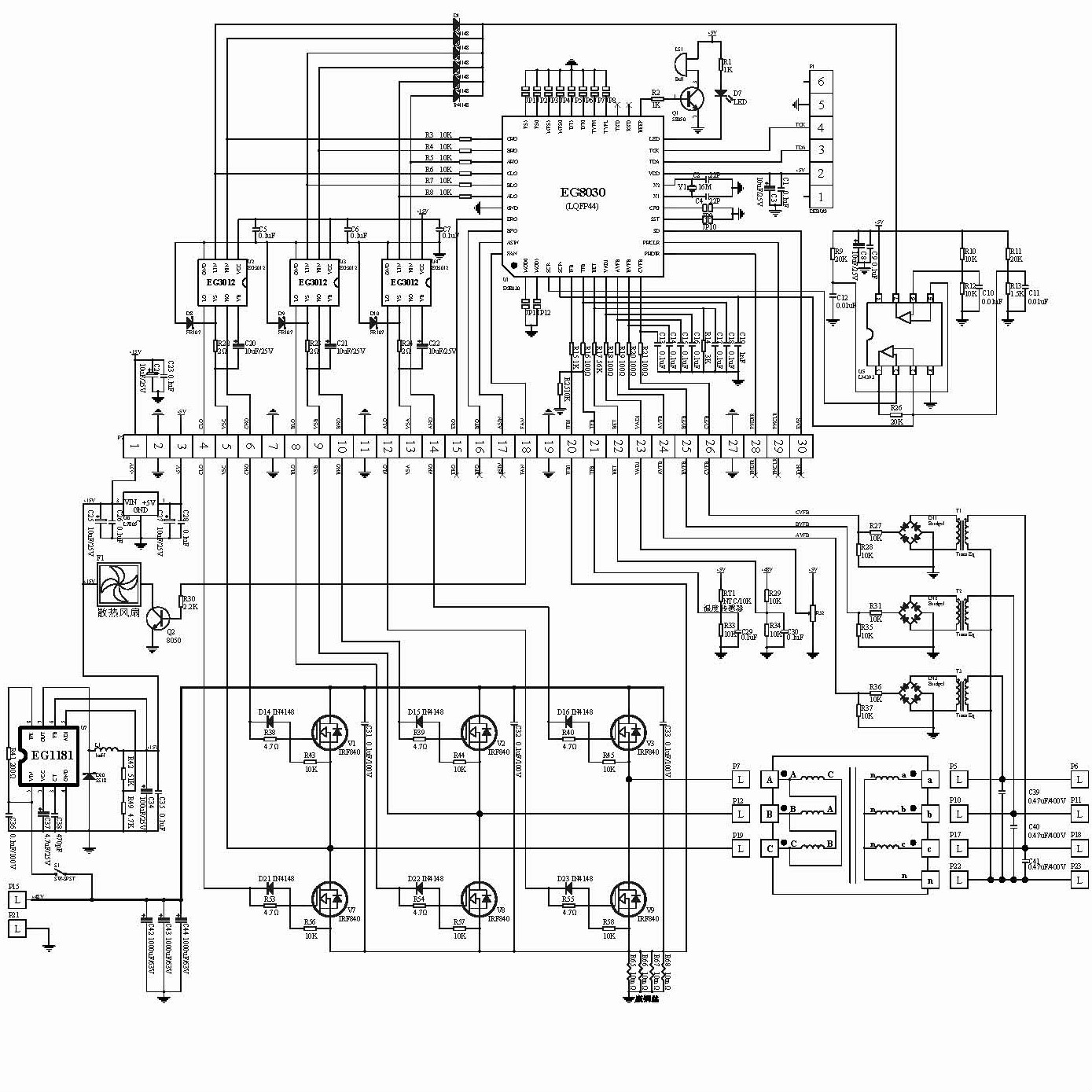

I can offer the board of the generator, which is specially made for the task of the inverter
https://aliexpress.ru/item/100500268781 ... 4aa60dTwYR
