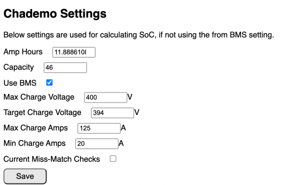

Settings
The Chademo settings are done via the web interface on the ESP32

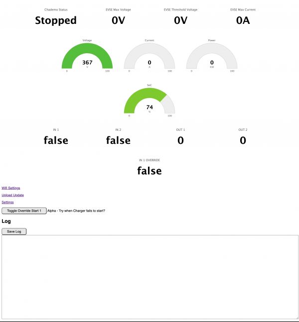

The main interface is
