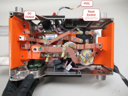

Unknown (HVJB Contactor Control?) Connector Xnnn
HVIL Connector Xnnn
- Only the outside pins are in use. These are used to integrate the HVJB's Lid Reed Switch into the HVIL loop, and this is connected to the HVJB's Lid Reed Switch only if the OBC is the only or Master OBC.
- For Slave OBC, or all RAV4 EV, this connects to a short loopback instead.
