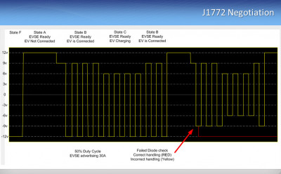

DrJeff wrote: Wed Oct 30, 2019 3:04 amWhen connected to the Proximity line on the controller card, I'm getting +9-12V which is consistent with the EV Connected Ready signal. When I disconnect from the Gen2V3 card (so EVSE connected to nothing I get +12V - no square wave.
As you say those are states A and B and are correct (see image below). Can you also confirm that you get a 1kHz pilot signal with a swing +6V / -12V during charging? Also verify the duty cycle during charging is 66%?

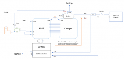

PROGRESS!!! 2/3, but still better :)
Thanks guys for the help - finally some progress that points towards a cause !!!
I replaced both PSUs (feeding the 12v/GND for the Charger AND 12v/GND to the Contactors controller) with a single car battery, feed through a switch and a 15A fuse. This allows 2 out of 3 modules to charge (any two modules concurrently charging, but not three). So the charger must be doing some kind of check (current leakage? power availability?) that if not passed prevents the requested charging from initiating. As additional modules are requested either the sensitivity of the test is increased or more likely whatever 'error' the charger is testing for passes a threshold. It could be that swapping from PSU to Car Battery made the difference or just messing with the cables and connections was sufficient.
The odd need for a ground connection between the charger/HVJB cases (grounded to the EVSE) and the GND from the car battery is still necessary for the Gen2V3 card to be able to tell if the EVSE button is pressed, connected, or unconnected. When that ground is missing - the Gen2V3 card oscillates from Pressed to Connected. I suspect that the GND connection from the EVSE is connected to the Model S grounds just after the charge port. So while this looks like an odd ground connection in my setup, it is normal for the Model S (EVSE ground connects to car's body ground rather than to the HVJB case).
Also, I have a laptop with USB connections to the Gen2V3 charger card, and also to my Battery Contactors controller. The 2/3 charging symptom occurred whether or not the laptop was also plugged into 120v power (i.e. battery vs wall plug).
So some things to follow up on next...
1. Further cleaning up / increasing cable size on the 12v lines.

Correctly grounding the charger case, 12V ground and EVSE/AC ground to the same point is curcial for this all to work.
All EVSE signals are ground referenced, also the modulels have leakage detections and earthing checks.

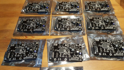

Some good news on board supply. I have now acquired a much more reliable pcb manufacturer here in Ireland and boards will be in stock for immediate dispatch. No more silly delays and boards are being built on an automated smd line so quality is much improved.

SUCCESS!! All 3 modules Charging.
Some additional changes this morning - now all 3 modules are charging...
1. Created a 'ground bar' to which all the GNDs connect (EVSE, HVJB Case, Charger Case, Battery Mgt System [Contactors], Charger inputs]
2. Wired the EVSE ground directly to the ground bar (not to the HVJB case)
3. Cleaned up the connections from the 12V car battery to the Charger controller

So, all along it was the mess of your testing setup?

Yep, sure looks like it - one of the downsides of learning as you go. Of course trying to 'debug' something like this is a bit of a crap shoot... is it the charger version (couldn't get a clear steer on whether anyone else had my version working), potential firmware differences, singlephase/type1 potential issues, etc.
But in the process I've learned a lot. I understand the charger code in detail, got to test my battery control module many times, I understanding the charging process. All good because that's what I set out to do building the TesLorean - i.e. learn a lot. Now that I can charge the battery I can go on to testing the drive unit, PTC heater, coolant heater, AC, etc.

On the subject of grounding. I have mentioned this multiple times on multiple platforms. The Tesla chargers are very sensitive to grounding. The case MUST be connected to vehicle 12v ground AND evse earth/ground when charging. Otherwise problems arise. The open source logic boards do not implement ground on the screw holes. Yes I do know that Tesla do. My reasoning is born of many long days and nights spent chasing ground loops and emi. I have 2 Gen 2 chargers in 2 of my cars charging almost daily with no problems. Is this exhaustive proof of a working design? No, of course not. If people feel this is necessary then please by all means download the design files, make the modification, make some boards , do some testing and report back.

True, at Zero-EV having the three grounds (AC inlet (EVSE), Charger Case and 12V ground) properly connected works every time.
Anytime the chargers are behaving weirdly checking grounds should be a first checking point. We usually bolt a ground strap to the case of the chargers and back to car/vehicle body so we do not have to rely on the bolting interface.
