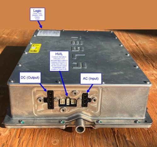

Tesla GEN1 Onboard AC Charger
Tesla GEN1 Onboard AC Charger. Note the stamped "TESLA" on the cover, which visually distinguishes it from later versions.
The Tesla GEN1 on-board AC charger (OBC) is a single/three phase 10kW AC charger that was fitted originally and primarily in the Tesla Model S, from 2012 through late 2013, when it was replaced with GEN2. GEN1 models are easy to identify, having the word "TESLA" stamped on the top metalwork; the GEN2 charger lacks the Tesla identifier stamped on the metalwork.
One (or optionally two, in a Master/Slave configuration) GEN1 chargers are installed beneath the rear seats in the Model S for AC charging. If two are fitted, both are identical hardware, though the firmware differs.
The charger is made up of three 3.3 kw modules, each sitting on a liquid cooling plate. This assembly enables both single and multi phase AC charging.
The GEN1 chargers are considered to be more trouble-prone than the later units, and are not as popular for use in EV conversions or ground-up builds, but are used in many OEM installations that continue to need servicing. Examples of OEM installs include the 2012-13 Tesla Model S, 2012-14 Toyota RAV4 EV[1], and 2014-17 MB B250e[2]. As far as is known, these are identical from a hardware perspective[3], but the firmware does differ and is not interchangeable between installations.

There are six discrete connectors on the GEN1 OBC. In typical applications, they are not all in use.
Logic Connector X042
Logic Connector X042, 12-pin

Common Issues
  • The Tesla chargers are very sensitive to grounding. The case MUST be connected to vehicle 12v ground and EVSE earth/ground when charging. [1] The OEM installation for the Tesla Model S has a prominent ground strap.
Tesla Model S GEN1 OBC, showing prominent Ground Strap
