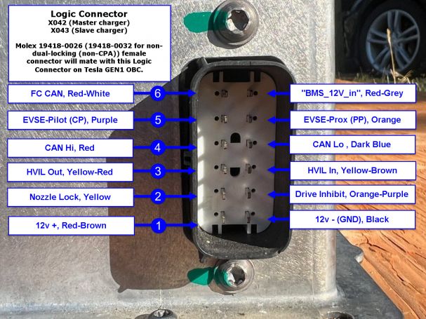

Logic Connector X042
The Logic Connector X042 needed to plug into the charger is Molex 19418-0026[3] which is in the MX150L series.
Molex 194180026, female connector to mate with X042 Logic Connector on Tesla GEN1 OBC.
Logic Connector X042, 12-pin
Pin No. Function Description
1 12v supply
2 Charge Port: nozzle lock "InsertEN out"
3 HVIL Out
4 CAN +
5 EVSE-Pilot (CP)
6 FC CAN (SWCAN?)
7 12v GND
8 Drive inhibit "Prox out", signal to DU to inhibit drive
9 HVIL In
10 CAN -
11 EVSE-Prox (PP)
12 "BMS_12V_in" (BMS enables charger?)
