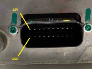

Step 1, to confirm all modules charger work you can connect 12V between top and bottom leftmost pins of the LV connector. Every modul lits its standby LED.

Image from Damiens github repo to clarify pin no 1
