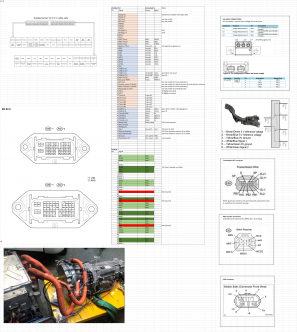

Wiring information for the system, connector pinouts etc can be found here: Lexus GS450h Inverter
Pin Out Diagram
Note: In the software port 0 = EXT2 and port 1 = EXT
