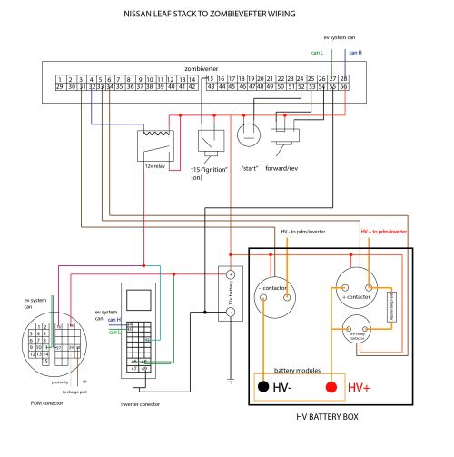

Setting up a leaf stack with the zombiverter VCU
The full leaf stack ( motor/inverter, pdm (charger, dcdc, hvjb)) can be controlled with the zombieverter VCU.
All you need is 12v and CANbus.
As of software release V2.20A, the IVT shunt used for UDC data is no longer required for precharge.
The leaf Inverter itself can supply UDC data for precharge (set the Shunt Type = 0)
Wiring
Wiring the zombiverter to the leaf harness
INVERTER to zombie wiring:
EV SYSTEM CAN-H (pin14) to CAN EXT H (pin 28)
EV SYSTEM CAN-L (pin15) to CAN EXT L (pin 27)
PDM to zombie wiring:
CAN H (ev system) pin 27 to CAN EXT H (pin 28)
CAN L (ev system) pin 11 to CAN EXT L (pin27)
EVSE CONNECTING SIGNAL pin 29 to
EVSE COMMUNICATION (PWM) pin 30 to

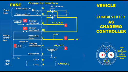

Chademo to Zombiverter:
Chademo connection
chademo connector:
HV contactor coil + pin 2 to GP 12v input
HV contactor coil - pin 10
pin 1 to ground
CAN H pin 8 to CAN EXT 3 H
CAN L pin 9 to CAN EXT 3 L
pin 4 to GP out 3
control:
Leaf stack with zombiverter
n.b to be checked with regards to pinouts above
Pinout
Description Zombieverter Pin
+12V Permanent live 56
Gnd Ground 55
Fwd signal Forward 54
Rev signal Reverse 53
momentary 12V Start signal 52
Brake signal Brake Input 49
+5V Throttle 48
Throttle signal 1 Throttle signal 1 47
Throttle signal 2 Throttle signal 2 46
Throttle Gnd Throttle Gnd 45
CANEXT2H CAN 2 High (ISA Shunt) 44
CANEXT2L Can 2 Low (ISA Shunt) 43
Precharge Contactor LS Switch Negative of low side precharge contactor 34
Main Contactor LS Switch Negative of low side main contactor 33
Inv power switch Relay negative coil to turn on inverter/PDM 32
Neg Contactor LS Switch Negative of low side negative contactor 31
CANEXTH Can 1 High 28
CANEXTL Can 1 High 27
T15 Ignition 12V in 15
