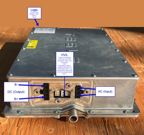

There are six discrete connectors on the GEN1 OBC. In typical applications, they are not all in use.

Input/Output Connectors
Tesla Model S GEN1 OBC Power Connectors
DC (Output) Connector Xnnn

HVIL Connector Xnnn
  • Only the outside pins are in use. These are used to integrate the HVJB's Lid Reed Switch into the HVIL loop, and this is connected to the HVJB's Lid Reed Switch if the OBC is the only (single) or Master (dual) OBC.
Closeup of Tesla Model S GEN1 HVJB (under rear seat), lid removed, showing the HVIL cover reed switch and HVIL connector that connects to a mating connector on the OBC.
  • For Slave OBC, or all RAV4 EV, this connects to a short loopback harness instead.
Tesla Model S GEN1 OBC HVIL Loopback connector. Used on Tesla Slave OBC installations where the HVJB Lid Reed Switch is already connected to the HVIL circuit via the Master OBC. Also used in RAV4 EV, as there is no HVJB installed at all in those models.
