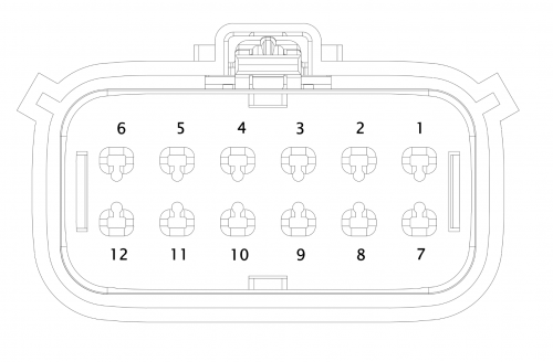

Logic Connector X042
The Logic Connector X042 needed to plug into the charger is Molex 19418-0026[3] which is in the MX150L series.
Molex 194180026, female connector to mate with X042 Logic Connector on Tesla GEN1 OBC.
The female terminals for this housing are Molex 19420-0010[4]
Molex 19420-0010 female terminals for Logic Connector X042, for 18-22 AWG (0.35-0.75mm²).
Logic Connector X042, 12-pin
Pin No. Function Description Wire size
(Tesla Model S)
Wire Color
(Tesla Model S,
2012)
1 12v supply 18 AWG (0.75mm²) RD/BR
2 Charge Port: nozzle lock "InsertEN out" 20 AWG (0.5mm²) YL
3 HVIL Out 20 AWG (0.5mm²) YL/RD
4 CAN + 20 AWG (0.5mm²) RD
5 EVSE-Pilot (CP) 20 AWG (0.5mm²) PU
6 FC CAN (SWCAN?) 20 AWG (0.5mm²) RD/WH
7 12v GND 20 AWG (0.5mm²) BK
8 Drive inhibit "Prox out", signal to DU to inhibit drive 22 AWG (0.35mm²) OR/PU
9 HVIL In 20 AWG (0.5mm²) YL/BR
10 CAN - 20 AWG (0.5mm²) DB
11 EVSE-Prox (PP) 20 AWG (0.5mm²) OR
12 "BMS_12V_in" (BMS enables charger?) 18 AWG (0.75mm²) RD/GY
