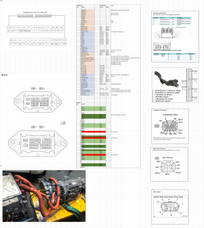

'''Pin Out Diagram''' | '''Pin Out Diagram''' | ||
[[File:ZombieVerter VCU V1 cable side pinout.jpg|thumb|alt=|VCU pinout diagram ]] | [[File:ZombieVerter VCU V1 cable side pinout.jpg|thumb|alt=|VCU pinout diagram |none]] | ||
[[File:Zomb-con-et.png| | [[File:Zomb-con-et.png|link=link=Special:FilePath/Zomb-con-et.png|alt=|none|thumb|332x332px|List of connections to system components]] | ||

Wiring information for the system, connector pinouts etc can be found here: Lexus GS450h Inverter
Pin Out Diagram
