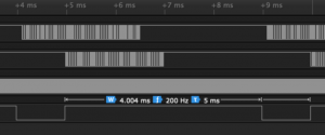

- REQ Request line from hybrid controller to Inverter
- CLK Clock signal from hybrid controller to Inverter (Constant 500KHz)
- HTM Hybrid controller to Inverter data frame
- MTH Inverter to Hybrid controller data frame
Bus Transfer Sequence starts with the REQ line changing state
Toyota Serial example waveforms
- Physical layer investigations: https://openinverter.org/forum/viewtopic.php?p=54373#p54373
- Discussion of physical layer communication issues: https://openinverter.org/forum/viewtopic.php?t=2823
- and: https://openinverter.org/forum/viewtopic.php?p=72233#p72233

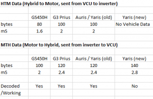

Prius Gen3 PHV (Inverter model G9200-47200) has 105 bytes HTM and 140 bytes MTH
HTM Data
HTM (Hybrid control unit To Motor control unit) data is required to make the motors spin. The following is a collection of what could be some of that data:
Typically the the frame is finished with a 16bit checksum of the preceding bytes, Least Significant Byte first.

Data type | Prius Gen3 | GS450h |
Checksum (sum of all preceding bytes) LSB first | [98,99] | [78,79] |
Engine RPM | [0] | [0] |
MG1 Torque Request*4 | [91,92] | [75,76] |
MG1 Torque Request | [5,6] [11,12] | [5,6] [11,12] |
MG2 Torque Request | [30,31] [36,37] | [26,27] [32,33] |
Battery Regen Power Limit | [76,77] | [63,64] |
Battery Discharge Power Limit | [78,79] | [65,66] |
Sequential Number | [94] |
