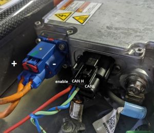

Wiring
HV
HV connector: KET MG655776 type D
HV+ (positive) line is the one on the leftmost - opposite side of the red 12v output bolt.
Minimum required wiring for basic unit function: Seven wires from left):(2) HV Input, (1) HW Enable, (2) CAN (if voltage control is needed), (3) 12VDC Output

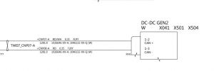

CAN lines are pins 2 & 3.
Note, be careful about which connector you get when salvaging this connector from Telsa wiring harnesses. Specifically, you want the key D variant.
  • Orange (A/C): MG655773 (key A)
  • Gray (fluid heater): MG655774 (key B)
  • Brown (PTC heater): MG655775 (key C)
  • Blue (DC-DC): MG655776 (key D)
Donor Harness: Tesla OE/OEM Part Number: 1032804-00-A has two Blue DC-DC plugs.

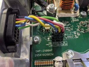

Pinout for LV connector is written on the board
Pinout for LV connector is printed on the board.
LV & Signalling
LV connector: Molex 0334721301
LV connector (top row)
  • Pin 1 : HW-EN (Enable ("turn on") via applying 12v+ )
  • Pin 2 : CAN H
  • Pin 3 : CAN L
The remaining pins are for the HVIL loop, and can be ignored if desired, as they do not affect the unit's function.
