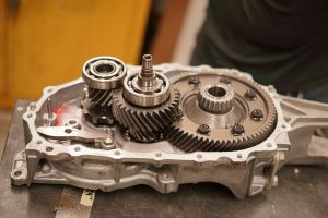

Leaf gearbox with newer style sealed bearings in place

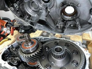

Gen2 gearbox with open bearings

gen 2 gear box reductions gears and open diff
17:31 / 17:74

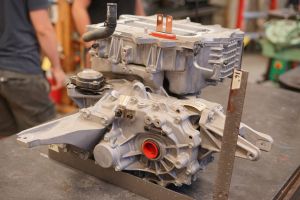

Gen2 with EM57 motor
gen2 leaf gear box, em57 motor and inverter

Input shaft bearings: 6207 C3 (35x72x17) and 62/32 C3 (32x65x17)
Center shaft bearings: 6306

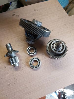

EM57 gearboxes have been found to feature open bearings (probably earlier variants) as well as rubber sealed bearings. There has been reports of open bearings failing prematurely especially with prolonged running in reverse direction which causes the splash lubrication not to function properly. Therefore it in advisable to pay attention to regular oil changes and use good quality oil with the gearbox.
