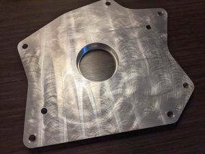

adapter plates
*the bearings in the leaf motor are not designed for axial loads introduced from a clutch and flywheel
a support bearing isnt required if the motor is just directly mated to another gearbox.

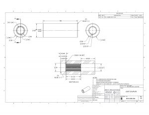

*refer to the drawing of the adapter plate when machining, and not the cad file, to ensure the machine is following accurate data
motor couplers
