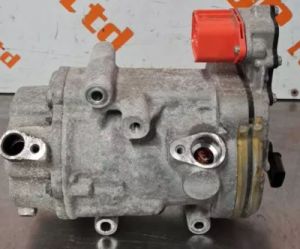

Nissan Leaf ZE1 AC compressor
Jump to navigation
Jump to search
From Leaf model year 2017-2023
It is label Denso S1 ESB27C

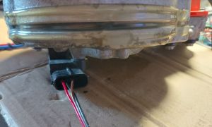

Low voltage Connector
Connector is believe to be Sumitomo 6189-1083 !!!to be verified
The pinout is as follows:
Left most pin 12V ign, middle is ground, right is LIN

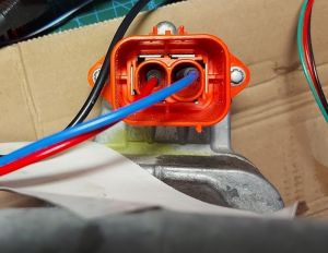

High Voltage Connector
HV, Red is positive Blue is negative
