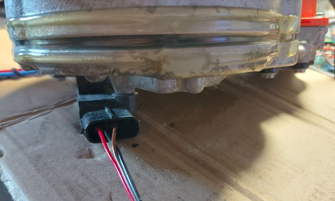

The pinout is as follows:
Left most pin 12V ign, middle is ground, right is LIN
Lin Speed 19200kbps

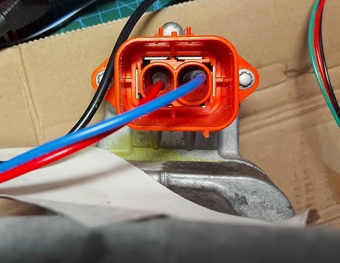

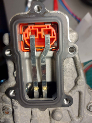

HV, Red is positive Blue is negative
It will not communicate unless it has HV voltage going in, the logic must be HV powered.

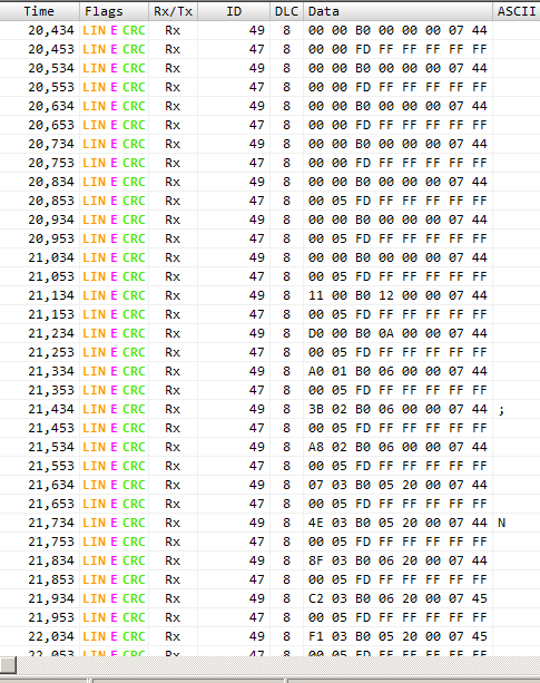

char RX_BUF[80];
//char data[11] = {0x55,0x47,0x00,0x00,0xFD,0xFF,0xFF,0xFF,0xFF,0xFF,0x00};//COMPR-ZE1
//char data[11] = {0x55,0xFB,0xB3,0x05,0x00,0x90,0xFF,0x00,0x00,0x00,0x00};
//char data[11] = {0x55,0x3B,0x00,0x00,0x00,0xC0,0xFF,0x00,0x00,0x00,0x00};//HEAT-ZE0
char data[11] = {0x55,0xFB,0x00,0x00,0x63,0xC0,0xFF,0x00,0x00,0x00,0x00};//HEAT-AZE0
char dataRX[8];
Posts: 2962
Has thanked: 329 times
Been thanked: 847 times
Re: Nissan Leaf ZE1 AC compressor LIN
Marat wrote: Sat Oct 26, 2024 2:09 pm char RX_BUF[80];
char dataRX[8];
So this the command request line for the compressor? Any details on what it contains?

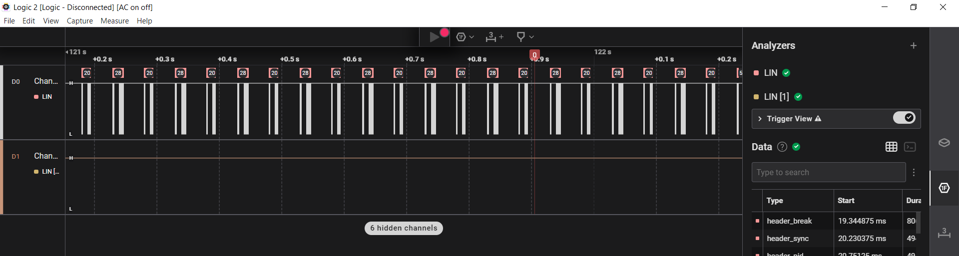

aot93
Posts: 213
Location: UK, West Sussex
Has thanked: 8 times
Been thanked: 49 times
Post by aot93 »
Turns out LIN logging is quite straight forward, thanks for the pointers Tom.
You might already have what you need, but here is the data I just captured.
Bit hard to get the pump to cycle on and off in these temps, but I did a max heating, Max Cooling and off.
Let me know if you need more.
ze1_AC_PUMP.zip
(249.62 KiB) Downloaded 543 times

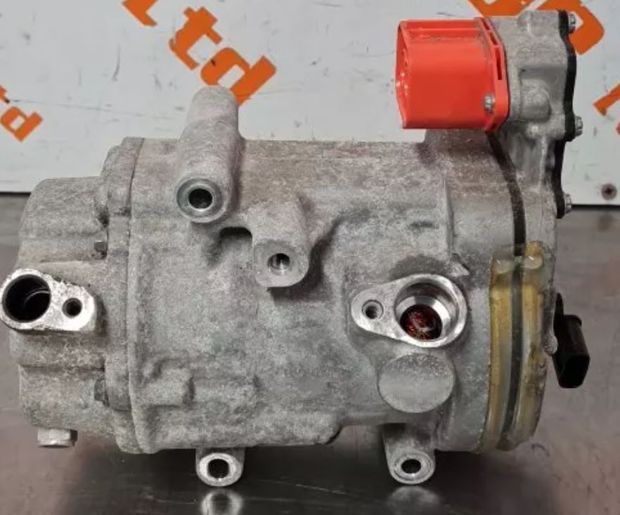

aot93 wrote: Sun Oct 27, 2024 8:27 pm Let me know if you need more.

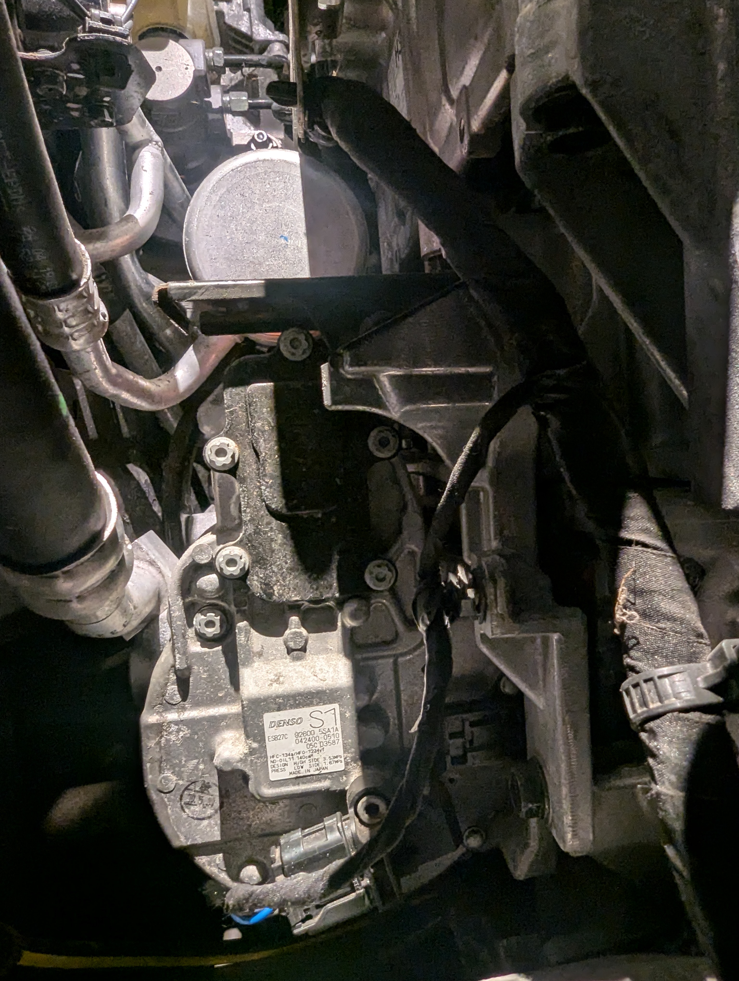

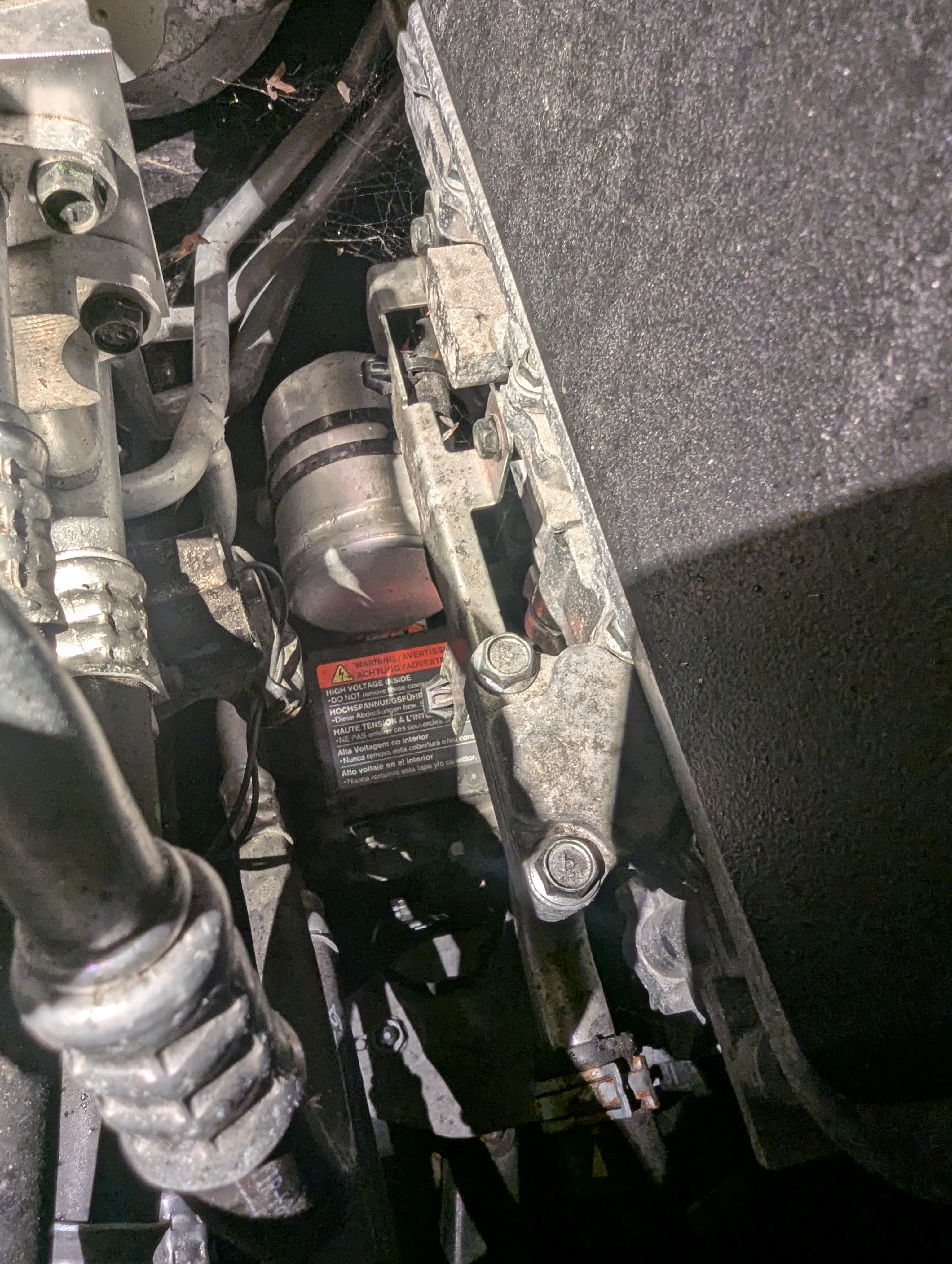

Can you take a picture of you AC pump on your leaf you logged?
Post by aot93 »
[/quote]
[/quote]
Here you go;

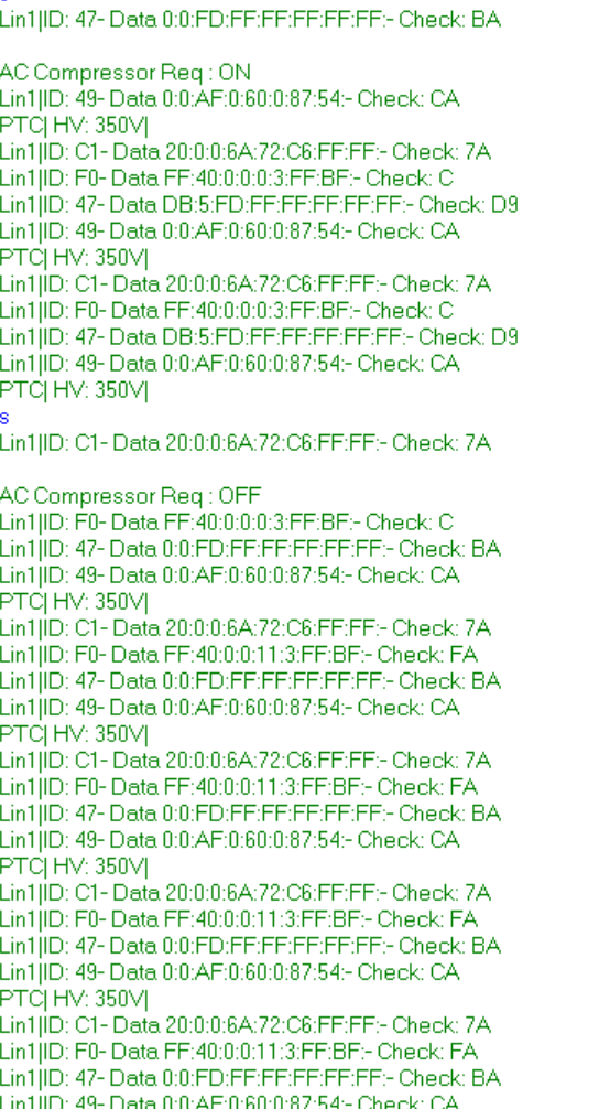

aot93 wrote: Sun Oct 27, 2024 8:27 pm Bit hard to get the pump to cycle on and off in these temps, but I did a max heating, Max Cooling and off.
Surprisingly I do see ID 0x07 (PID 0x47) which is indicated as the command from the info above.
However the response from the compressor, which should be ID 0x09 (PID 0x49) seems to be missing and very poor. How did you make the connection for logging? As I would not expect this on the bench it is very stable for me.

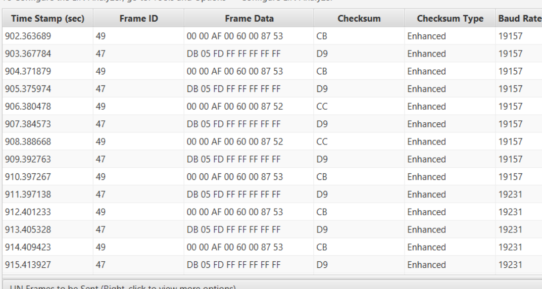

Unfortunately not :(
I have been playing back more and more info from your logs but it all does not seem to matter. Possibly my Compressor is dead?
Posts: 2962
Marat wrote: Sat Oct 26, 2024 8:30 pm "screenshot"
My AC compress shows the following:
|ID: 49- Data 0:0:C1:0:60:0:87:54:- Check: B8
Where C1 is the voltage of 386V, your screenshot shows mostly zeros except the end. Is this an indication there might be an issue with my AC compressor?
Mind sharing any more information you have on this?
