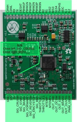

Mini Mainboard
The mini mainboard is the smallest form factor openinverter motor control board. It has the same functionality as the Main Board Version 3 but offloads a few components. It is meant to be used as a daughter board on top of an adapter board. The adapter board must (or may) implement:
- The Wifi module socket
- Relay drivers
In addition the mini mainboard allows talking to SPI peripherals. Therefore some pins have double mapping:
- SIG_CRUISE: MOSI (SJ3 must be closed to the right side for that).
- OUT_BRAKE: MISO
- OUT_ERR: SCK
- OUT_OUVTG: /CS
Like previous boards it contains a 5V switching regulator that can be loaded with about 500 mA. Alternatively It can be powered with a single 5V rail, which has to sit at 5.3V though for sufficient resolver excitation amplitude.
As opposed to earlier mainboards the current sensor inputs are now designed for 5V input, i.e. 2.5V @ 0A. This interfaces directly with most current sensors that OEMs use and also with Melexis chips, LEM HTFS and Tamura L06P current sensors.

Pin Header Summary
Pin Header JP1
| Pin | Signal | Name |
| 1 | CANH | CANH |
| 2 | CANL | CANL |
| 3 | RX | Serial console |
| 4 | TX | Serial console |
| 5 | DESAT | Gate driver fault |
| 6 | PWM1P | Power stage PWM |
| 7 | PWM1N | Power stage PWM |
| 8 | PWM2P | Power stage PWM |
| 9 | PWM2N | Power stage PWM |
| 10 | PWM3P | Power stage PWM |
| 11 | PWM3N | Power stage PWM |
| 12 | R2 | Resover excitation R2 |
| 13 | R1 | Resover excitation R1 |
| 14 | ENC_A/S2 | Encoder channel A or single channel input/Resolver S2 |
| 15 | ENC_B/S3 | Encoder channel B/Resolver S3 |
| 16 | S1S4 | GND/Resolver center point S1S4 |
| 17 | TMPHS | Heatsink temperature sensor |
| 18 | UDC | Bus voltage |
| 19 | IL1 | Phase current 1 |
| 20 | IL2 | Phase current 2 |
Pin header JP2
| 1 | GND | GND |
| 2 | VCC | Vcc (7-26V) |
| 3 | 5V | 500mA output |
| 4 | SIG_CRUISE/MOSI | Cruise Control Input (12V) or SPI MOSI (3.3V) |
| 5 | SIG_START | Start input (12V) |
| 6 | SIG_BRAKE | Brake Input (12V) |
| 7 | SIG_FORWARD | Forward (12V) |
| 8 | SIG_REVERSE | Reverse (12V) |
| 9 | SIG_EMCYSTOP | Emergency stop (12V) |
| 10 | SIG_BMS | BMS Over/Under Voltage input (12V) |
| 11 | THROTTLE2 | Regen Pot Input (0-6.6V) |
| 12 | THROTTLE1 | Throttle Input (0-6.6V) |
| 13 | MTEMP- | Motor Temperature Input - |
| 14 | MTEMP+ | Motor Temperature Input + |
| 15 | OUT_PRE | Precharge Output (3.3V) |
| 16 | OUT_DCSW | DC contactor output (3.3V) |
| 17 | OUT_ERR/SCK | Error Signal or SPI SCK (both 3.3V) |
| 18 | OUT_BRAKE/MISO | Brake output or SPI MISO (both 3.3V) |
| 19 | OUT_OUVTG/CS | Over/Under Voltage or SPI /CS (both 3.3V) |
| 20 | PWM_USER | Temperature PWM output (3.3V) |
