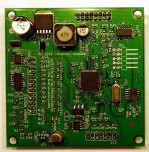

Main Board Version 3
Main board (v1)
Connections

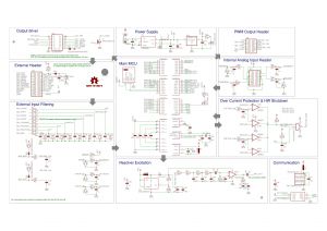

The main board is the heart of the inverter system. It contains all the intelligence that is needed to convert the users inputs into motor shaft movement. It also contains all the protection circuitry to avoid damage in case of erroneous inputs.
The pdf schematic is available via github.

schematic (v2)
  • The precharge output (OUT_PRE, pin 20) has two paralleled outputs, resulting in a maximum sinkage of 500mA.
  • The DC contactor (OUT_DCSW, pin 12) output is is switch via a additional N-Chanel mosfet, which can sink up to 1-2amps.
There's no econimizer system built into the openinverter board, so make sure your contactors have the appropriate economizing circuits .

*note: there's 2 versions of the main board v3, the old board lacked the high current output drivers for the contractor control. This old version is only capable of sinking up to 300mA for the OUT_DCSW and 150mA for OUT_PRE.
Pictured in: "Main board (v1)"
