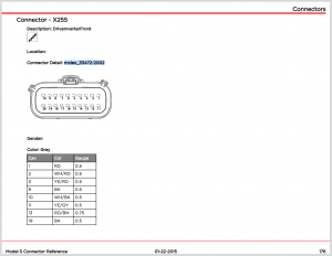

Small Drive Unit ("SDU") Data Connector
Low Voltage Data Connector
Small Front Drive Unit ("SDU") Data Schematic
Housing
Molex MX150 33472-2002 (key “B”)
Pins:
22 AWG:      Molex 33012-2003
18-20 AWG: Molex 33012-2002
14-16 AWG: Molex 33012-2001

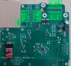

Drop-in control board
Tesla SDU drop-in board
This board replaces the original board that comes with the OEM Tesla drive train. As opposed to the latter this board lets you use the drive train in the first place and allows you to fine-tune driving behaviour with the usual set of openinverter parameters. It does not restrict you in power output or regen input.
You can fully control the board via CAN or via a set of digital and analog inputs.
Dual Pot mode, connect pot 2 to pin 10, BRAKE TRANSDUCER SIGNAL.
Note: see this thread regarding throttle pedal safety https://openinverter.org/forum/viewtopic.php?p=75841 this applies to the SDU boards.

Application Info
The board comes programmed with a recent software version. Please check github for recent software releases. In addition the board comes with a set of parameters appropriate to run the Tesla SDU. So it will work out of the box. Parameters that must not be changed are hidden to eliminate sources of error.
It is essential that the tripmode parameter is set to 1 "DcSwOn". Also do not use a low value fuse while testing. On over current trips some energy is still stored in the motor and it has nowhere to go if the contactor/fuse opens leading to immediate destruction of your inverter.
You will need to solder the supplied connectors and the current sensors embedded into the inverter assembly to the board, see this video.
To test run your drive unit, supply the board with 12V and GND on Conn6.13 and Conn6.19, respectively. Also supply 12V to Conn6.5 to select forward direction.
Supply inverter with some high voltage. For first tests it is recommended to put a large resistor/heating element/kettle in series.
You can start in manual mode using the button on the web interface and enter like 1Hz for „Fslipspnt“ and some value between 10-50 for „ampnom“ to see if the motor spins up. Be careful because manual mode does not enforce a motor speed limit!
You may also set parameter „udcsw“ and „udcmin“ to 0 and start drive mode by pulsing 12V on Conn6.9. Then connect a pot between Conn6.4, Conn6.7 and Conn6.8 (wiper). This will also spin the motor AND enforce a speed limit.

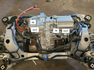

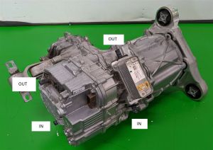

Cooling
Small Front Drive Unit (FDU)
Tesla FDU cooling
Small Rear Drive Unit (SRDU)
Tesla SRDU cooling
Various step files for printing your own coolant port here:
https://www.printables.com/model/1693168-tesla-model-s-rear-sdu-coolant-port
There are three files - a dxf which is the basic outline if you want to cut your own plate and thread it yourself. There is a BSPT version, which has a 3/8in thread for a hosetail, or a complete version with outlet attached. You will need to make your own choice regarding material to use.
