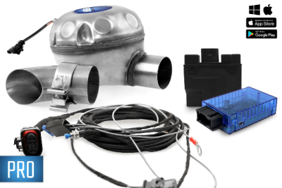

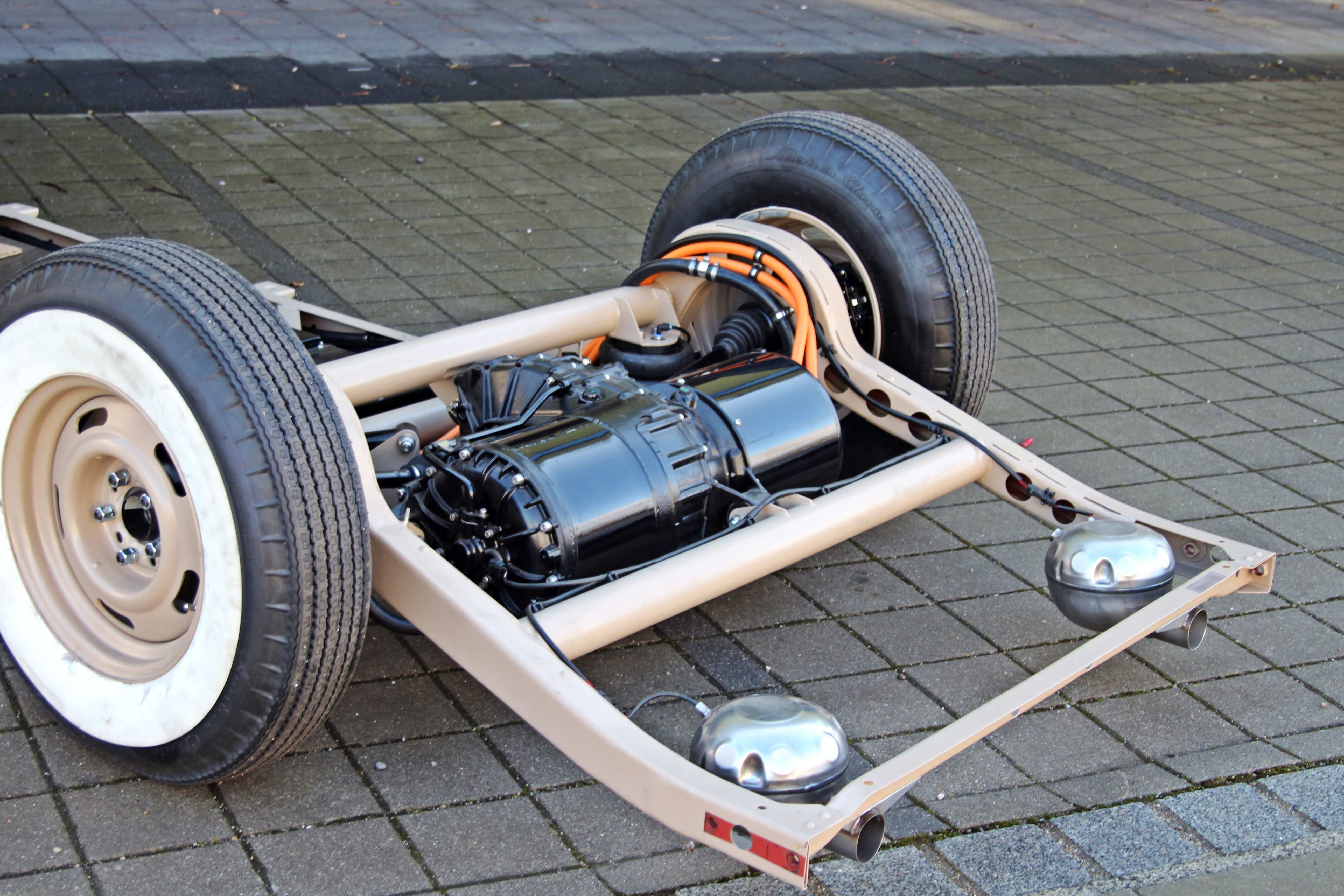

I have integrated audi exhaust loudspeakers. There it is called “active silence”. As my car is old (1950) and I want to preserve the character of the car, I simulate the sound of the combustion engine including the automatic gearbox. This is not a legal problem as long as it is not louder than the original car. If I want, I can also switch it off or only activate it at slow speeds.

I have installed this system. The engine sound is generated by the Audi control unit (black box), which also contains the amplifier. The blue Kufatec box controls the Audi box and needs two CAN bus signals, one for engine speed, one for load. I have programmed the gearbox simulation on an AVR AT90CAN128, which calculates and generates the necessary CAN signals and controls the rev counter and all other displays. There are 2 speakers mounted in the rear of the chassis which end like exhaust pipes below the bumper.

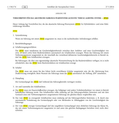

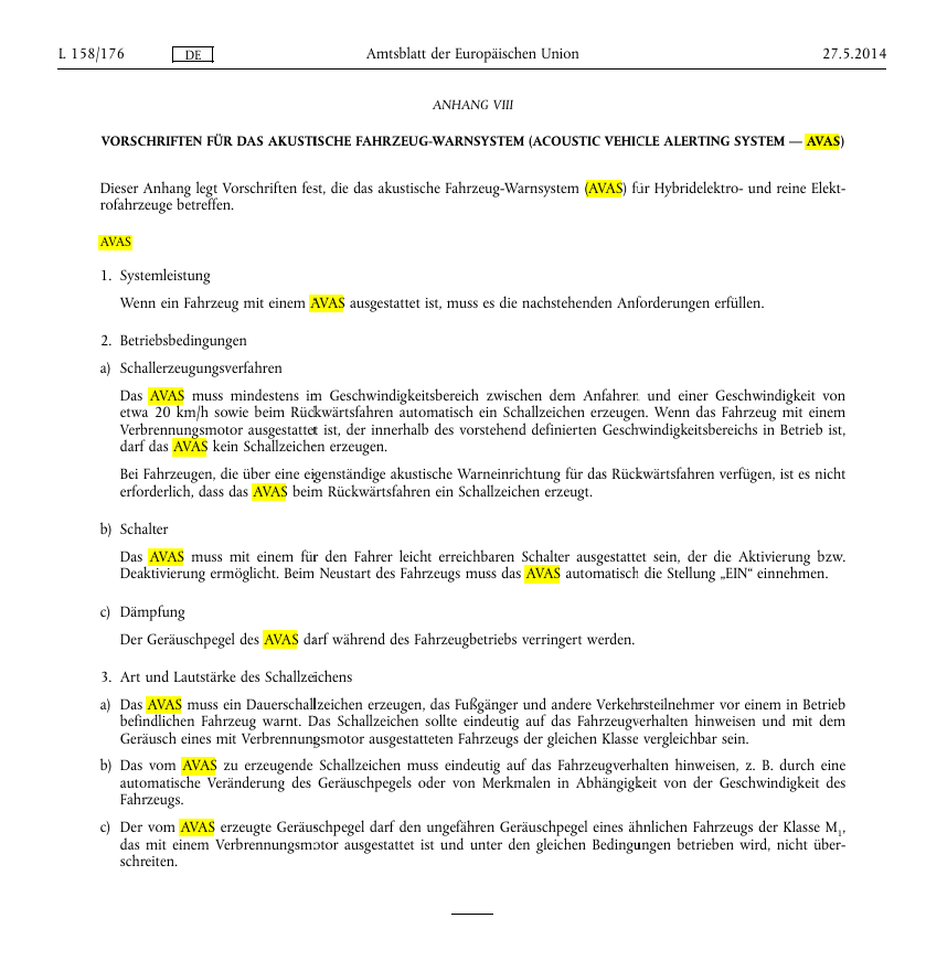

The legal aspects for Europe can be found in the Regulation (EU) No 540/2014

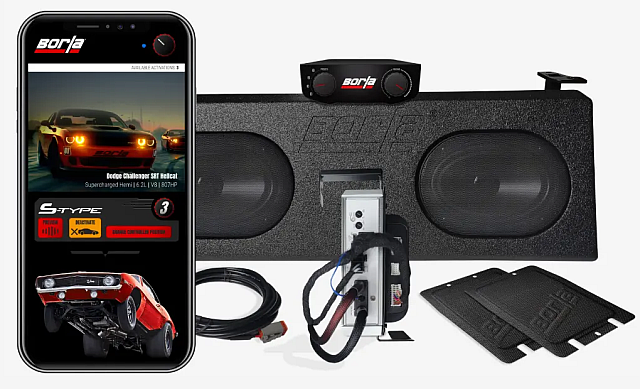

But, if cost is no object, BORLA already makes a system. I don't know if its worth USD$1600 though!!! The below link has a good video:

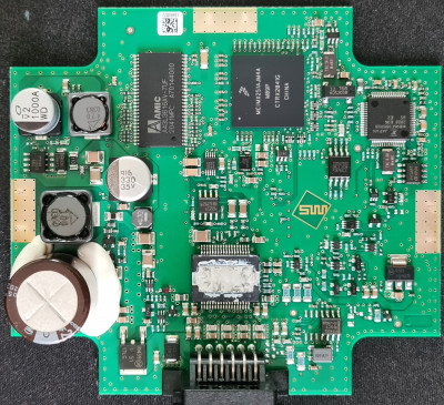

Had a closer look to the Hyundai Ioniq VESS, which may be uses the same concept as the Kona. Looks like these offer good opportunities to add an own sound. The sound samples (for driving, reverse bing and annoying beeeep) are stored in a SPI flash, and played by the Yamaha sound chip in different speeds depending on the vehicle speed. Was able to read the flash and listen to it on the PC with Audacity
Did not yet patch the original unit, not sure whether I go this risk before the TÜV date ;-/
Unfortunately there are different software versions flying around, and the VESS which I ordered cheap, with version 1.00, does not play in my car at all.
Results here: https://github.com/uhi22/Ioniq28Investi ... oundSystem
