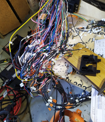

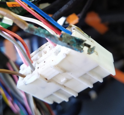

First a note for anyone who can read the forum when not logged in but gets an error once logged in. See this thread viewtopic.php?t=6583
After months of investigation today I have finally achieved successful and consistant turn on/off.
I spent hours checking my logs against the logs ProjectGus has kindly made available. Every message I had that didn't match for some reason I would try simulating.
Many thanks to ProjectGus for making his Bench-Kona code available. I have hacked it extensivly and now have Bench_IEB, bench_OBC etc. But that wasn't the problem.
The more I played the less often I could get turn on.
Time to review the EE21 connections.
I had just pushed the male & female pins together with a bit of heatshrink. It had all been bathed in battery acid and I'd given it a bit of a clean but nothing fancy so thought the connections might be bad.
Looks like we have some work to do.
So I reterminated all the EE21 wires and E/R-A PCB block connector.
After 3 days I'd reterminated all the wires. Cut each one back to clean wire and solder the joint.
Still no success.
The EBC had been giving me trouble when I pushed the brake peddle, some times it would pulse violently and give lots of errors that needed to be cleared. So I pulled all the calipers off the car and connected them up. I now have EPB working and the EBC behaves nicely.
Still no turn on though.
