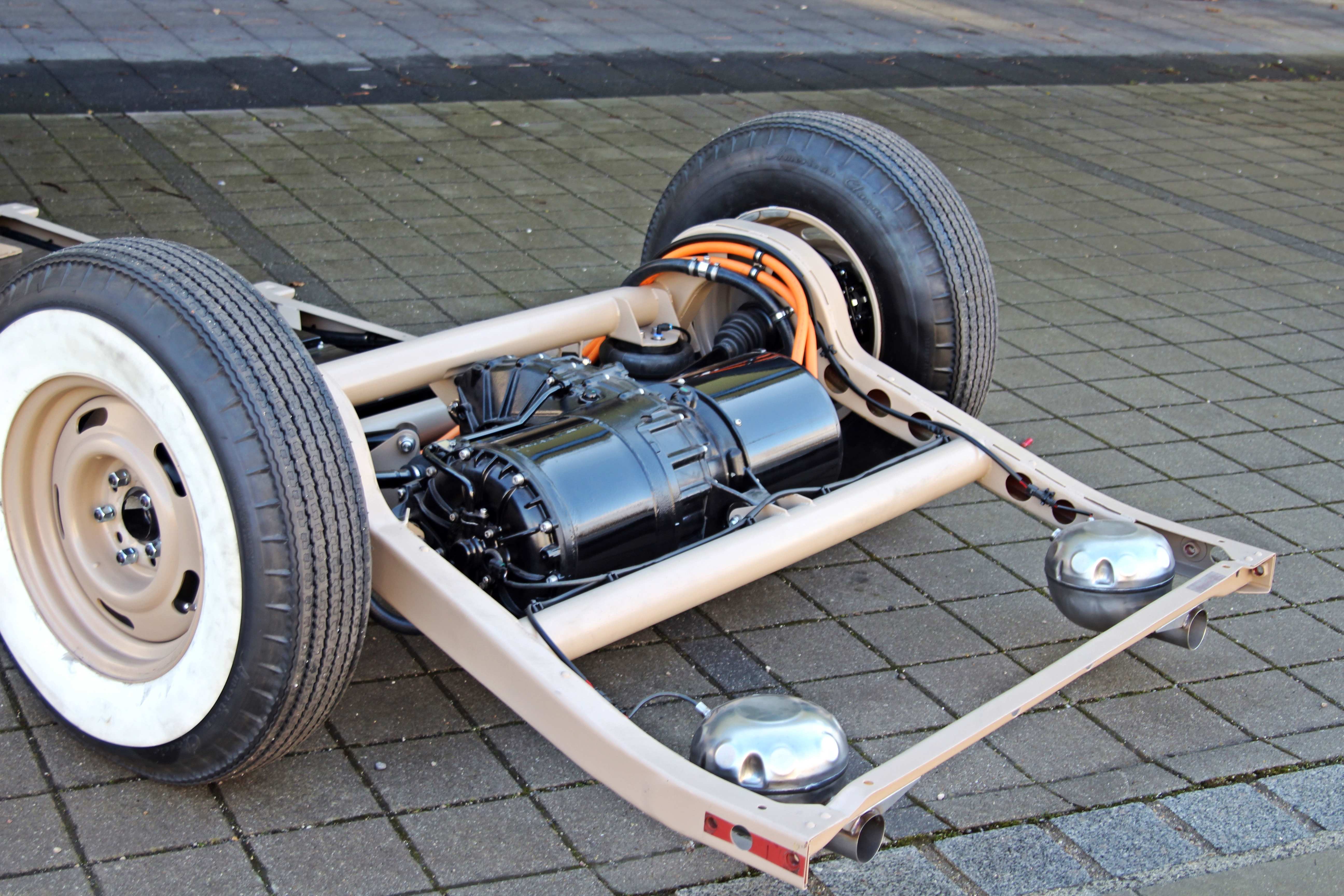

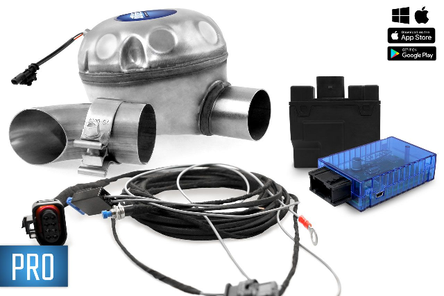

I have integrated audi exhaust loudspeakers. There it is called “active silence”. As my car is old (1950) and I want to preserve the character of the car, I simulate the sound of the combustion engine including the automatic gearbox. This is not a legal problem as long as it is not louder than the original car. If I want, I can also switch it off or only activate it at slow speeds.

If the question is addressed to me. The frequency changes with the calculated speed, the sound is load-dependent (accelerator pedal position) It shifts 4 gears, the shift points vary with the accelerator pedal position. When accelerating hard, it shifts down a gear. The slippage of the torque converter is also simulated. The calculated engine speed is also displayed on the instruments.

I have installed this system. The engine sound is generated by the Audi control unit (black box), which also contains the amplifier. The blue Kufatec box controls the Audi box and needs two CAN bus signals, one for engine speed, one for load. I have programmed the gearbox simulation on an AVR AT90CAN128, which calculates and generates the necessary CAN signals and controls the rev counter and all other displays. There are 2 speakers mounted in the rear of the chassis which end like exhaust pipes below the bumper.

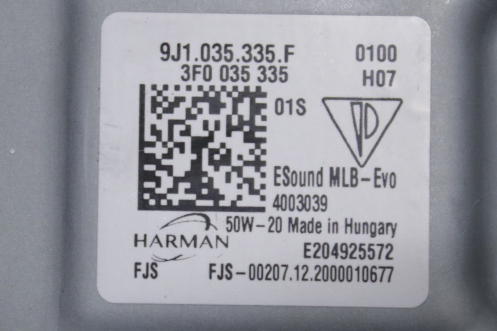

I want to use the VW Soundmodule 1EA035335
This is the same one as in the Audi E-Tron GT and maybe the Porsche. It will take some time till I get to this point in my project, but when I get this to work I will post a Tutorial on here. Ill keep you guys updated

I also ordered one from the USA, these things are very expensive here, do you have a circuit diagram or the pinout for it?
i thing is the same

Different Part numbers. 1EA...... is MEB (the current VW platform), the 9J1...... looks like a Porsche part number, the "MLB EVO" is the old Audi line. Not sure how similar they are on the engine CAN.

Jeep wrangler in Canada with GS450H and Thor sound generator
