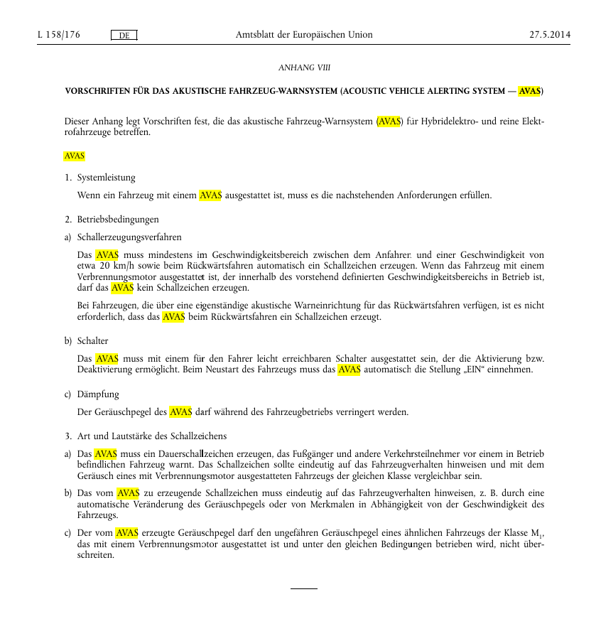

- muehlpower
- Posts: 750
- Has thanked: 17 times
- Been thanked: 168 times
Re: Sound generator possibilities of implementation
The legal aspects for Europe can be found in the Regulation (EU) No 540/2014
