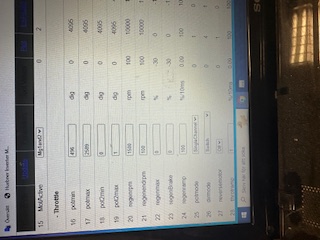

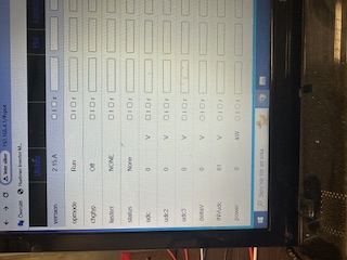

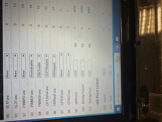

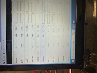

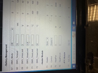

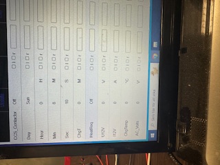

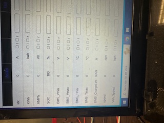

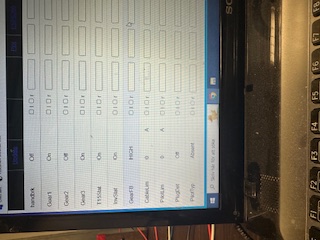

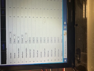

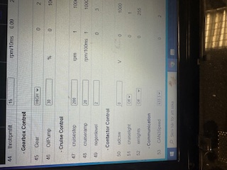

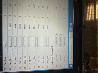

Hi
I've done the connections. I've got about 60,8 ohm between the connections REQ- REQ+ , CLK- CLK+ , MTH- MTH+ , HTM- HTM+
I get it in RUN mode and the oil pump is spinning. I got a single throttle connected and calibrated 10 over and 10 under the values.
I got 60V going in to the inverter. But I can't get it to spin.
When I have ReGen programmed I can feel how it holds back when I turn the prop shaft and the transformer shows voltage above the 60V and sometimes goes in some secure mode.

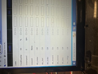

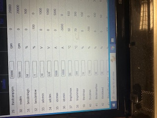

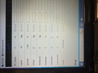

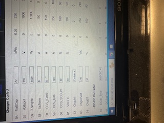

I enclose all readings and settings. Please help me someone who understands this. I'm sure I have some settings wrong.

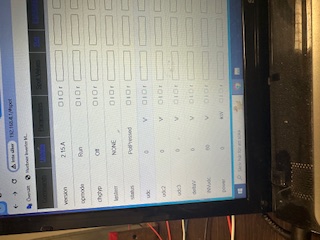

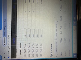

As you can see on second pic is that status goes into POTPRESSED when I press the throttle.

where is the .JSON with the parameters?

As you are running without a shunt, as well as setting udcsw to 0V you also need udcmin set to 0V otherwise the torque setting will be 0.

royhen99 wrote: Wed May 08, 2024 5:10 pm As you are running without a shunt, as well as setting udcsw to 0V you also need udcmin set to 0V otherwise the torque setting will be 0.
UDCmin is set to 10, it is not using a Shunt so set it to 0.
Thank you Sir ! We have a spin :D
