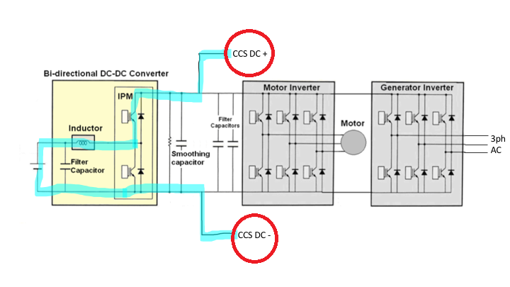

Hello all, I have been following the amazing work done here on CCS rapid charging (Foccci and Clara), and with the Prius Gen 2/3 inverter with regards to using it as an AC charger.
My battery pack voltage is too low for CCS, but I am wondering if perhaps I could boost it with the Prius converter to something that a CCS EVSE could deal with. I note that @clanger9 suggested exactly this:
clanger9 wrote: Thu Jun 11, 2020 7:28 pm Another crazy option I've been thinking about is DC charging via the buck/boost converter. This would ultimately allow me to add CCS to my bike (which by necessity will have a battery pack voltage below the minimum CCS level).
... but I have not seen any follow up posts.
I realise the power output from the EVSE would have to be limited to what the converter can handle but it would allow me to use the CCS chargers when there are no type 2 ones around, and likely at a faster rate than my onboard 6.6kW charger.
So the question is, is this the way of madness or could it work in theory? Thanks in advance for your thoughts.

uhi22 wrote: Thu Jan 25, 2024 7:47 pm "Boosting" is the wrong word. It would mean to create a high output voltage from a lower input voltage, at least this is my understanding. We need the other way around.
Yes, precisely - I believe the sequence needs to be something like:
Battery pack voltage (low side) used to precharge the converter.
Once converter pre-charged, boost it to (say) 400V at high side.
EVSE plugs into car and we request 400V ('high side'). It 'sees' 400V, no massive inrush as voltages equal.
Hence we boost from low voltage to high, rather than buck down from high to low pack voltage.
At least that's what I think, please don't throw stones at me if I am wrong. Or only small ones if you have to.

MoonUnit wrote: Thu Jan 25, 2024 8:49 pm 1. Can Clara instruct an EVSE to provide a specific voltage and current (within sensible reason)? e.g. 400V, 20A? Does it have a low current limit at 400V (for tapering end of charging)?
Yes, the voltage and current limit can be adjusted during the charge process. So you are free to select a fix max voltage and fix max current at the beginning, or, more usual, adjust the limits dynamically, depending on the BMS wish.
MoonUnit wrote: Thu Jan 25, 2024 8:49 pm 3. I am not clear on how to get the low side to 'draw' current from the high, I presume I must reduce the boosting of the low side to a value below 400V to get the current to flow, hopefully subject to the maximum current one has set the EVSE to supply?
As I understand johus comment above, the converter is just feed with a certain PWM ratio, and exactly this ratio will be the ratio of input current to output current and also input voltage to output voltage. The current draw to the low side will just appear automatically as soon as on the high side there is a source which tries to increase the voltage above the "boosted" voltage.
Example: We boost the 90V to 200V. Instruct the charger to precharge to 200V, and close the contactors. Now instruct the charger the limits 300V and 10A. This will lead to transfer of the energy backwards, with 10A/0.45 on the battery side, and if the battery reaches 300V*0.45, the voltage will not further increase.
MoonUnit wrote: Thu Jan 25, 2024 8:49 pm 9kW is not brilliant. I was hoping for nearer 20. However, any charge is better than no charge!
Maybe two in parallel. The control effort does not increase.

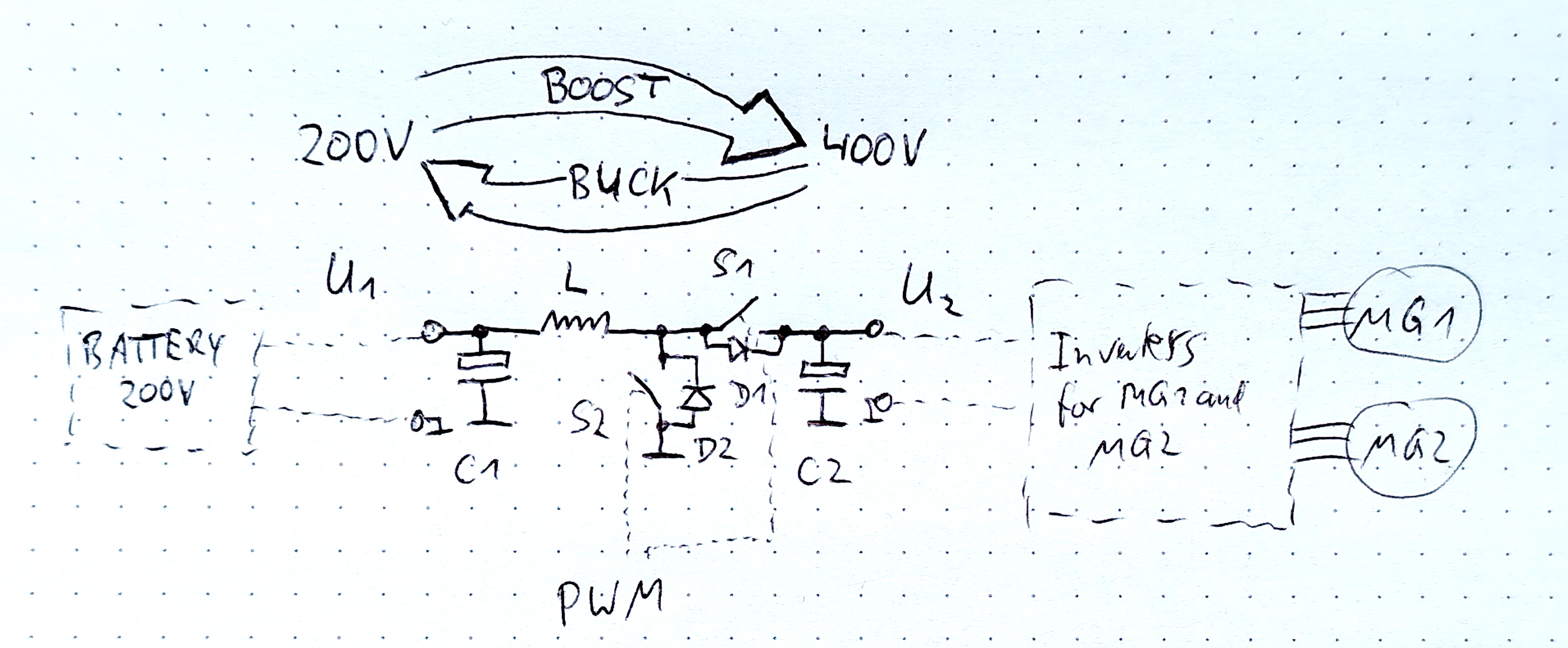

BTW: Is there somewhere a block schematic of this converter? Does it really transfer energy in both directions? How does this work?
Been thanked: 1913 times
Re: CCS charging using Prius buck-boost converter
uhi22 wrote: Thu Jan 25, 2024 9:26 pm BTW: Is there somewhere a block schematic of this converter? Does it really transfer energy in both directions? How does this work?
It's just a synchronous converter with IGBTs on low side and high side. Seen from one direction it is a boost converter, seen from the other direction it is a buck converter.
The Gen2 Prius has just one control signal for both plus an enable signal. The Gen3 has separate high and lowside signals with deadtime requirement.

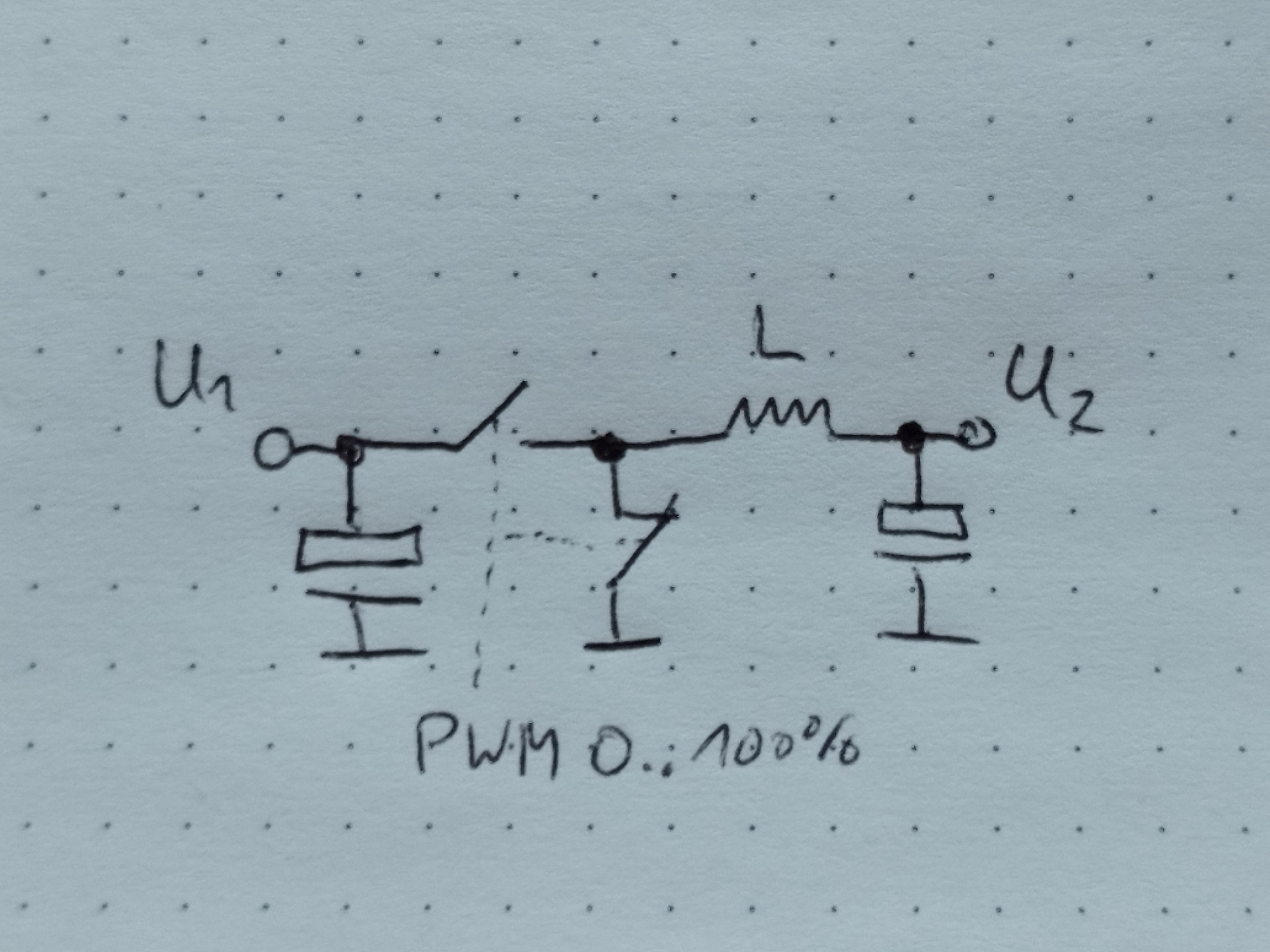

uhi22
Posts: 1244
Location: Ingolstadt/Germany
Has thanked: 245 times
Been thanked: 684 times
Post by uhi22 »
Got it
U2 is the lower side and can be adjusted between zero (if PWM is zero) and full U1 (if 100% PWM)
And if voltage is applied to U2, it will be stepped-up to U1=U2/PWM.

johu wrote: Fri Jan 26, 2024 9:40 am It's just a synchronous converter with IGBTs on low side and high side. Seen from one direction it is a boost converter, seen from the other direction it is a buck converter.
I read in the Gen 2 Inverter wiki page it says:
"The gen 2 can only charge in buck mode. So maximum charge voltage is limited to the rectified AC input."
I think this statement is intended to say that the charger can only charge if one side is higher voltage than the lower one? As I understand the Gen 2, it is both buck and boost at the same time (synchronous), so it's not in buck or boost 'mode', it just has one side higher than the other, the amount set by the duty cycle? I want to make sure I am thinking about it the right way.

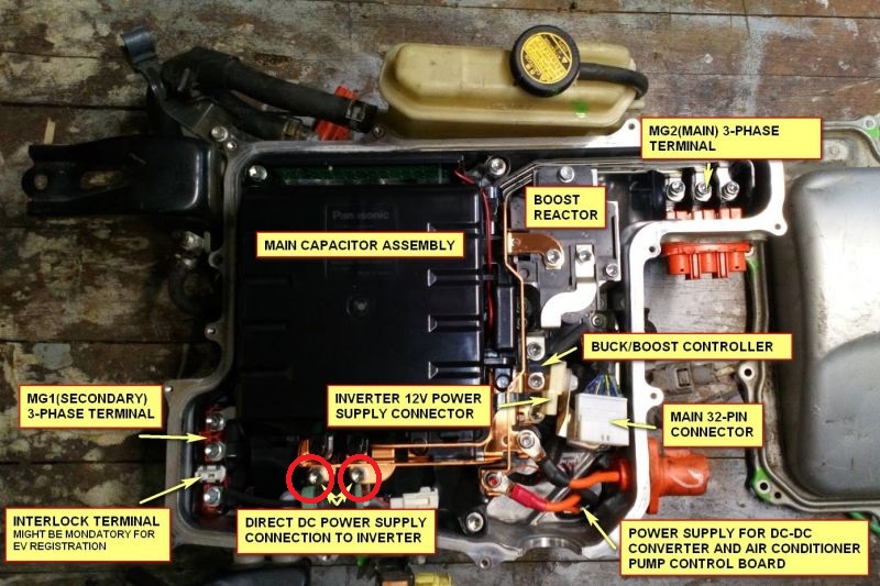

MoonUnit
Posts: 80
Joined: Fri Nov 05, 2021 9:08 am
Has thanked: 33 times
Been thanked: 14 times
Post by MoonUnit »
@MattsAwesomeStuff - I tend to agree, but it's the nature of open source stuff and frustrating to everyone I think. Those that do the creating get pestered and frustrated, those seeking answers find it hard to get them and few people write up their work fully. Let's face it, the write up's not the exciting bit.
This particular project has been rattling around my head for a while but I wasn't sure if it was feasible and I was a bit unsure about asking, in case I was shot down in flames for being too dumb to know, with the inevitable accompanying warning that HV kills dumb people. But Johannes and Uhi were kind enough to provide me with confirmation it should be do-able.
So from here, I think I'll get hold of a gen 2 inverter and try to master its control with some low voltages. If I can, I am very happy to write it up / you are welcome to help me! After that, there are many more stages - get my BMS to communicate its voltage and current requirements to an intermediary device that can control the converter accordingly, and then communicate with Uhi's Clara and Foccci for the actual CCS bit. So quite a lot to do and it will take me a while as I don't have much free time.

Technical question: I still did not get the point, whether my picture above is correct. It has high voltage left and low voltage right, and a single PWM. It is buck from left to right, and boost from right to left. On the other hand, I read "buck mode" and "boost mode", and I read about two (Independent?) PWM inputs. This sounds like there would be two additional switches on the right side of the inductor, controlled by a separate PWM. This would allow buck and boost in any direction. Not sure if this is just a misunderstanding or reality. So the point is: Does the converter have two switches on one side of the L, or four switches, two on both sides of the L?
As some know I used to work at a solar inverter company. When the handbook for a product was to be written the lady from tech doc called me regularly and had me explain how things work. I'd we more than willing to do something similar here, like have a (video) chat with Matt or whoever wants to take it on and talk about assorted topics. I think making the existing stuff more accessible is equally important as developing new stuff.
uhi22 wrote: Sun Jan 28, 2024 7:14 am Does the converter have two switches on one side of the L, or four switches, two on both sides of the L?
Your drawing contains all elements. Only thing missing is the diodes in parallel to them. Lets call the upper switch "Q1" and the lower switch "Q2" and the parallel diodes "D1" and "D2". Here is what it can do:
- Only Q2 switches -> U2 is boosted and flows via the diode D1 to U1. U1 = 1/(100% - x) * U2 . No current can flow from U1 to U2 because diode
- Only Q1 switches -> U1 is bucked and flows via D2 to U2. U2 = x * U1 . No current can flow from U2 to U1 because diode
- Both Q1 and Q2 switch were the signal for Q2 = !Q1 (plus deadtime). Now both equations apply at the same time so it depends on the existing voltage U1 an U2 in which direction current flows. E.g. x=50%, U1=101V and U2=50V then current flows from U1 to U2 because the U1 bucked to 50.5V is greater than 50V (neglecting various voltage drops)

Post by uhi22 »
Improved version of the overview drawing. (Swapped the sides, to have the same orientation as the (original?) Toyota drawing, which was shown in a video linked by Gregg in an other thread, viewtopic.php?p=66375#p66375)
Prius buck boost block diagram
So my lesson learnt is: Even if is called "buck boost converter", it can NOT do buck and boost in the same direction. It is boosting in the one direction, and bucking in the other direction.
For the original use in the car this means, the accu voltage is always less or equal the inverters bus bar voltage.
[Edit] The U1 and U2 are also swapped between my two pictures, to add a little bit more confusion ;-) So the formulas above are not valid for the new picture.

I have a Gen 2 inverter/controller on the way, and some contactors and a precharge resister I got cheaply from Fleabay.
I am going to run the CPWM signal from a Teensy to start with so I've adopted @Cathphish's suggestion to run a low side then high side switch to make sure that if my Teensy crashes, the PWM output going to the boost control module will fail to low, meaning the upper IGBT is on, and the battery voltage will be passed through to the high side without shorting out the battery.

So I have finally got hold of a gen 2 inverter and I've jerry rigged a Teensy to control it. My intention is to only run the buck-boost part of the controller, so I will disconnect the DC inputs to the DCDC converter and I will power the boost module and control it directly through its 16 pin plug, not via the inverter's power plug and main 32 pin white plug.
This means, I think, that the rest of the inverter will not be switched on.
I am not passing AC through MG1, I will be eventually taking DC in from an EVSE and passing it through to my lower voltage battery so I don't need to use the rectifier circuitry, but I assume I need the "smoothing" capacitor buried in the black slab for the boost circuitry to work. So a few questions please before I start:
Where, in the inverter/controller, do I need to connect my EVSE DC in to match the below schematic posted by @Cathphish? I have circled the points in red. I believe these are the bolts circled in red again from the wiki picture?
and
Thanks in advance.
