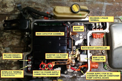

So from here, I think I'll get hold of a gen 2 inverter and try to master its control with some low voltages. If I can, I am very happy to write it up / you are welcome to help me! After that, there are many more stages - get my BMS to communicate its voltage and current requirements to an intermediary device that can control the converter accordingly, and then communicate with Uhi's Clara and Foccci for the actual CCS bit. So quite a lot to do and it will take me a while as I don't have much free time.

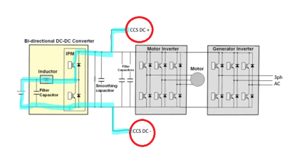

Maybe this is somewhat interesting as it shows that the DC/DC part can be extracted and used separately from the inverter:
Of course this shows an AC/DC variant. Yours would be less complex electrically because there is no current control if you choose so and more complex logically as it needs a foccci

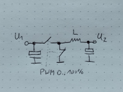

Technical question: I still did not get the point, whether my picture above is correct. It has high voltage left and low voltage right, and a single PWM. It is buck from left to right, and boost from right to left. On the other hand, I read "buck mode" and "boost mode", and I read about two (Independent?) PWM inputs. This sounds like there would be two additional switches on the right side of the inductor, controlled by a separate PWM. This would allow buck and boost in any direction. Not sure if this is just a misunderstanding or reality. So the point is: Does the converter have two switches on one side of the L, or four switches, two on both sides of the L?

As some know I used to work at a solar inverter company. When the handbook for a product was to be written the lady from tech doc called me regularly and had me explain how things work. I'd we more than willing to do something similar here, like have a (video) chat with Matt or whoever wants to take it on and talk about assorted topics. I think making the existing stuff more accessible is equally important as developing new stuff.
uhi22 wrote: Sun Jan 28, 2024 7:14 am Does the converter have two switches on one side of the L, or four switches, two on both sides of the L?
Your drawing contains all elements. Only thing missing is the diodes in parallel to them. Lets call the upper switch "Q1" and the lower switch "Q2" and the parallel diodes "D1" and "D2". Here is what it can do:
- Only Q2 switches -> U2 is boosted and flows via the diode D1 to U1. U1 = 1/(100% - x) * U2 . No current can flow from U1 to U2 because diode
- Only Q1 switches -> U1 is bucked and flows via D2 to U2. U2 = x * U1 . No current can flow from U2 to U1 because diode
- Both Q1 and Q2 switch were the signal for Q2 = !Q1 (plus deadtime). Now both equations apply at the same time so it depends on the existing voltage U1 an U2 in which direction current flows. E.g. x=50%, U1=101V and U2=50V then current flows from U1 to U2 because the U1 bucked to 50.5V is greater than 50V (neglecting various voltage drops)

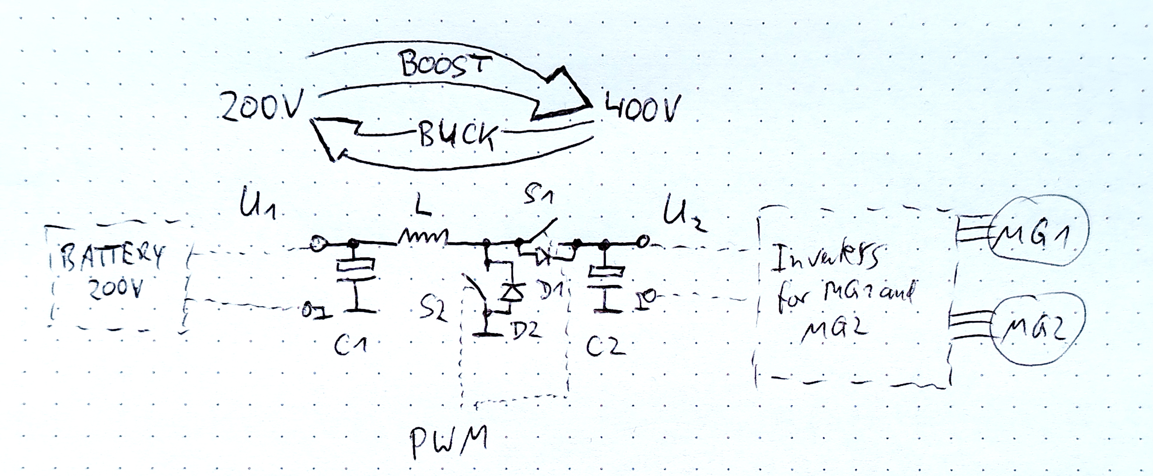

Improved version of the overview drawing. (Swapped the sides, to have the same orientation as the (original?) Toyota drawing, which was shown in a video linked by Gregg in an other thread, viewtopic.php?p=66375#p66375)
Prius buck boost block diagram
So my lesson learnt is: Even if is called "buck boost converter", it can NOT do buck and boost in the same direction. It is boosting in the one direction, and bucking in the other direction.
For the original use in the car this means, the accu voltage is always less or equal the inverters bus bar voltage.
[Edit] The U1 and U2 are also swapped between my two pictures, to add a little bit more confusion ;-) So the formulas above are not valid for the new picture.

So I have finally got hold of a gen 2 inverter and I've jerry rigged a Teensy to control it. My intention is to only run the buck-boost part of the controller, so I will disconnect the DC inputs to the DCDC converter and I will power the boost module and control it directly through its 16 pin plug, not via the inverter's power plug and main 32 pin white plug.
This means, I think, that the rest of the inverter will not be switched on.
I am not passing AC through MG1, I will be eventually taking DC in from an EVSE and passing it through to my lower voltage battery so I don't need to use the rectifier circuitry, but I assume I need the "smoothing" capacitor buried in the black slab for the boost circuitry to work. So a few questions please before I start:
Where, in the inverter/controller, do I need to connect my EVSE DC in to match the below schematic posted by @Cathphish? I have circled the points in red. I believe these are the bolts circled in red again from the wiki picture?
and
Thanks in advance.
