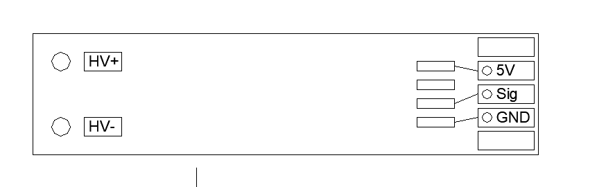

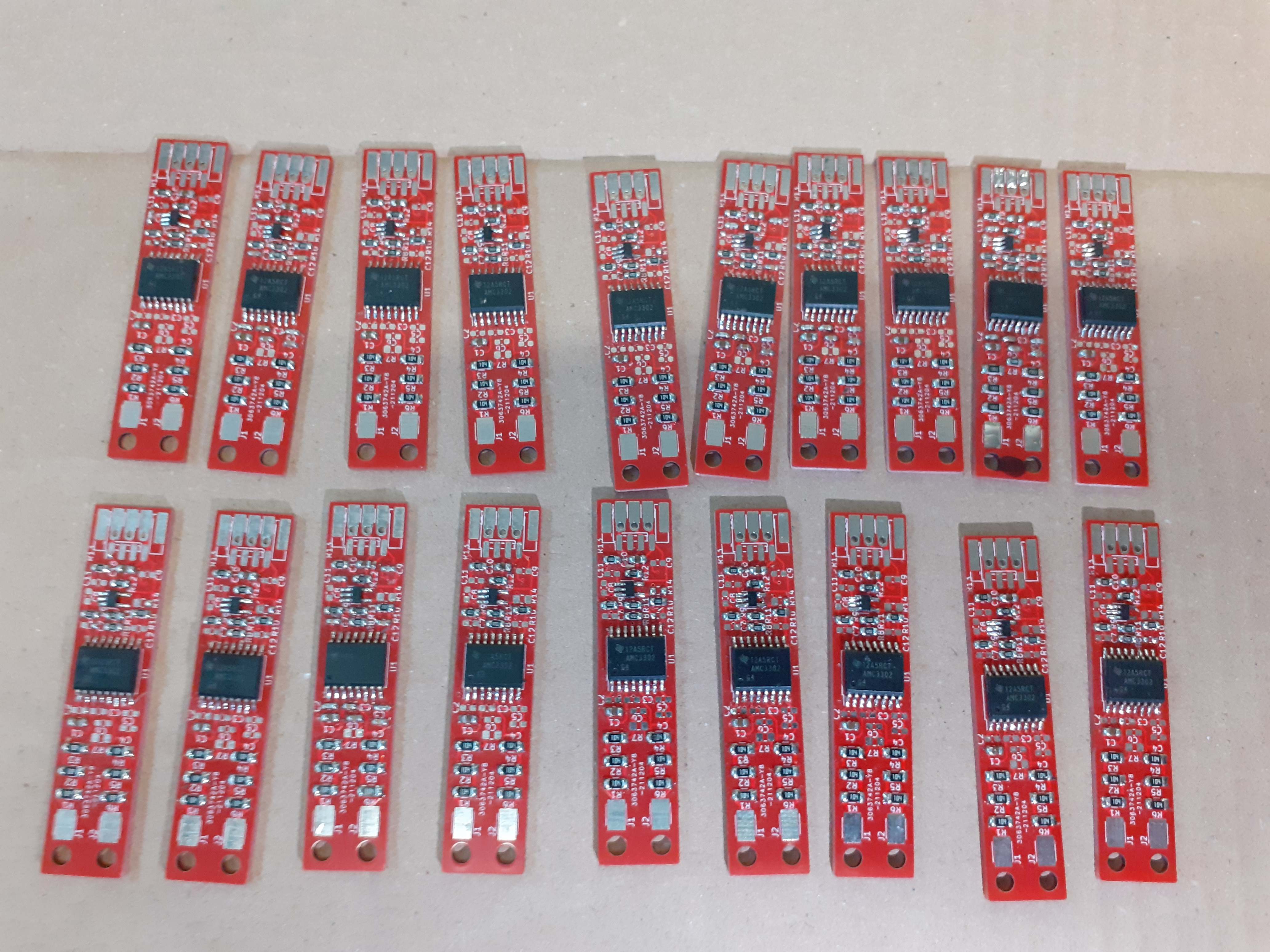

I am selling boards that are required to operate a BMW LIM for DC charging. It measures the voltage at the charge port and provides it to the LIM. 5V are required for operation. e.g. from the Arduino or another controller for the AC charger. The measuring voltage is isolated up to 2000V! On the HV side, a cable with eyelets can be soldered, which are screwed to the contactors, on the LV side soldered cables or a Molex connector can be used. The board is then inserted into the supplied shrink tub. Dimensions 14mm x 64mm
€70.- privat or €83.30 with VAT and invoice / 1 board

I'm thinking what are the other use cases for this board. What's the signal like?

Based on the isolated amplifier AMC3302DWE from Texas Instruments, it outputs an low impedance analog voltage between 1.42V and 4.8V corresponding to the input voltage of 0V-500V. Isolation is over 2000V, power supply is only required on the low voltage side.
