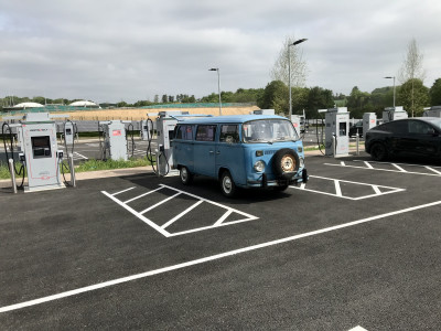

I promise not to document every time I go to a public charger, I realise that could be one of the most tedious travelogues ever. But worth sharing that at Winchester InstaVolt today, they wanted to take my photo and give me a free charge! Think I got lucky because there looked to be a management tour going on of their new 40 charger facility so the marketing dept were up for something more interesting than a Tesla.
Anyway, was happy to chat but declined for the moment. But took her email and promised to go back once I’d passed DVLA checks, so all nice and legal. If anyone else in an interesting EV conversion wants to come along I’ll try to co-ordinate. Not imminent, got a few things to do, but let me know.
Anyway, back to business. Did 25 miles to Instavolt’s Chademo charger. Charged up to 75%, drove 80 miles, and parked up at home after lots of 50 - 60 mph driving with 9% / 10Ah remaining
On that basis, it would be 118 miles range with zero left.
But this is with my 40kWh BMS on a 60kWh battery. If (still to be confirmed I think) I could expect 30% more if it was a 60kWh BMS the range would be 150 miles. That’s more what I was hoping for.
The final LeafSpy (it’s zoomed in below, so looks worse than it is) once back home shows 3.60 for the lowest cell and 347V for the pack. I think I’m right in saying that I’d expect to see the low cells much lower than that on a close to empty battery. So gives me hope that my range can go closer to the 150 than 100. But whether that is possible with the current BMS is something I haven’t dared to push yet.
I know there are Leaf BMS reflashing efforts ongoing in another forum. But if I was confident a CANBridge might do the job, I’d probably be happy to go for that to avoid the risk of clumsy me bricking the BMS.
Go on, admit it, you do really want to see me parked at another charger :)

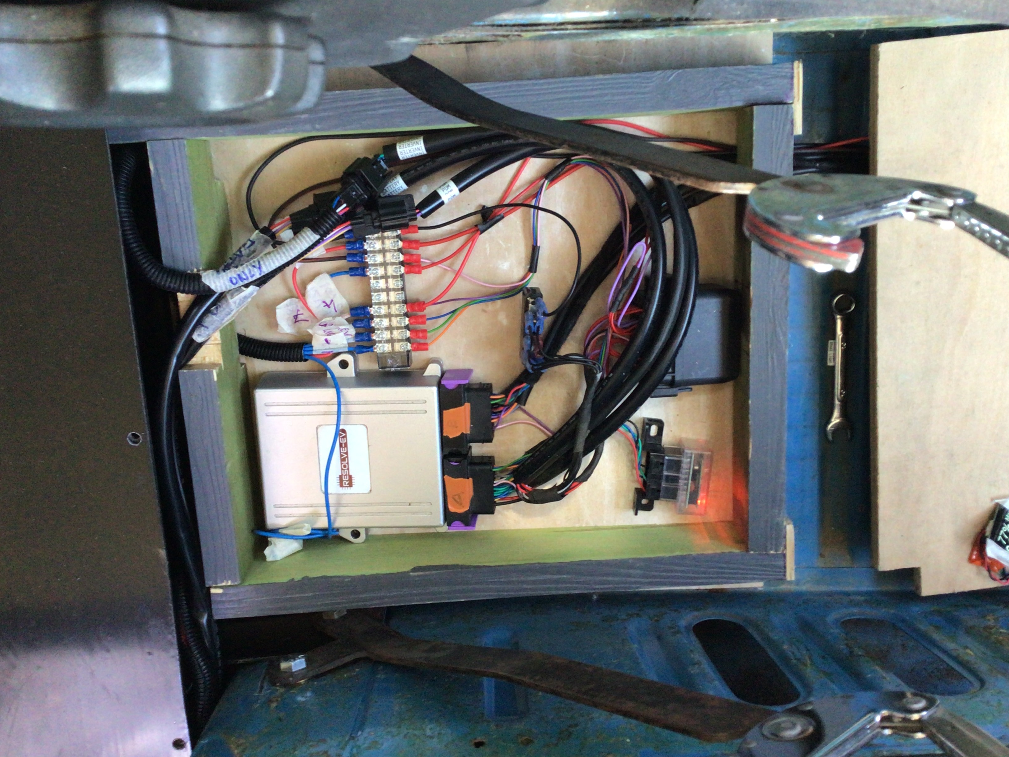

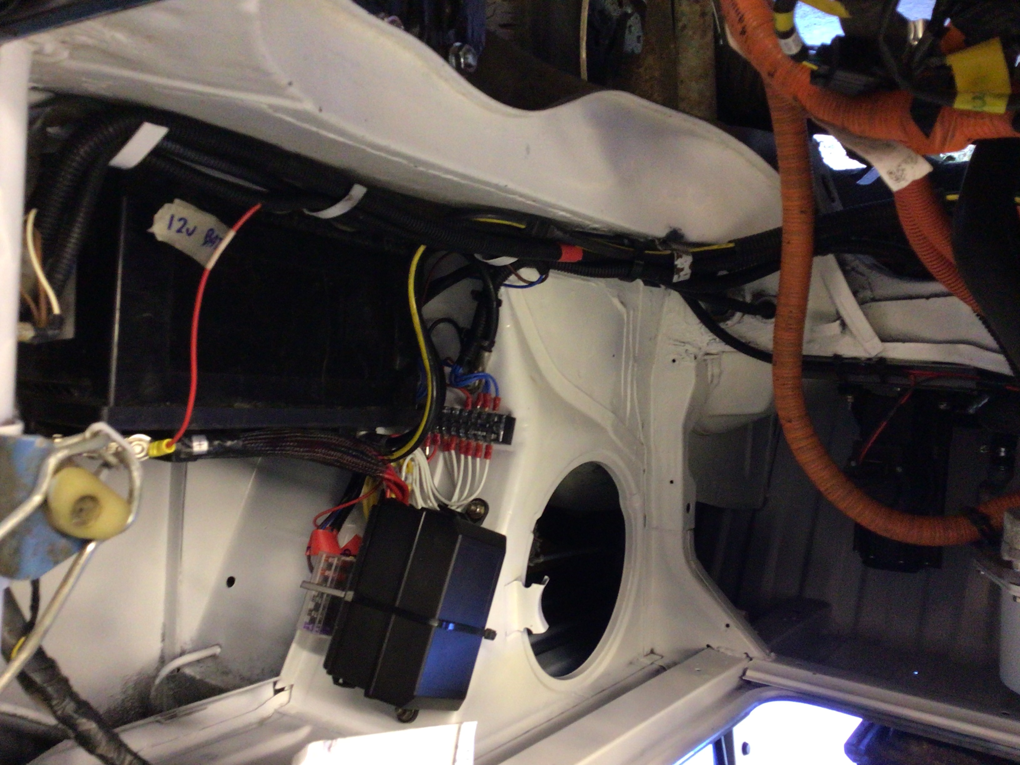

So CANbridge isn’t the answer. Investigating 62kWh BMS.
In other news, cable tidying…
1) Engine Bay now much nicer… (aaargh, upside down!)
2) VCU wiring up at the front. Getting there, still a bit to do on the driver controls part which are still a bit temporary.
