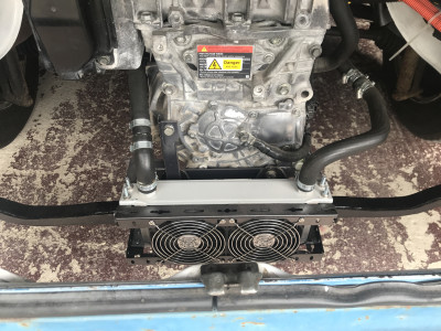

1) Engine Bay now much nicer… (aaargh, upside down!)

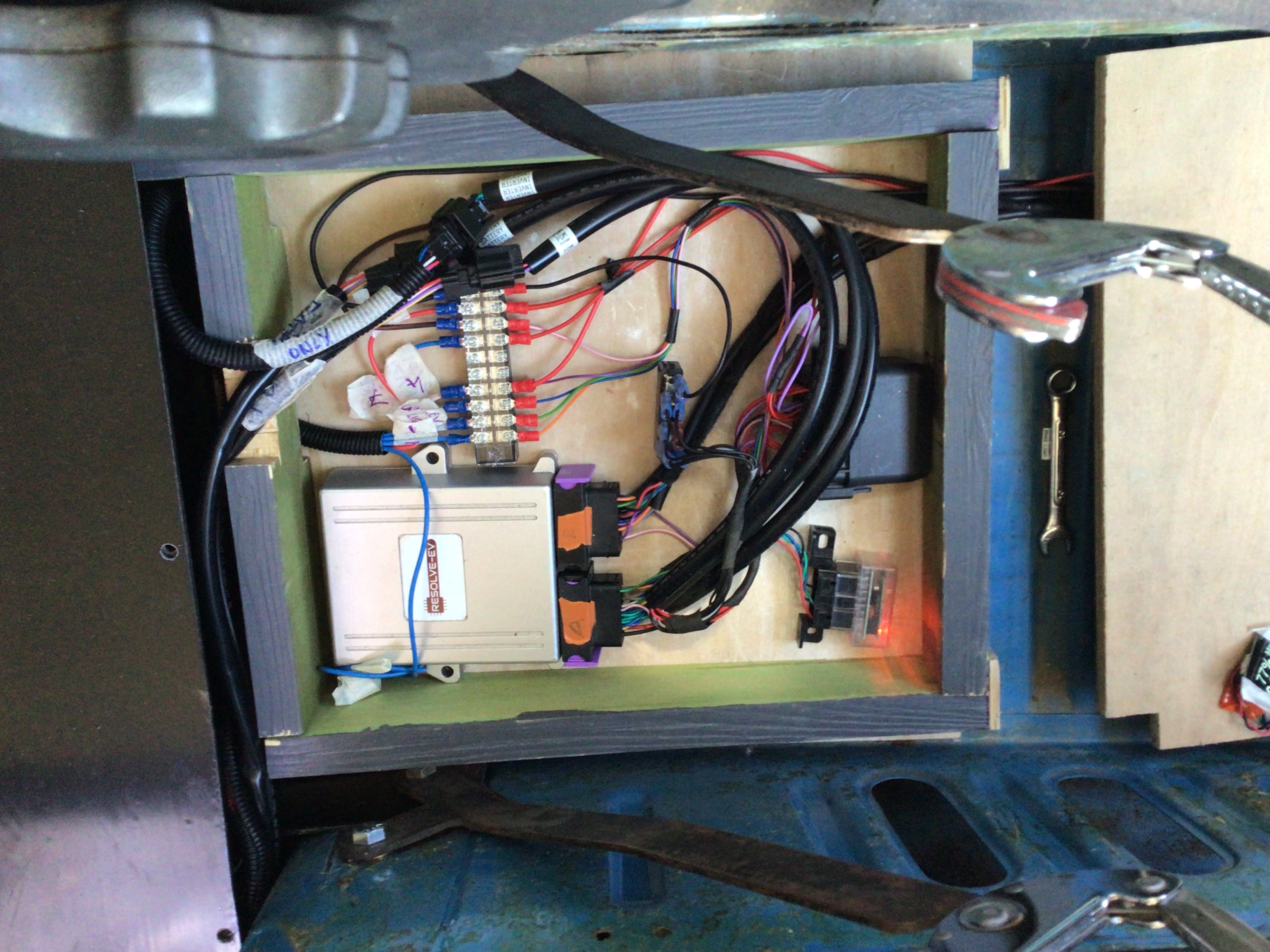

2) VCU wiring up at the front. Getting there, still a bit to do on the driver controls part which are still a bit temporary.

We’re gonna need a bigger… radiator.
Up til now the motor temperature in my conversion reported by LeafSpy hasnt gone over 70deg C. In a not very scientific comparison test, a few weeks ago I drove our standard issue Nissan Leaf for 30 minutes down the motorway at 70mph to see what ‘normal’ should look like, and got a similar temperature.
On Friday, with outside temperatures of 31 C, and after driving 70 miles, the motor temperature hit 80C in the VW!
If anyone knows the upper limit for Leaf motor stack temperature, it would be good to hear. I knew the rad I used was a dinky little thing, but perhaps it’s not able to do a good enough job for the hotter days. Or maybe I’m still within acceptable limits? I’m a bit in the dark on this one.
But in good news, the prime directive of getting to and from music festivals has been achieved. Drove 140 miles there and back, so did it on a single charge with 15% usable battery capacity remaining. Loaded up with 1 wife, food, drink, chairs, table and assorted paraphernalia :)
Romale
Posts: 532
Location: Romania
Has thanked: 316 times
Been thanked: 85 times
Re: [FIRST DRIVE] Leaf to VW Type 2 Campervan
Post by Romale »
this temperature is quite normal, there is no need to worry.
for the inverter, anything above 80° is critical, and the motor can tolerate 130° in long climbs.
evil neodymium :twisted:
