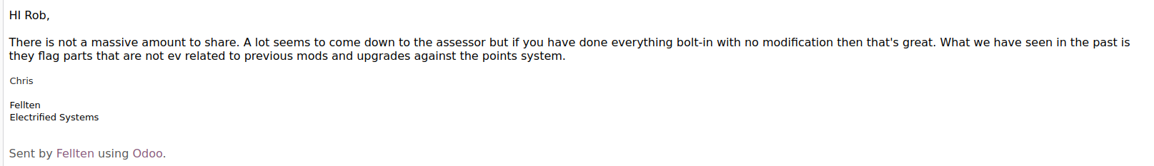

Well this is the rsponse i got from chris on what the issues are but no new information really
Re: Registering and changing tax class of an EV conversion in the UK
You are write it's about the point system, as all the questions, asked was about modifying chassis and what was left of the original vehicle
