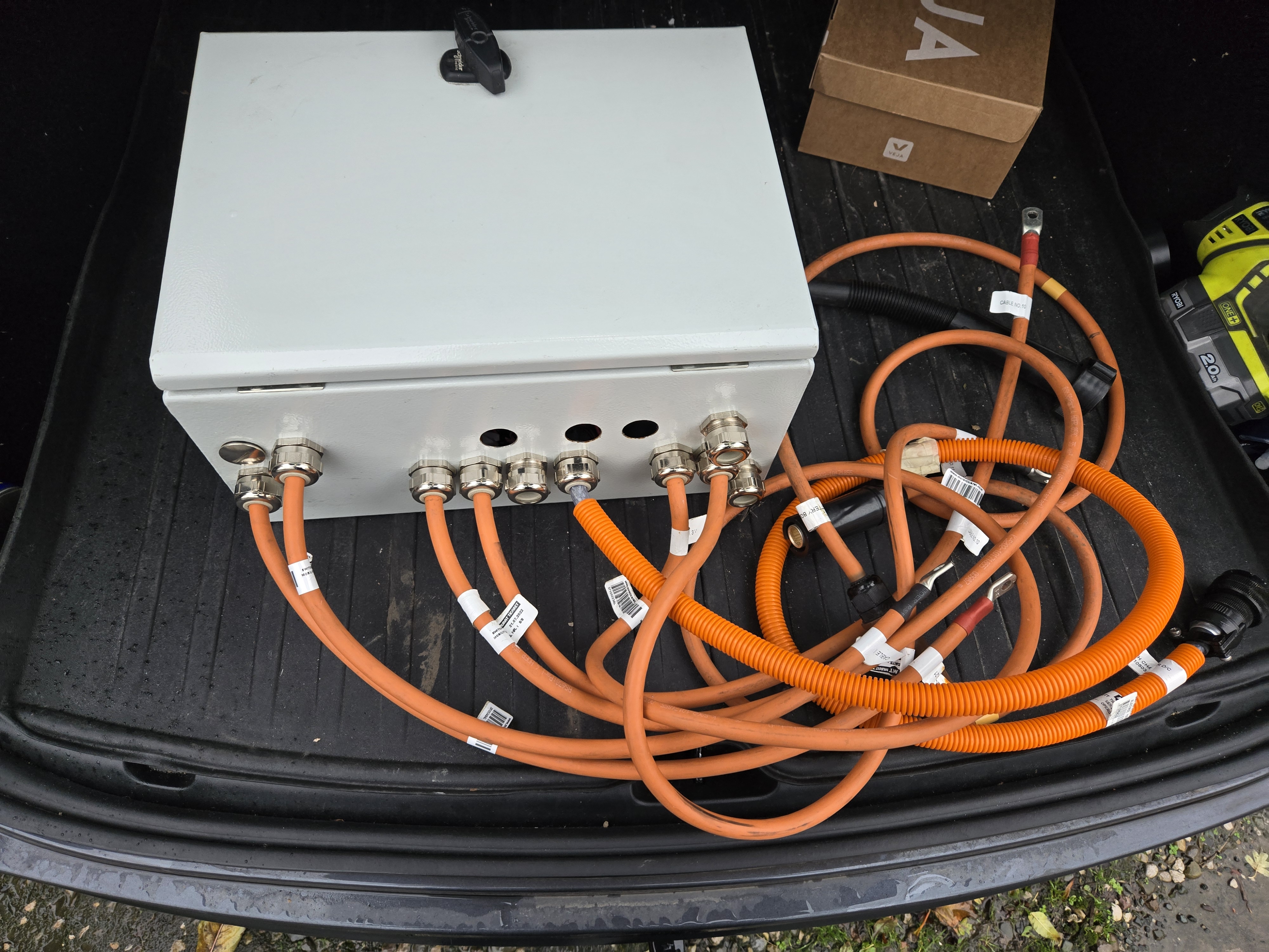

As part of the my project collection process I was looking for some kilovac ev200 contactors on ebay the other day and managed to bag a nice schneider electric metal contactor box stuffed with half a dozen or so kilovacs, standoffs, fuses and glands from a UK built EV bus. A bit overkill number of contactors for my project but good for me to have a few spares. The EV bus (as in autobus) had 4 battery banks apparently.
Pretty pleased with the box (with lockable key). Very well made unit.

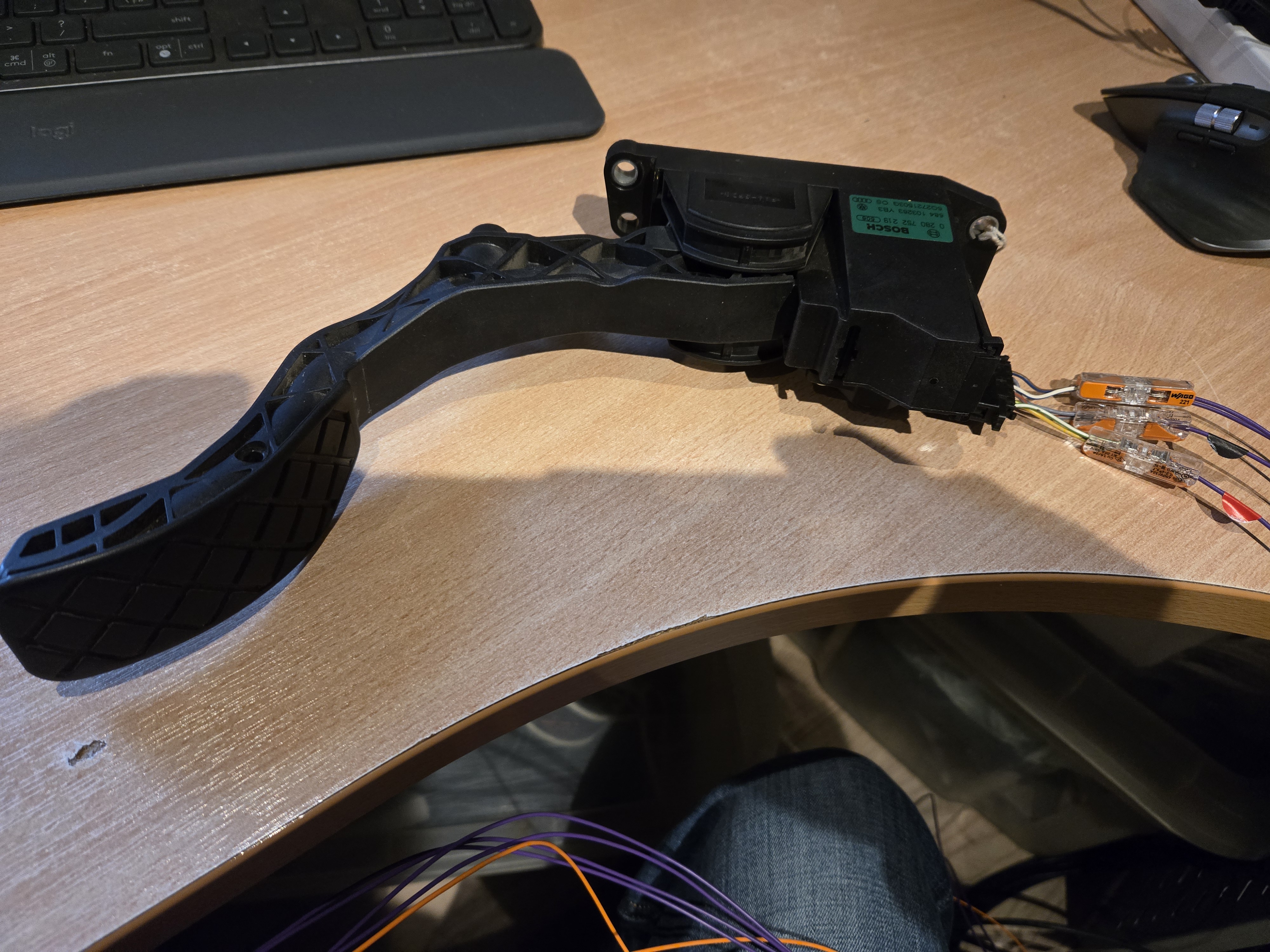

I've been playing with a VAG SEAT 2005 Pedal which I bought el cheapo on ebay - while I had some time free over the festivities working out the pinout from the pedal with a multimeter. Hoping to test it with my zombieverter at some point.
Part number relates to a few cars during the 2000-2010 age. SEAT Ibiza Accelerator Pedal 2005 0280752219 684103263 6Q2721503G VW Audi. Such as the VW Fox and VW Polo.
Volkswagen:
Polo Mk4 (9N, 9N3) (2002–2009)
Fox-EU (2005–2012)
Polo Classic/Sedan (various years between 2003 and 2010)
Skoda:
Fabia Mk1 (6Y) (1999–2007/2008)
SEAT:
Ibiza Mk3 (6L) (2002–2010)
Cordoba (6L) (2003–2009)
Technical Specifications
Type: Electronic pedal with integrated module (Potentiometer).
Connector: Typically features a 6-pin plug.
Common Alternate/OEM Numbers: 0280752219 (Bosch).
Configuration: Fits both Left-Hand Drive (LHD) and Right-Hand Drive (RHD) vehicles depending on specific stock, though many listed parts are RHD
specific.
Here is what I have on the female end of the plug with the 2 locating lugs on the bottom eyes facing towards the pedal. I had the pigtail with the plug so that might come in useful:
Pin Colour Function
1 White/Green +5 V Sensor 1
2 Yellow/Green +5 V Sensor 2
3 Grey/Red Ground Sensor 1
4 White/Blue Signal Sensor 1
5 Grey/Blue Ground Sensor 2
6 Brown/Blue Signal Sensor 2
And here are my results on my meter after wiring in 5v at 30mA on a bench supply..
Pin Colour Observed behaviour
1 White/Green tied together pin 1 and 2 (+5v)
2 Yellow/Green tied together pin 1 and 2 (+5v)
3 Grey/Red tied together pin 3 and 5 (-0v)
4 White/Blue 0.8 V → 4.5 V (signal)
5 Grey/Blue tied together pin 3 and 5 (-0v)
6 Brown/Blue 0.4 V → 2.2 V (signal)
I hope this might help someone.

Had a look at Gregski's (thank you for that) youtube post:
https://www.youtube.com/watch?v=JLN8A1YEx6M
about calibrating the pot values for the zombieverter with my throttle pedal.
Here are my values:
Pot 1 min: spot value 308: set my parameter to 320
Pot 1 max: spot value 156: set my parameter to 166
Pot 2 min: spot value 1855: set my parameter to 1845
Pot 2 max: spot value 862: set my parameter to 852
Here is an image of said pedal loosely wired in with some inline wego 221s (for testing out purposes only):
As I have a slanted floor half way in the floor/bulkhead area of my car where the throttle sits I aim to offset it towards me by bolting the pedal to some 60mm ally box section I have lying around which I will then bolt to the bulkhead using 6mm bolts. This will offer the pedal box enough to not hit the floor before getting full throttle for my situation. Access to bolts fixings/nuts will be by using a hole cutter in the side of box section to get a spanner/fingers in to bolt the pedal up to the box section. The box section to the bulkhead.

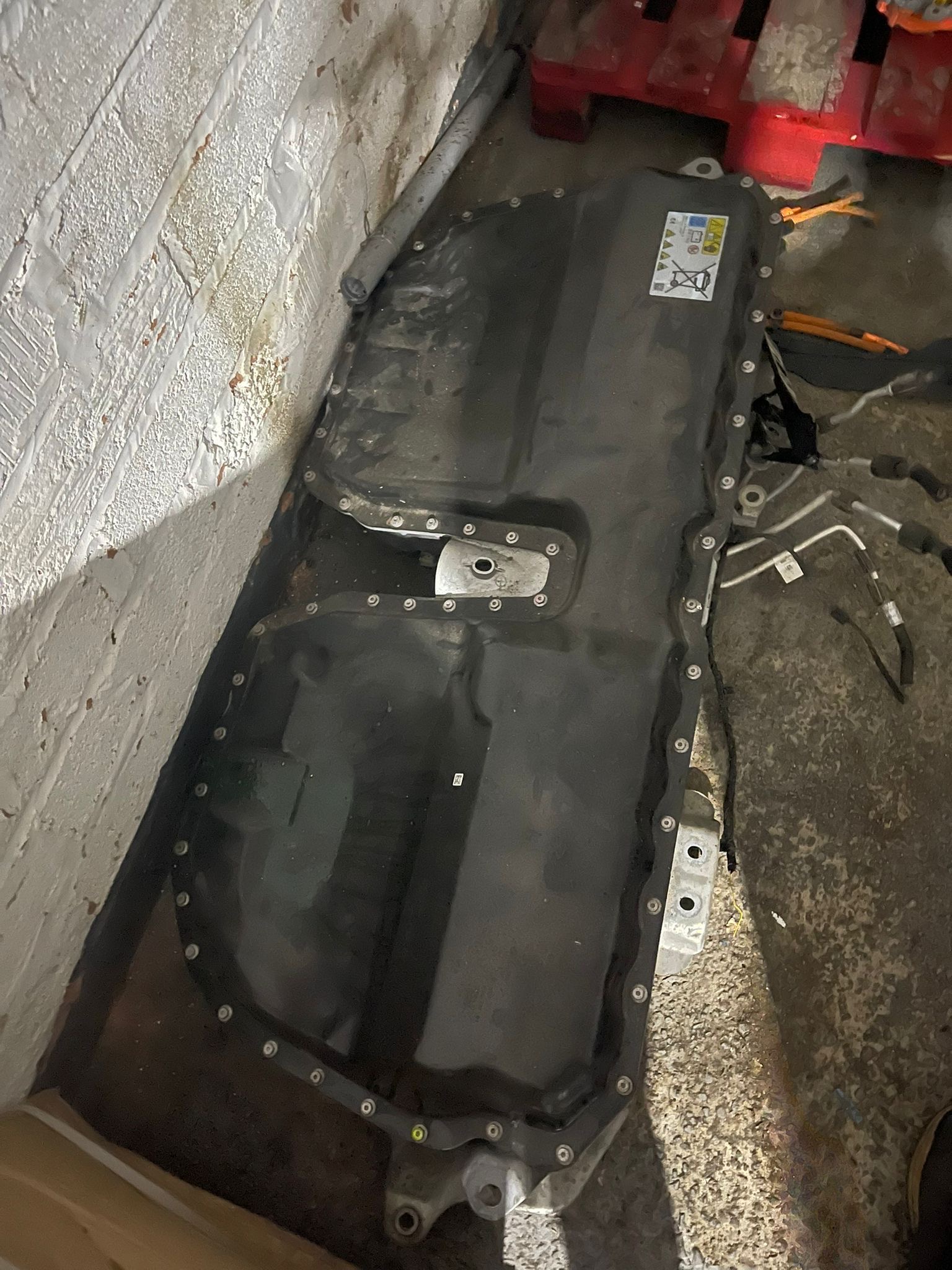

Hi, have you managed to do a full tear down of the battery pack into individual modules? Have you located the Sbox?manifold wrote: ↑Wed Oct 22, 2025 9:06 pm a link here refers to the SME module. Quite a few of these components in this box appear to be from this company:
https://www.vitesco-technologies.com/en ... stem-(bms)
CSC module:
https://www.vitesco-technologies.com/en ... cuit-(csc)
Love to see more photos and any more information.
I couldn’t get the links posted to work

Thanks, it would be brilliant if you could get one module removed and work out how the positive and negative connectors disconnect as they are quite different from the SP41 battery.
I am considering buying one of these packs and your help would be invaluable.
Re: [WIP] Midas Gold Mk3 Coupe - mitsubishi outlander project

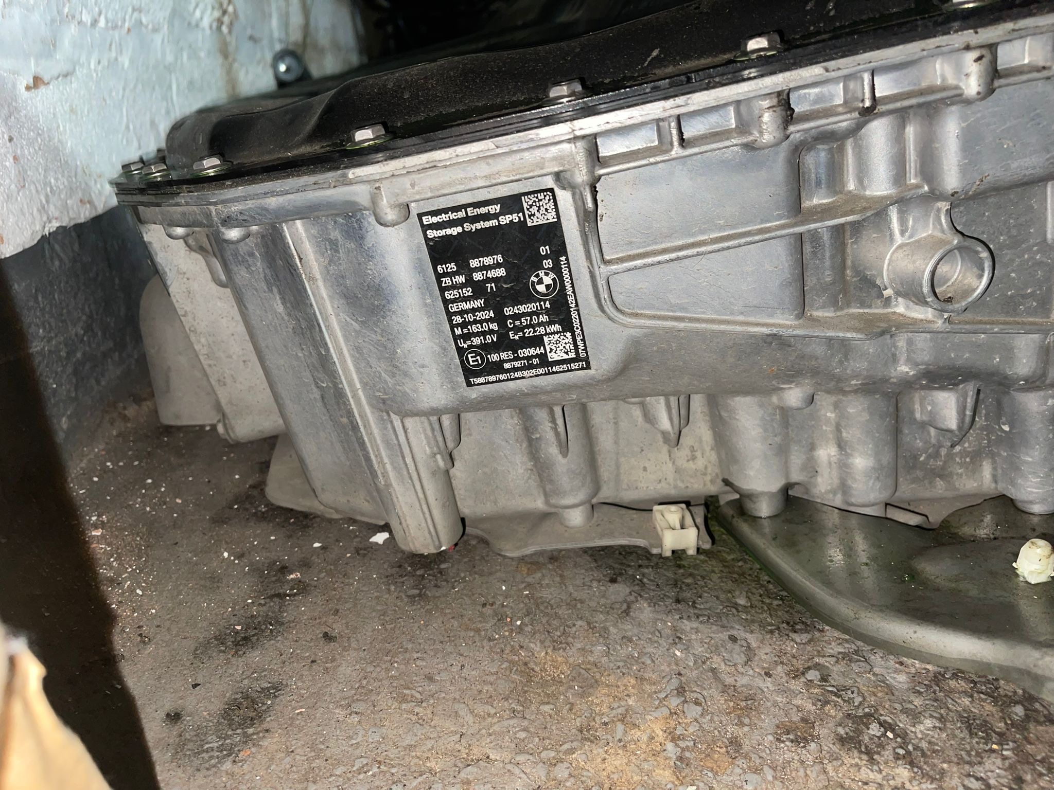

No probs. Looks like just a socket is used to remove the terminals. There was a youTube video of a battery pack being stripped down but looks like it has been removed sadly.

some specs I picked up from AI (caveat not fully checked):
The LCI facelift (2022+) has a larger battery.
BMW 330e Battery Evolution:
Generation Years Gross Capacity Usable Capacity
Pre-LCI 2019-2021 12.0 kWh 11.1 kWh
LCI (facelift) 2022-2024 22.3 kWh 19.5 kWh
Second facelift 2024+ 22.3 kWh 19.5 kWh
Your 21 kWh figure is close to the 22.3 kWh gross/total capacity of the LCI battery pack. The usable capacity is 19.5 kWh.
Key LCI battery changes:
Part of fifth-generation BMW eDrive
Higher energy density
Same physical size/weight as earlier 12 kWh pack
Electric range increased to 53-61 km (33-38 miles)
Located under rear seat/trunk floor
So your SP51 330e Touring — if it's a 2022+ LCI model — has the 19.5 kWh usable / 22.3 kWh gross battery
