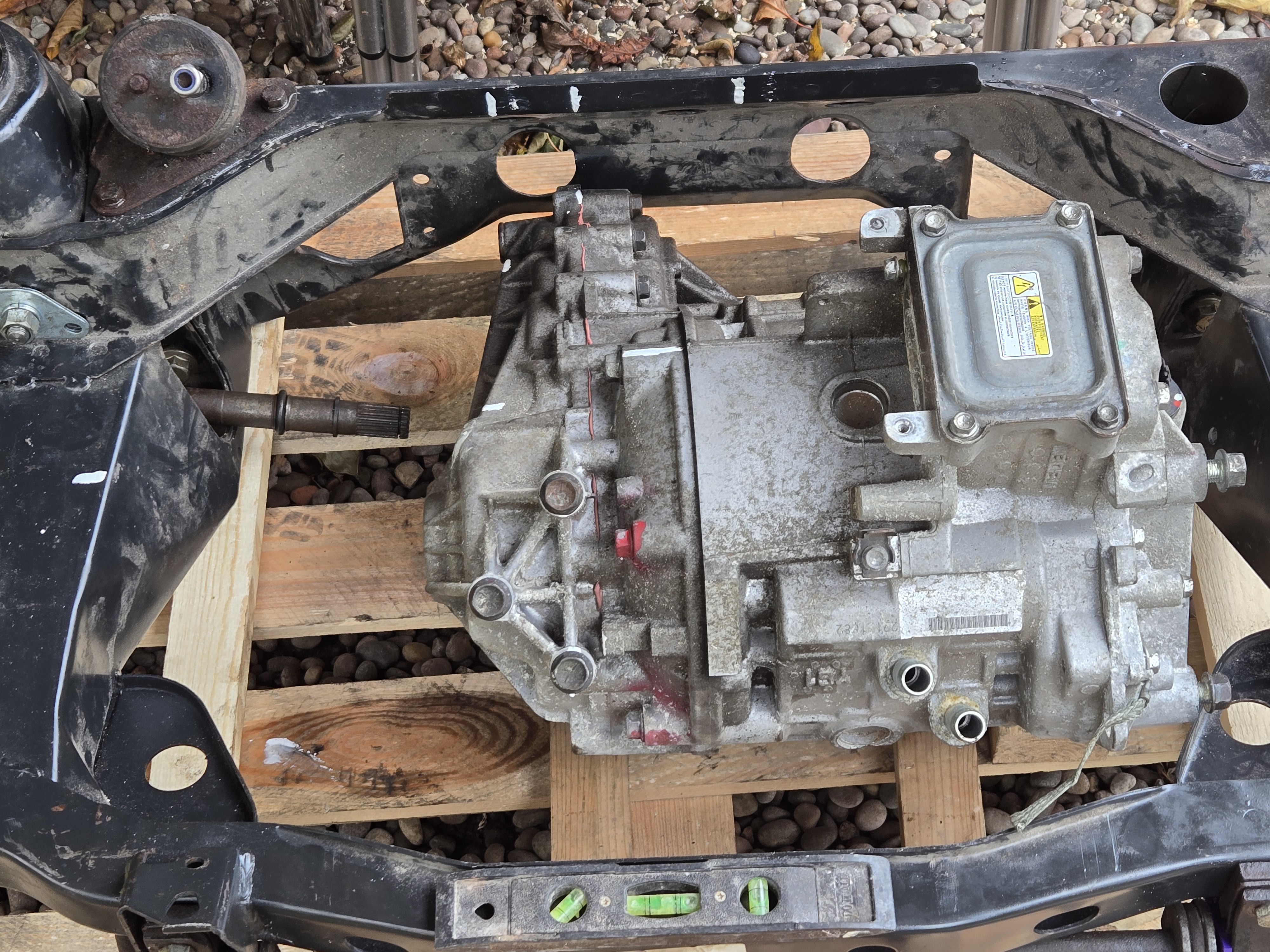

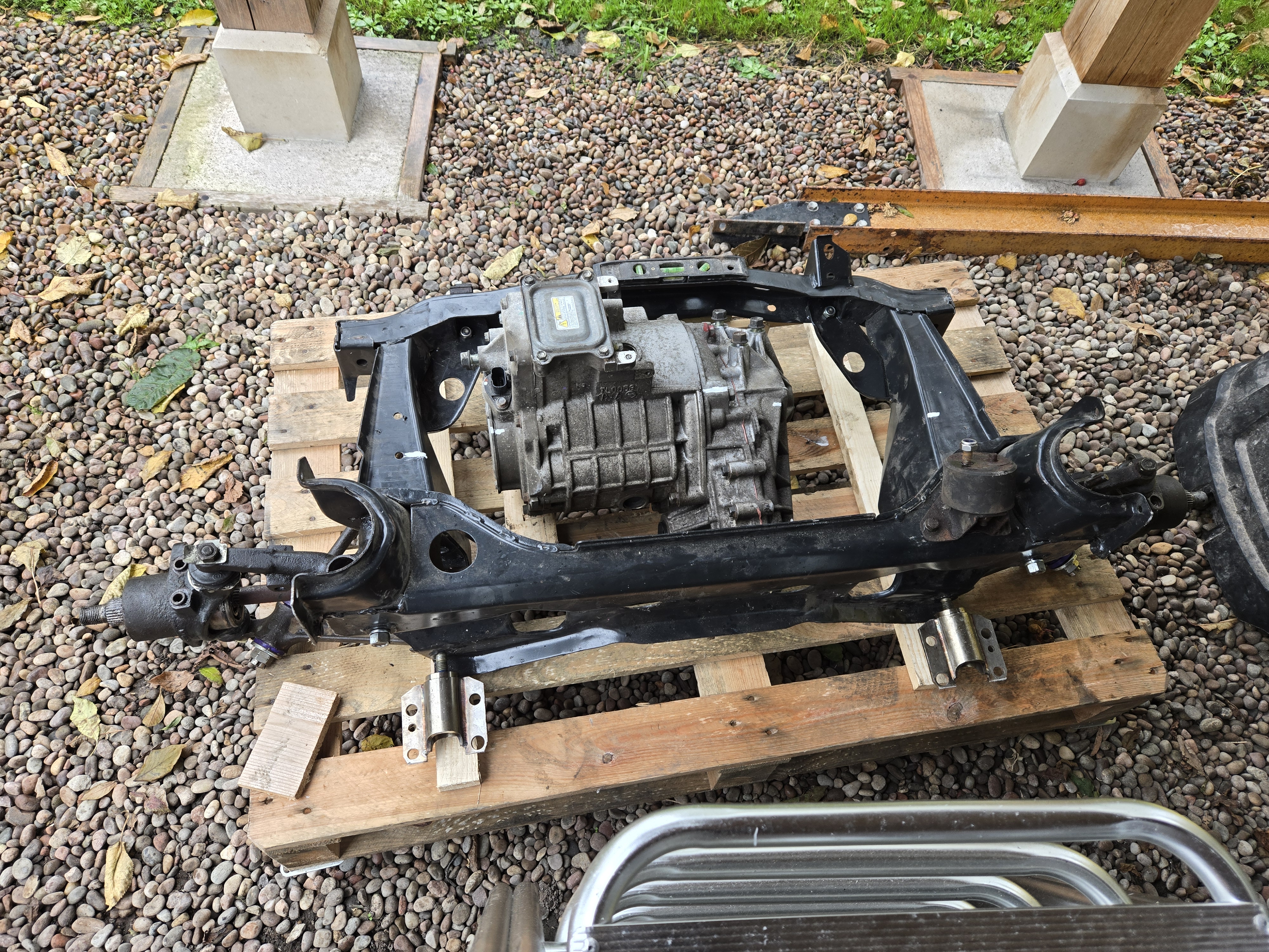

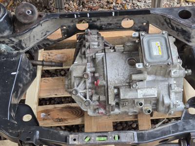

Mitsubishi Outlander PHEV rear drivetrain came today so I offered it up to a spare NOS metro A series engined subframe I had in stock to see if it fits. I think thats a yes, looking at these images. Even the driveshaft angle is the same (or maybe even better actually as the offset is less than the OEM ICE motor):
And a comparison to swindons ev mini kit

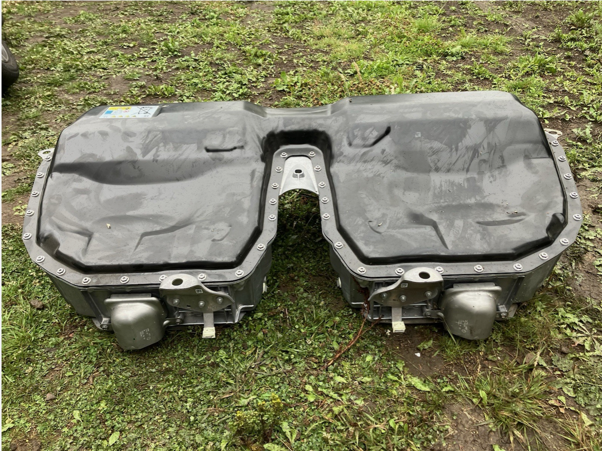

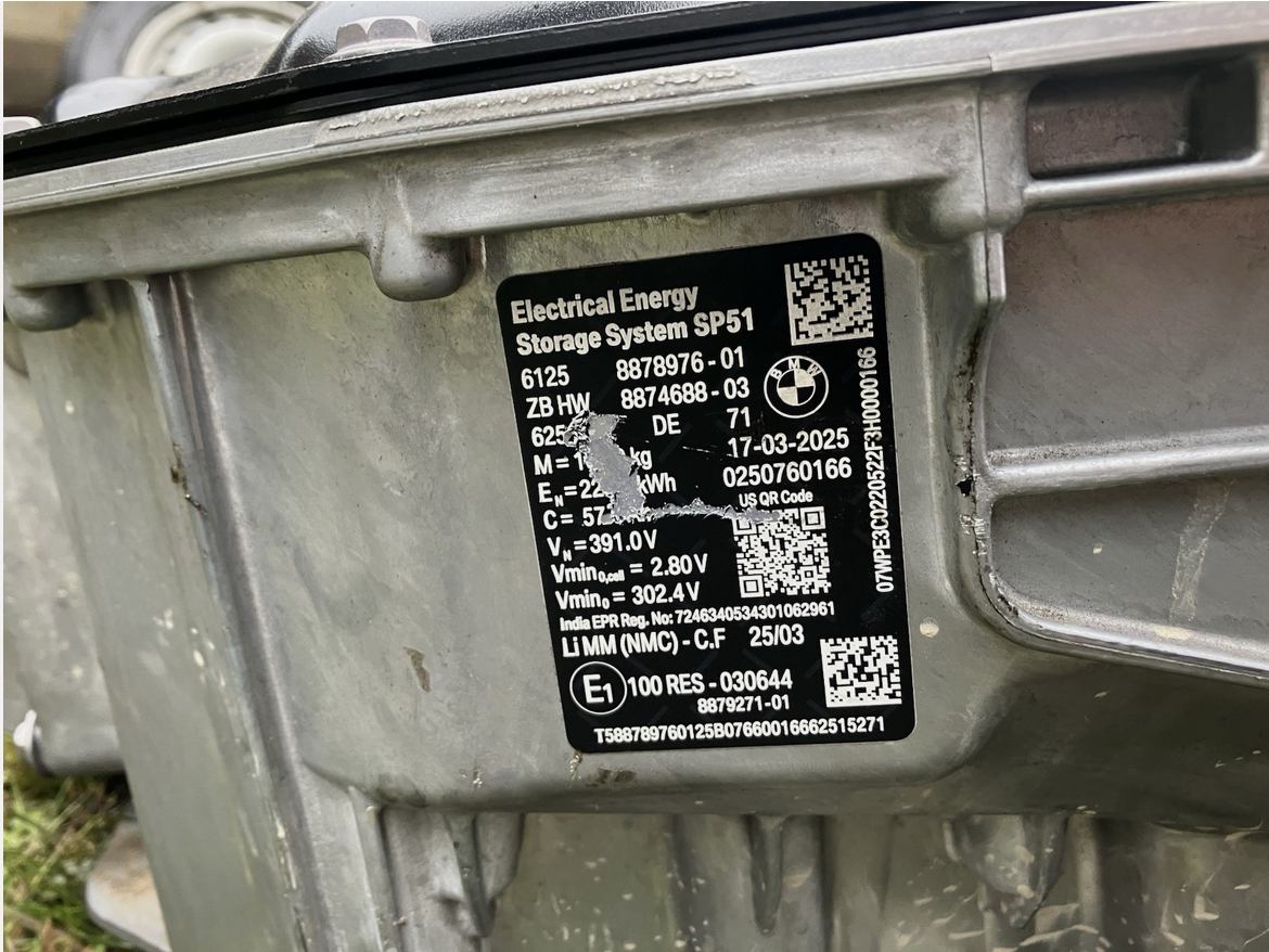

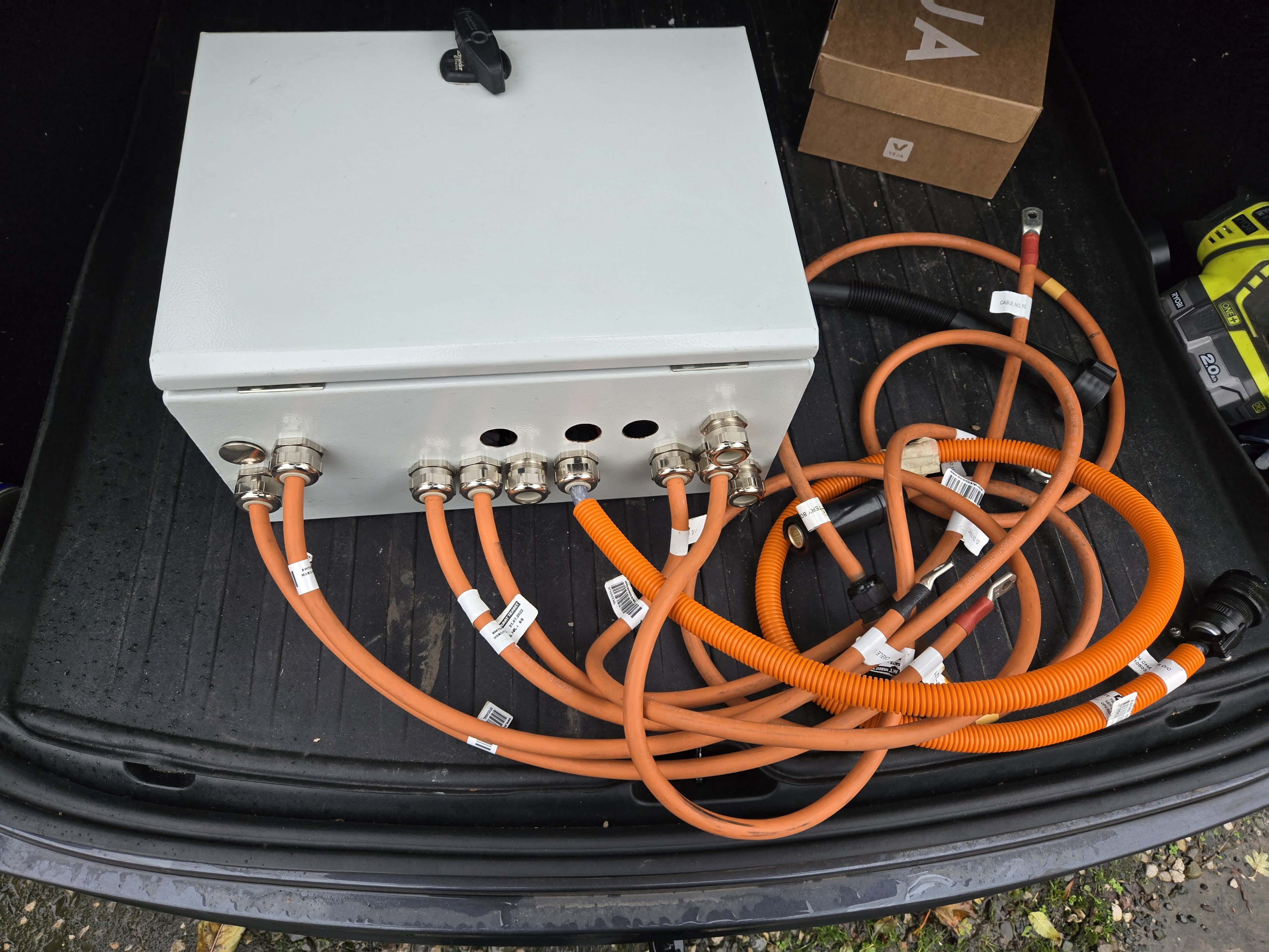

managed to source a newer type BMW SP51 battery. seems these are coming in around 22kW/h 8878976 2022-2025. hoping to get a decent bit of range with it.
Posts: 2962
Has thanked: 328 times
Been thanked: 847 times
Re: [WIP] Midas Gold Mk3 Coupe - mitsubishi outlander project
No idea what kind of BMS is in the SP51. Please take plenty of pictures for us.

Absolutely will do Tom. Looks slightly different. Seems to have a steel top lid.

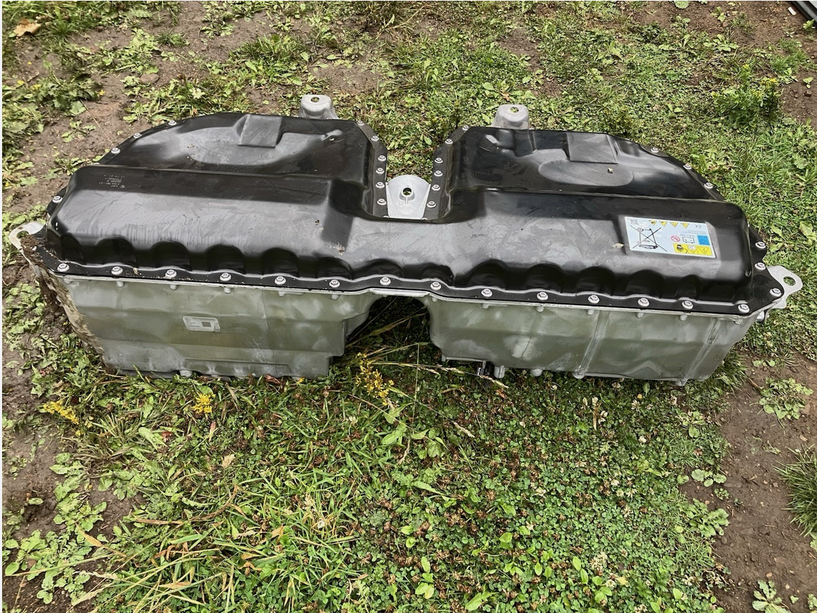

Post by manifold »
Heres a starter for ten of outside appearance before I get at it. Came from an g21 330e estate touring I think.

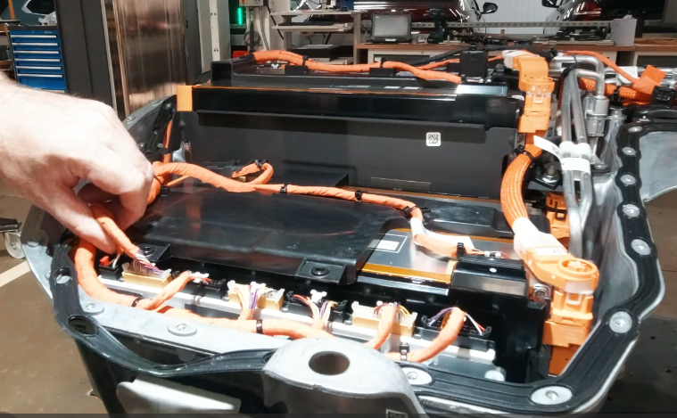

I think looking at the spec the safety box is same as earlier ones when I checked out the spec on some bmw parts suppliers. Wont know till I dig into it.
https://www.sytnerstevenagebmwparts.co. ... 44217.html
heres one on youtube stripped down:
https://www.youtube.com/watch?v=4m67B1P0Glg&t=237s
battery terminal connectors look a lot different in that video.

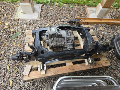

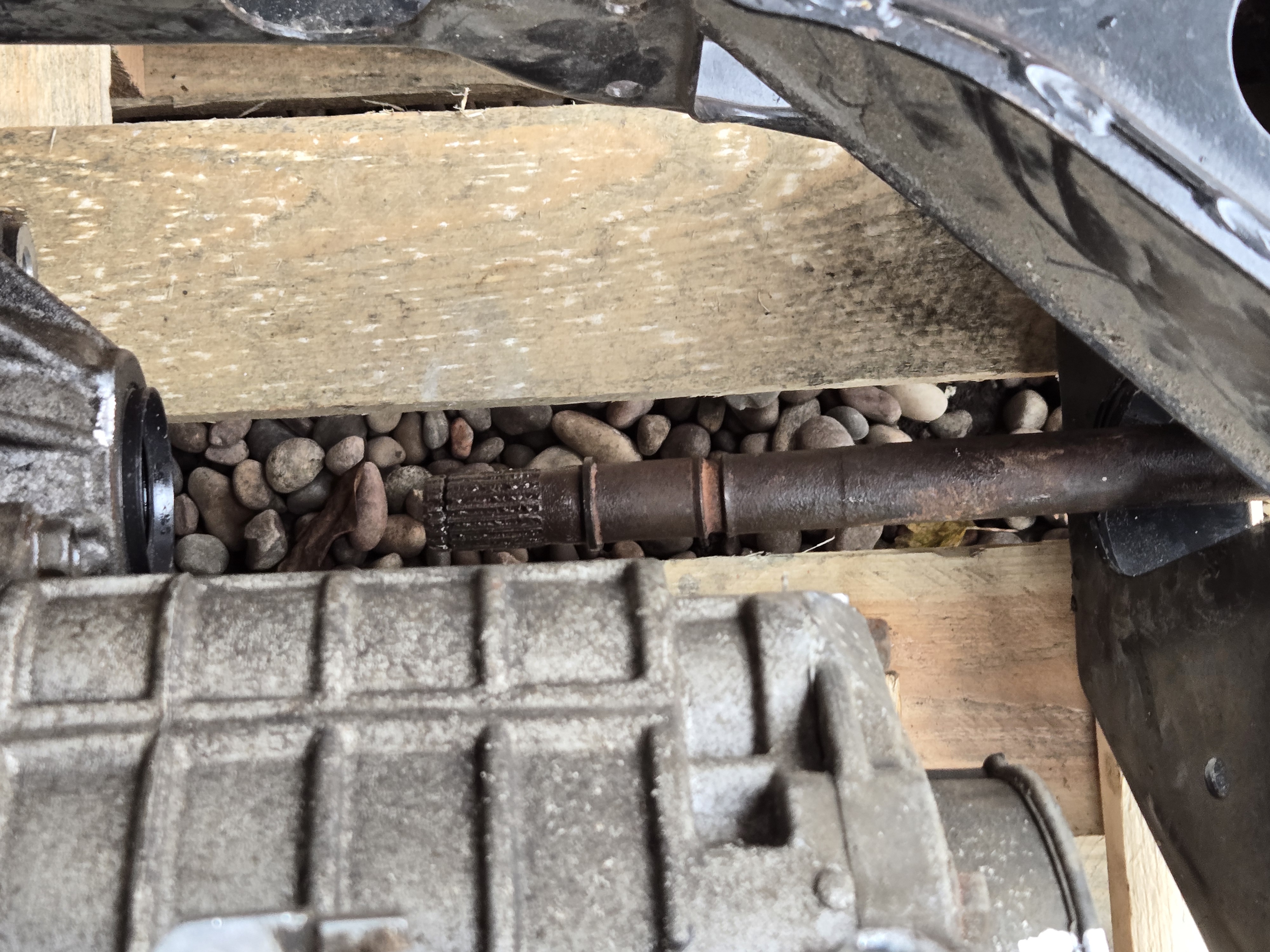

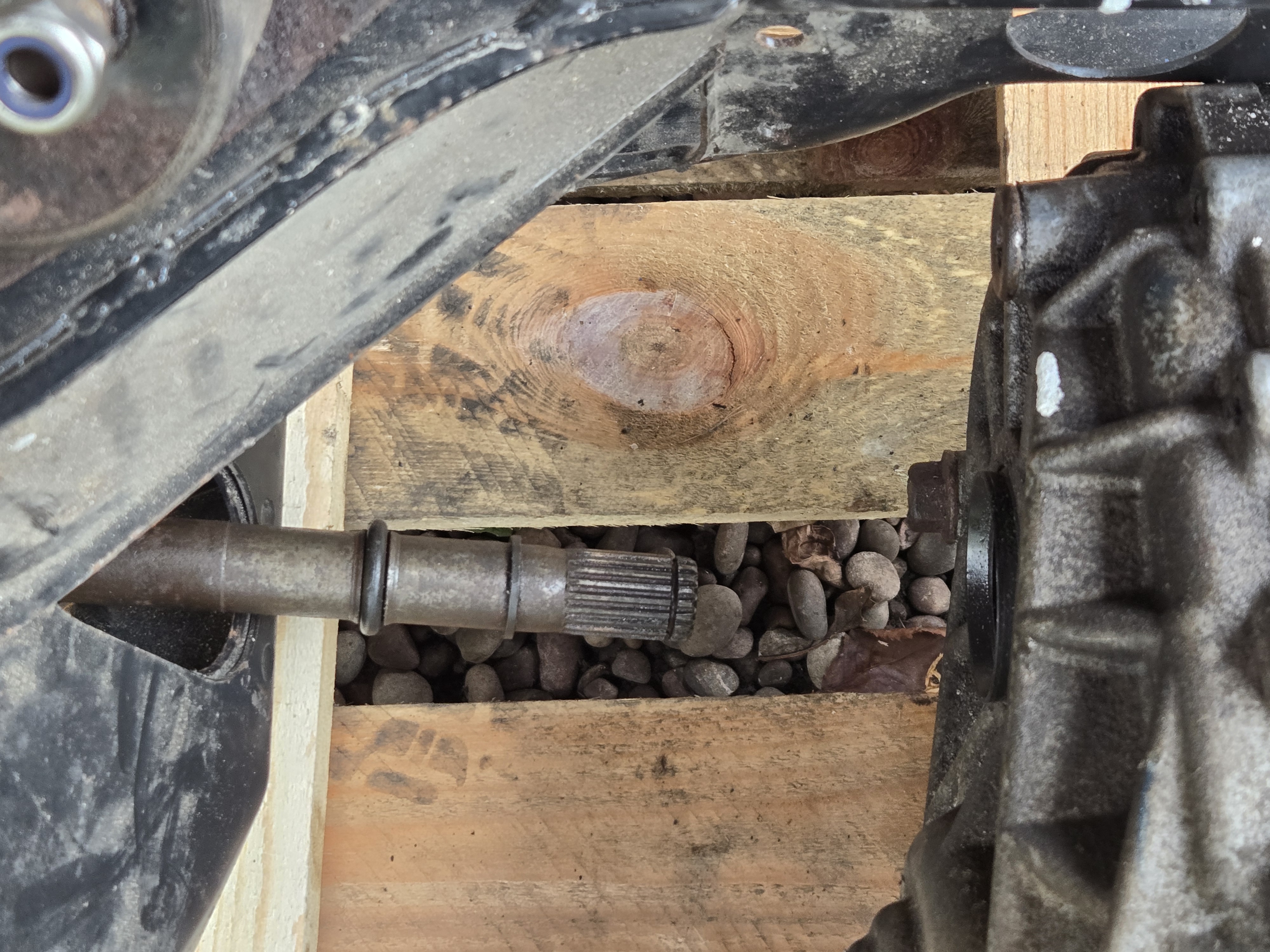

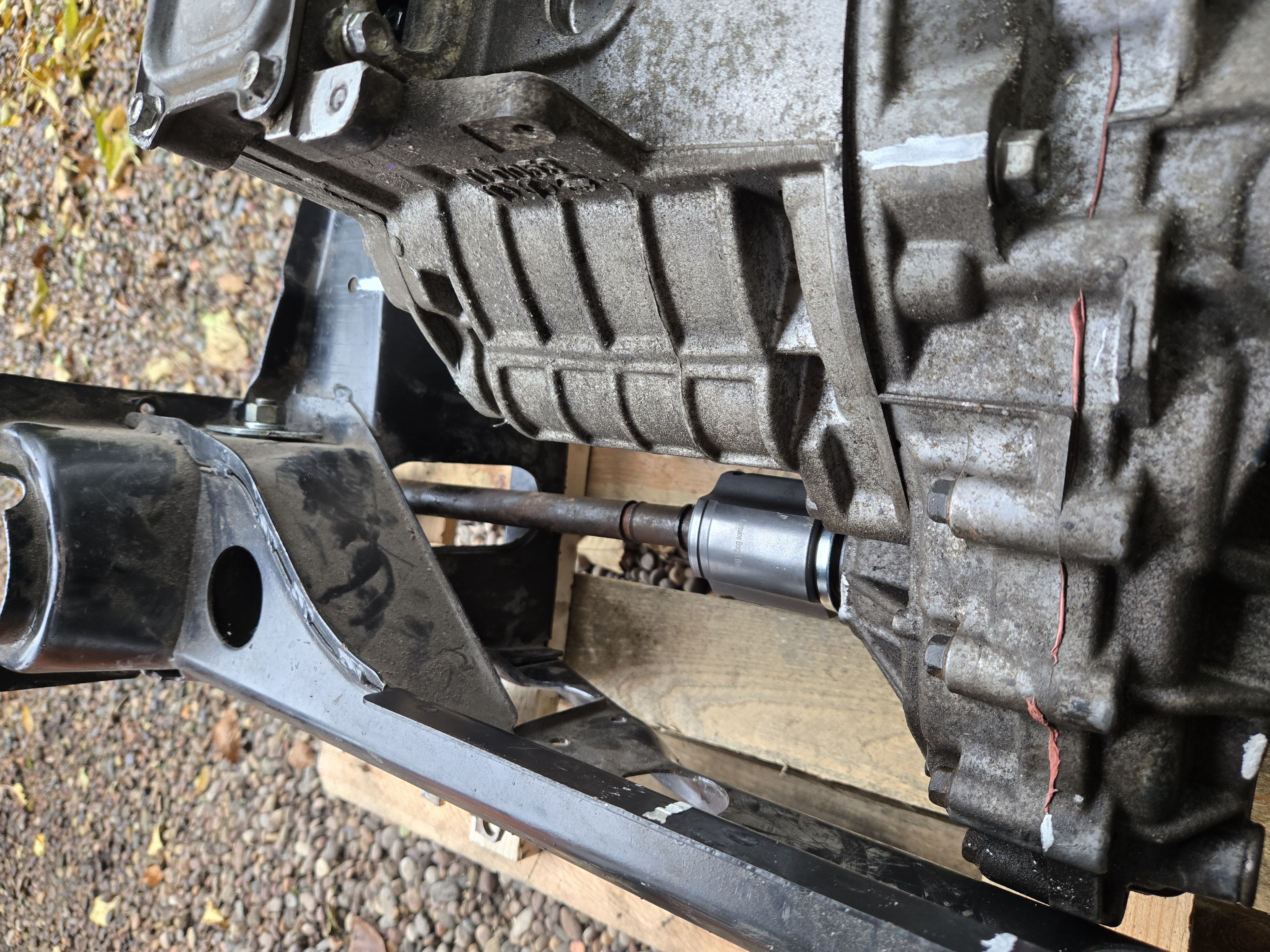

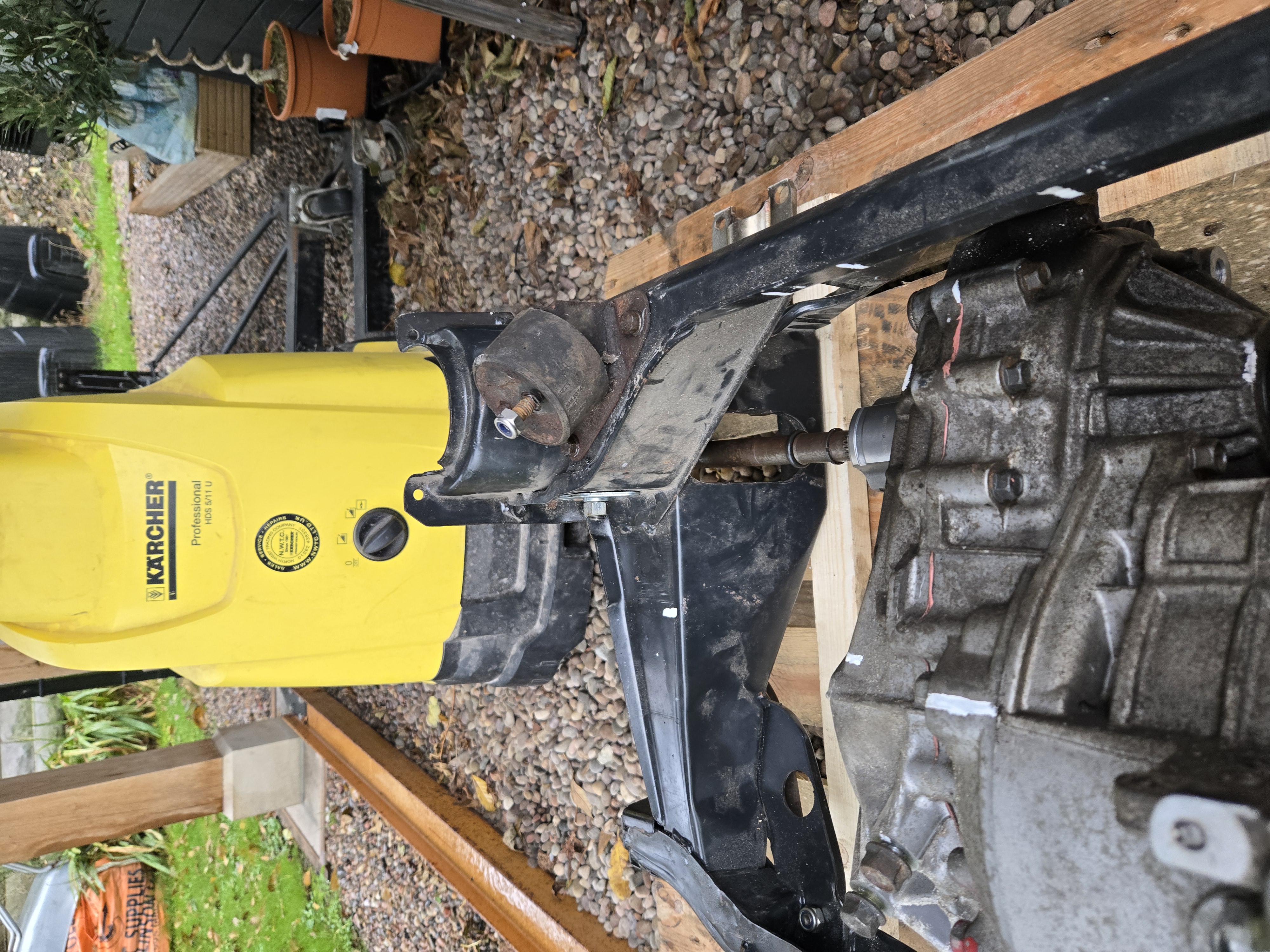

While I had some spare moments today I built up the spare subframe I had around putting all the upper and lower arms in, along with steering hubs and outer cv joints and metro drive shafts offered up to the outer cvs to get a feel for how its going to fit and align.
Bought a second set of outlander inner cvs and dry fitted in the outlander gearbox without the clips on, Then mock lined up the whole assembly up with some white marker (tippex in my case). Obviously I need to cut and sleeve the metro drive shafts on the outside to the outlander ones on the inside same as others have done with the minis. (already bought some cheapo 3.25mm walled tube x 25.4mm OD as a mock up. Will need cut and drop the diameters of both slightly on the lathe. Interesting the inner cvs on the outlander look a lot more feeble than the metro ones.
Need to chock everything up with some wooden blocks to get a feel for full top and bottom suspension travel but looking good, when sighted on sideways, compared to my other ICE engined Midas. (I have 2, the other is convertible but sadly has no room to convert to EV like the Coupe can).
Once happy with alignment I can start to make some mounting plates off existing bolt holes around the subframe. I am thinking 6-8mm plate with some gussetting probably on my plasma cutter after making cardboard templates.

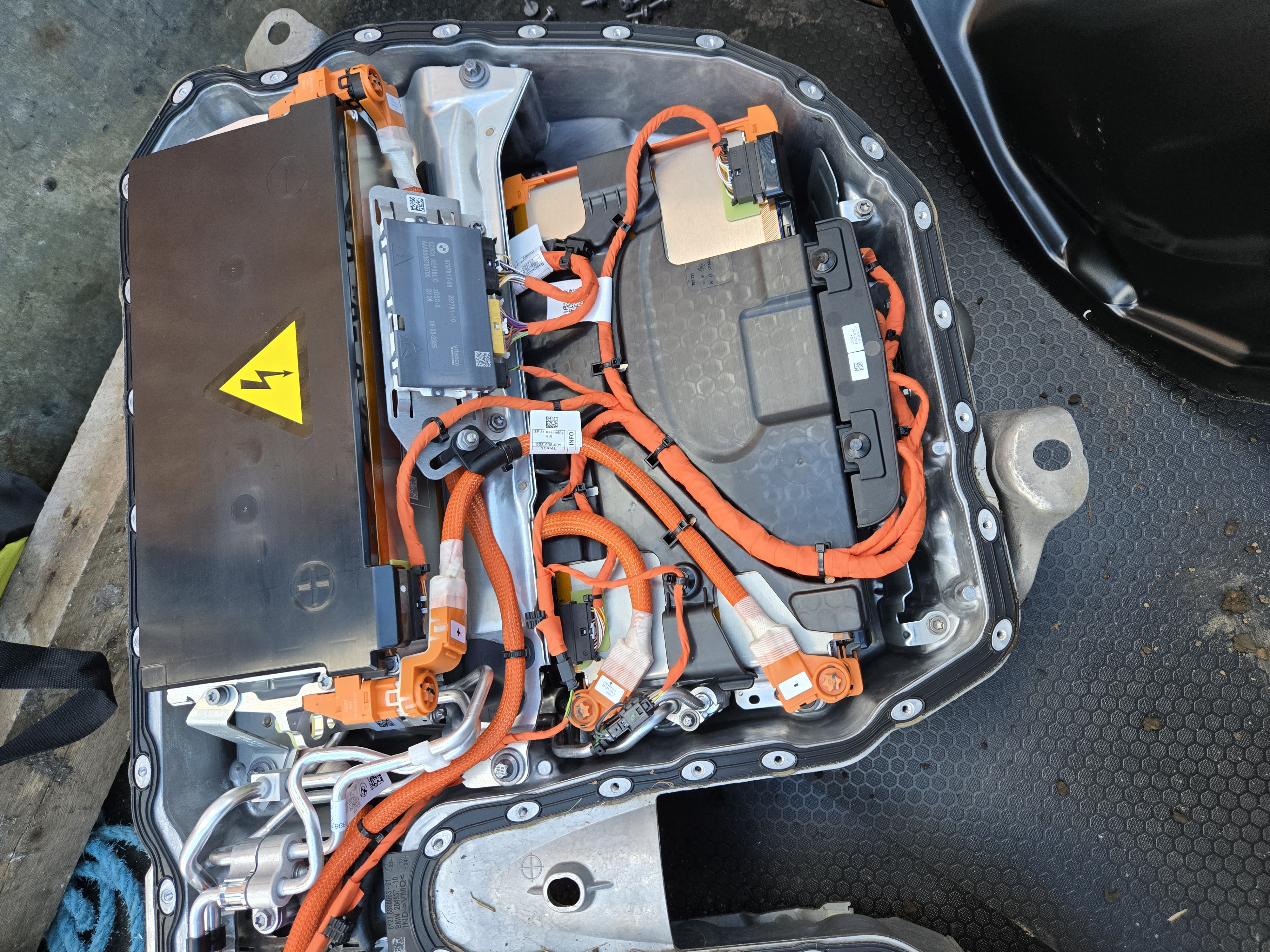

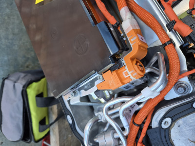

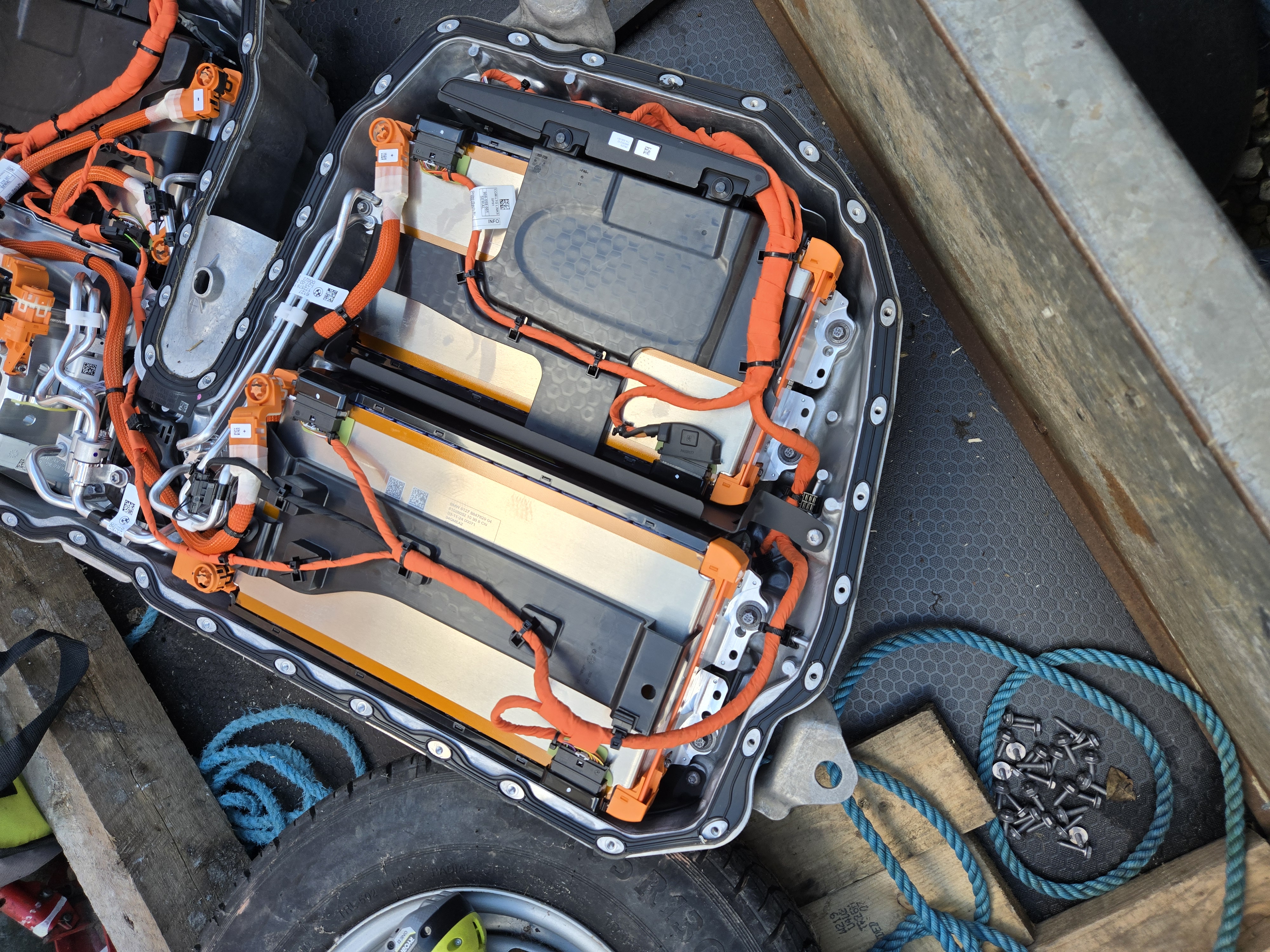

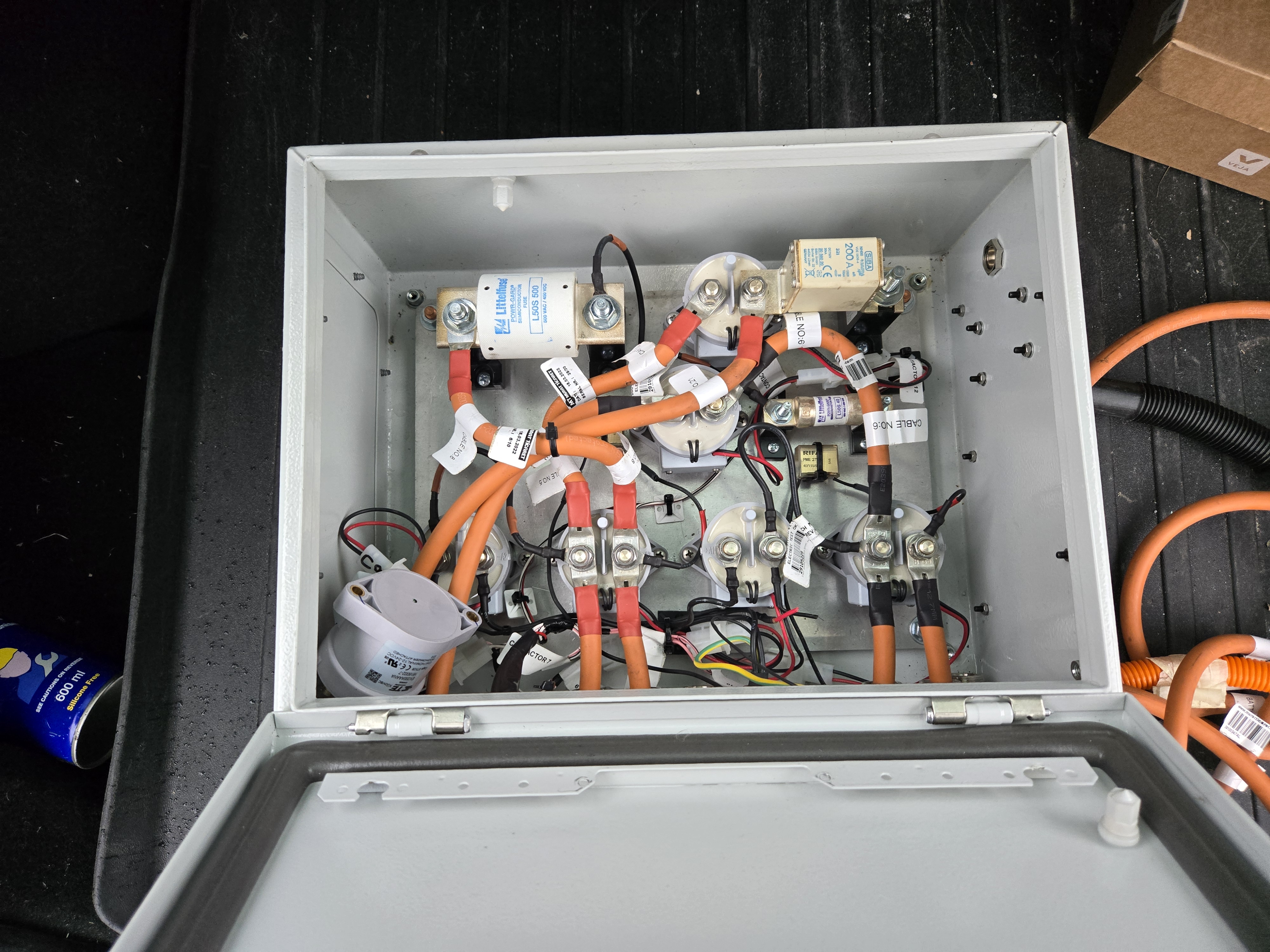

Picked up my BMW SP51 battery today (from a march sometime onwards 2025 33e touring).
Lifted the lid to take a look inside and it looks like a different setup to the earlier ones. Note the different type of connectors now. Similar to some other BMW ev models. eg iX
Looks like its still a 5 battery setup with 2 packs on one side with the sme underneath and 3 packs on the other side, with one pack laid on its side. Not sure where the contactors and precharge circuits (what was in an s-box) are at the moment as not unpicked all the wiring. Have a suspicion the contactors/precharge/sme are all contained in a single tin box underneath the 2 batteries. Thats where the HV power outlet is.
Posts: 2962
I would need to see all of these modules
To determine what sort of interface they are using. Likely the the large one on the other side of the saddle bags means they moved away from CAN based comms.
It be interesting to get some more info on the wiring and such to figure out how best to approach a BMS for this pack.

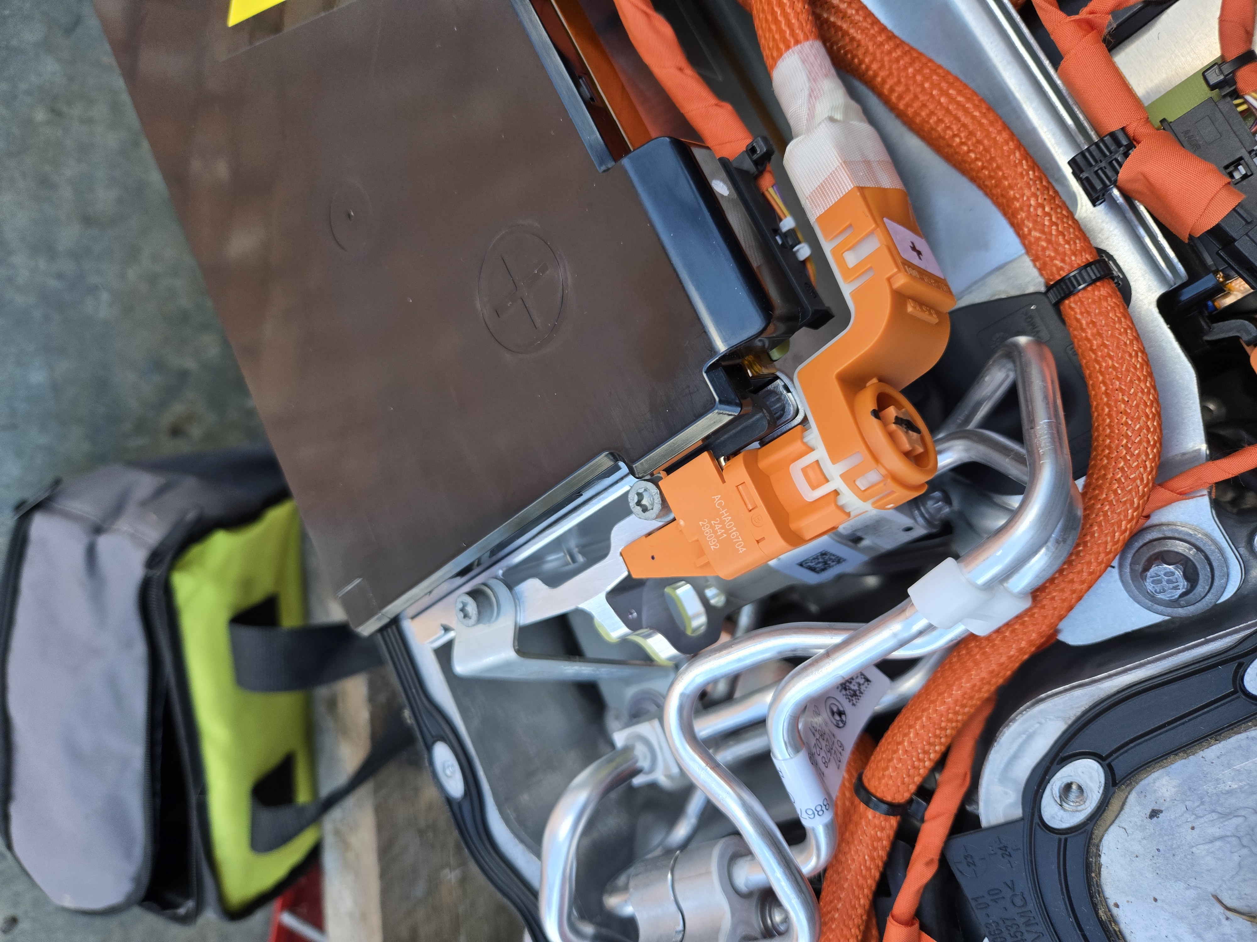

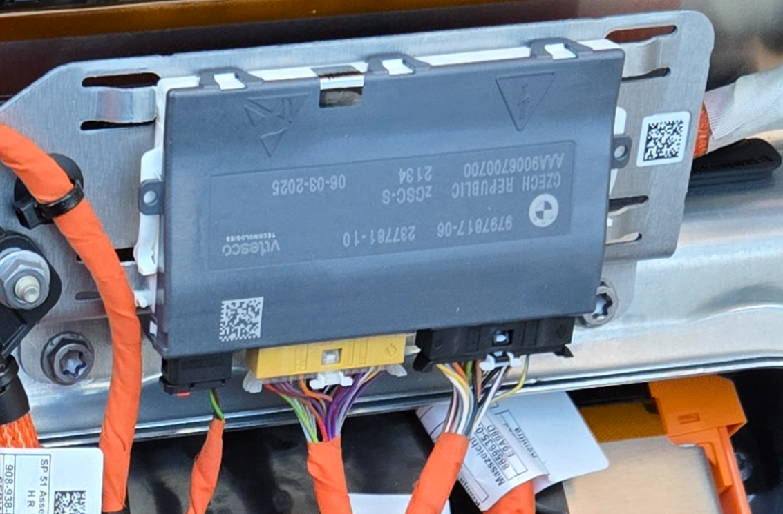

a link here refers to the SME module. Quite a few of these components in this box appear to be from this company:
https://www.vitesco-technologies.com/en ... stem-(bms)
CSC module:
https://www.vitesco-technologies.com/en ... cuit-(csc)
Posts: 2962
Sure but that does not give me much to tell you if a solution exists, or can be adapted or that it needs full reverse engineering.
Looking at the connectors used on the HV cell taps you might be into the impossible to find connectors too.
Same goes for the HV cable connectors, this was the the same in the past but likely not changed. There connectors are not available to the general public and likely are ultra sonically welded.
