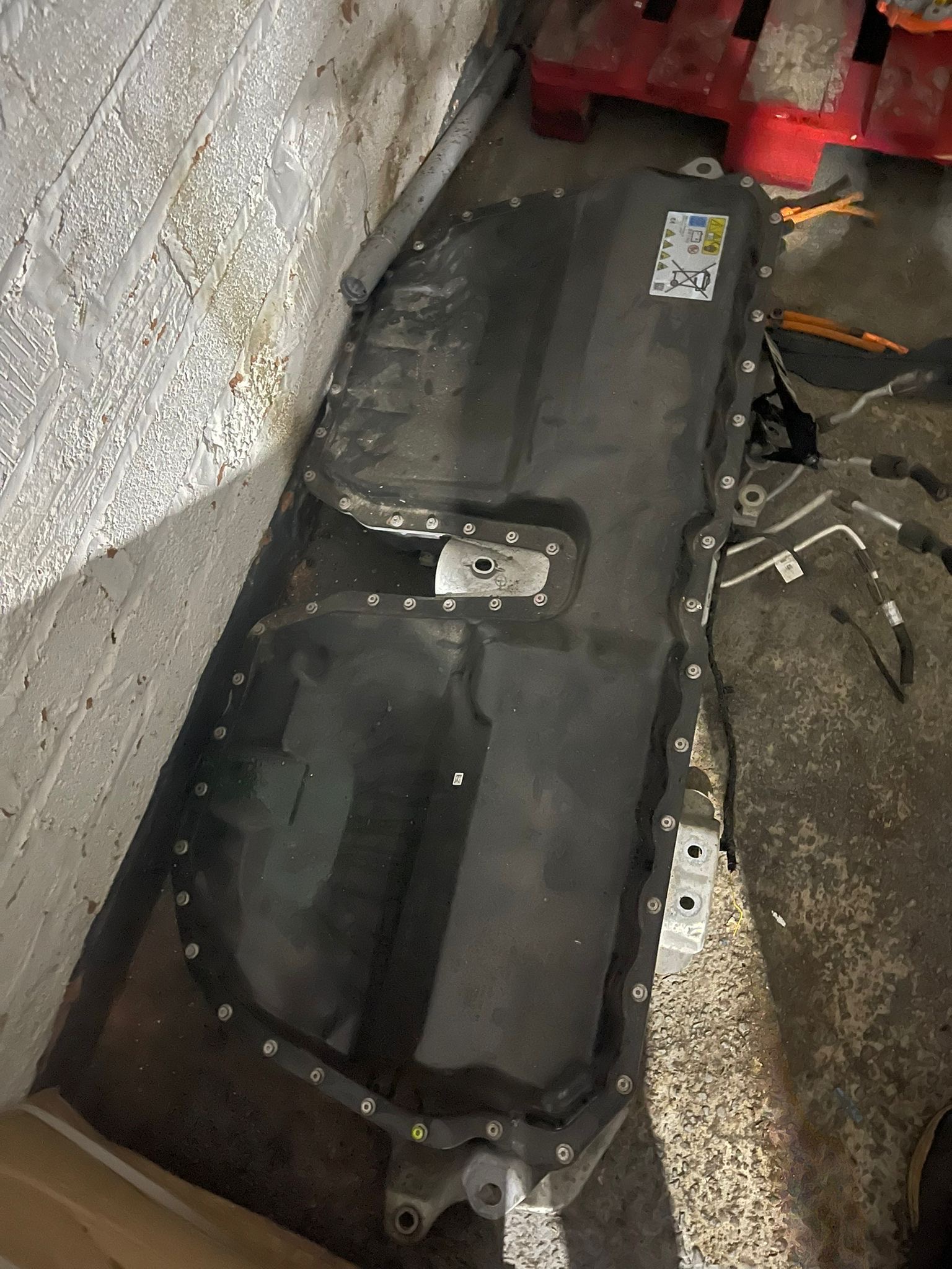

This looks like a great setup if it can be communicated with, there seems to be quite a few folks using the bmw sp41 packs at the moment but this pack is nearly double capacity, the modules appear to be the same dimensions but with totally different cabling.

Agreed re the capacity. That was the driver to me getting it. Will also be interesting to see whats inside the SME box. I suspect thats where the contactors are. The HV cabling seems to exit out of the back of the SME box underneath the battery pack. Might end up having to either build a contactor box or source an S box and convert. W

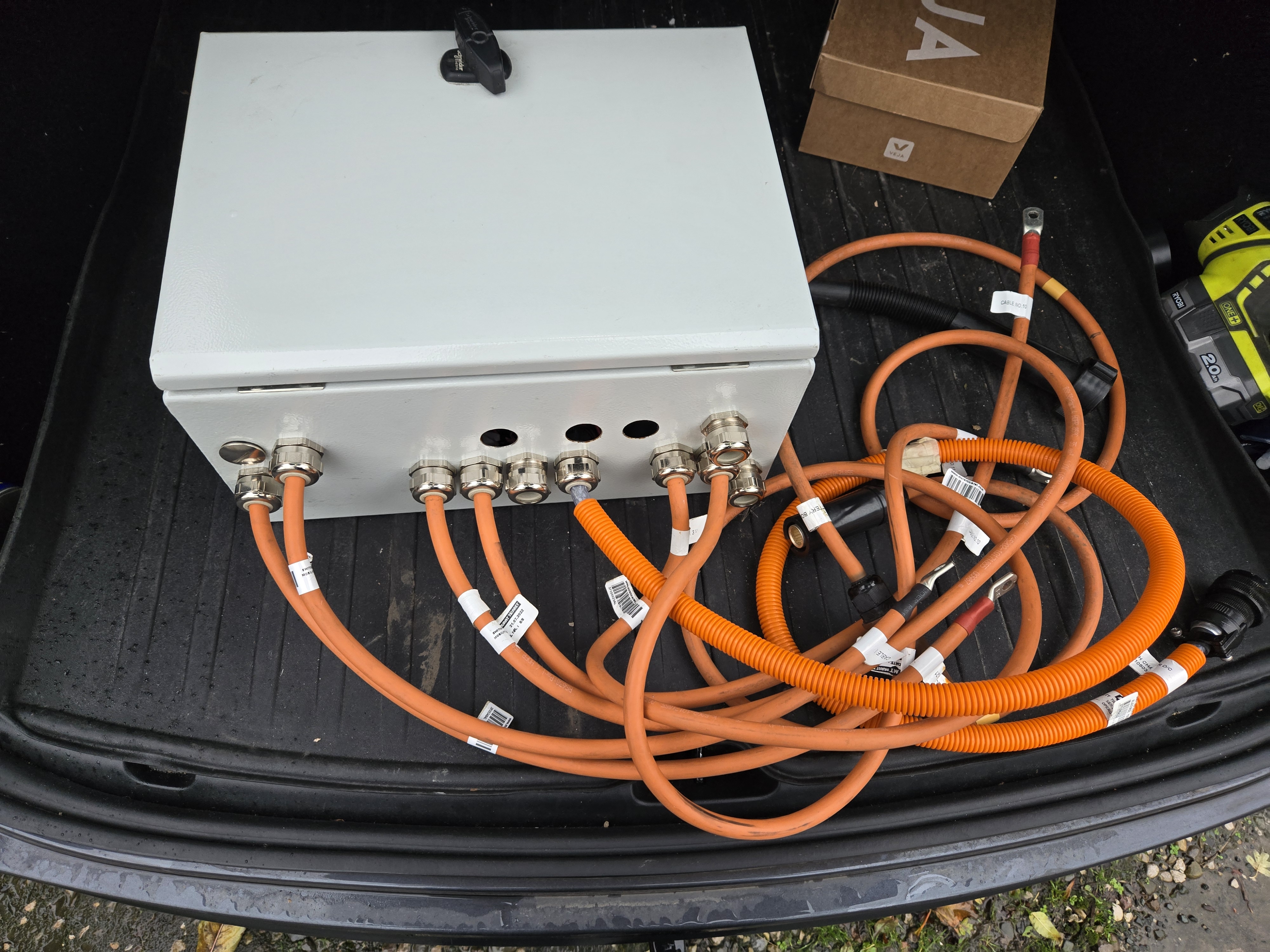

I was hoping that there might be a familiar s-box inside to build a junction box with precharge/contactors etc. I think its all encompassed in the tin can underneath the SME. Probably have to build one up or something.

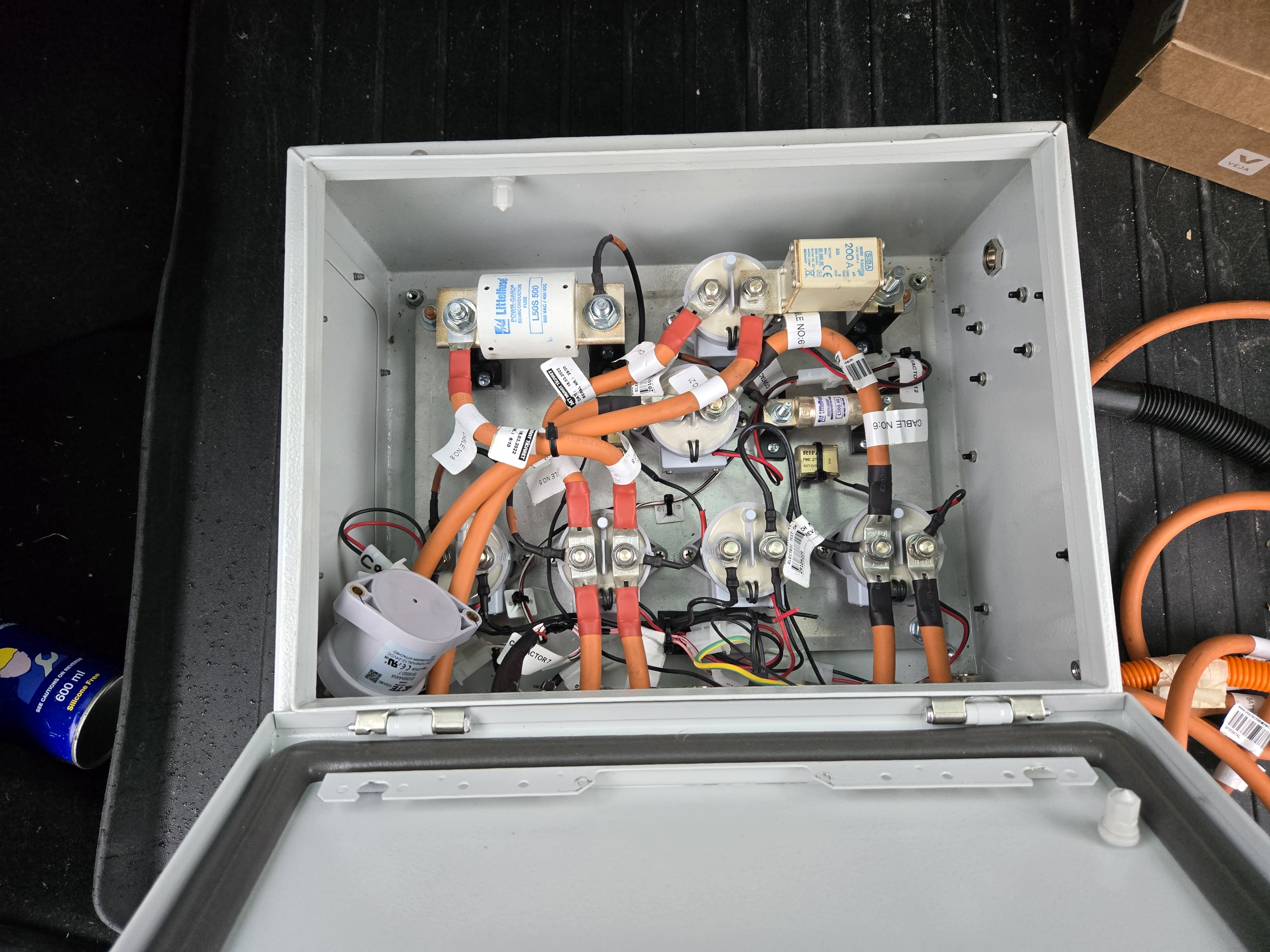

As part of the my project collection process I was looking for some kilovac ev200 contactors on ebay the other day and managed to bag a nice schneider electric metal contactor box stuffed with half a dozen or so kilovacs, standoffs, fuses and glands from a UK built EV bus. A bit overkill number of contactors for my project but good for me to have a few spares. The EV bus (as in autobus) had 4 battery banks apparently.
Pretty pleased with the box (with lockable key). Very well made unit.

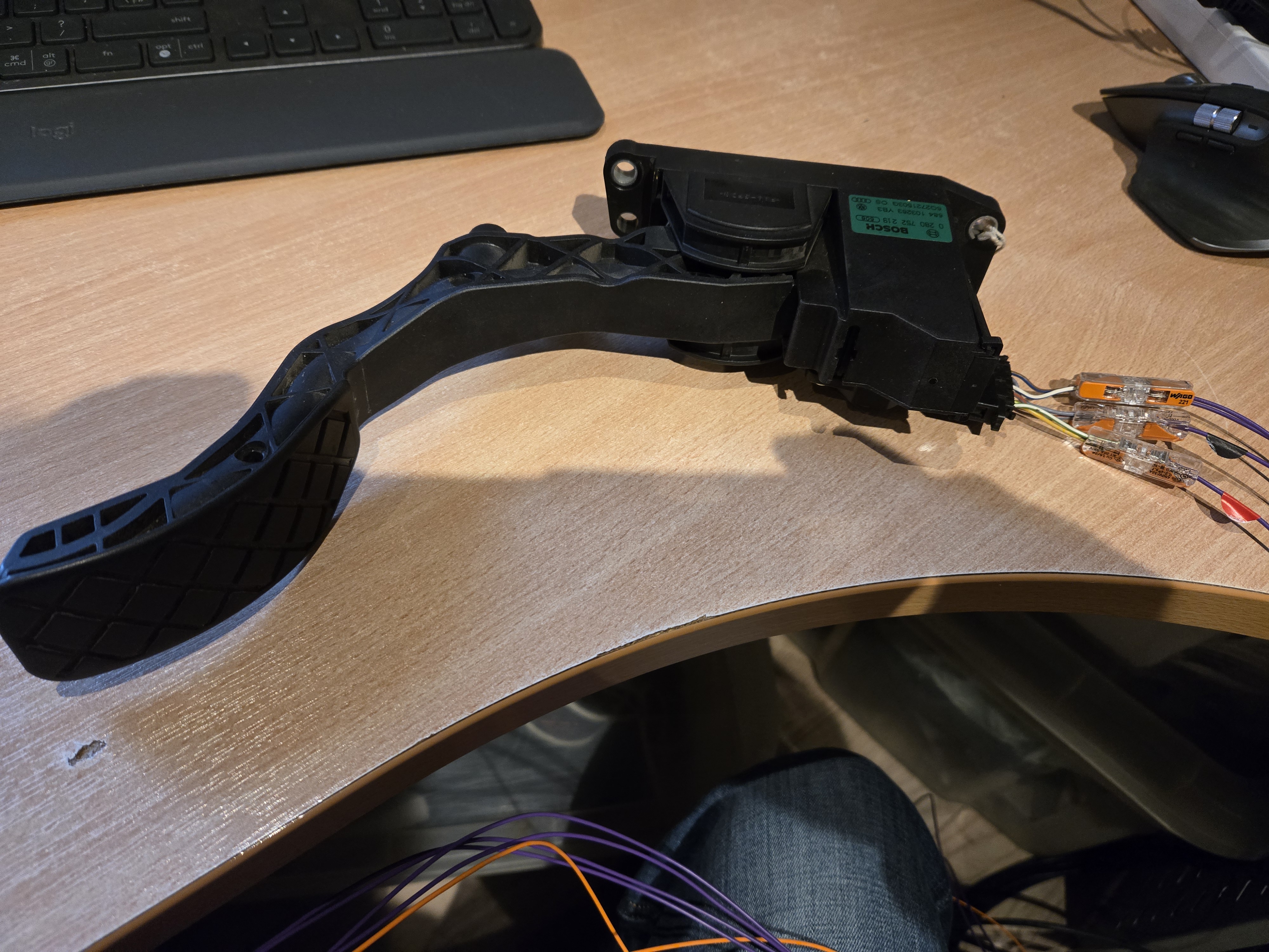

I've been playing with a VAG SEAT 2005 Pedal which I bought el cheapo on ebay - while I had some time free over the festivities working out the pinout from the pedal with a multimeter. Hoping to test it with my zombieverter at some point.
Part number relates to a few cars during the 2000-2010 age. SEAT Ibiza Accelerator Pedal 2005 0280752219 684103263 6Q2721503G VW Audi. Such as the VW Fox and VW Polo.
Volkswagen:
Polo Mk4 (9N, 9N3) (2002–2009)
Fox-EU (2005–2012)
Polo Classic/Sedan (various years between 2003 and 2010)
Skoda:
Fabia Mk1 (6Y) (1999–2007/2008)
SEAT:
Ibiza Mk3 (6L) (2002–2010)
Cordoba (6L) (2003–2009)
Technical Specifications
Type: Electronic pedal with integrated module (Potentiometer).
Connector: Typically features a 6-pin plug.
Common Alternate/OEM Numbers: 0280752219 (Bosch).
Configuration: Fits both Left-Hand Drive (LHD) and Right-Hand Drive (RHD) vehicles depending on specific stock, though many listed parts are RHD
specific.
Here is what I have on the female end of the plug with the 2 locating lugs on the bottom eyes facing towards the pedal. I had the pigtail with the plug so that might come in useful:
Pin Colour Function
1 White/Green +5 V Sensor 1
2 Yellow/Green +5 V Sensor 2
3 Grey/Red Ground Sensor 1
4 White/Blue Signal Sensor 1
5 Grey/Blue Ground Sensor 2
6 Brown/Blue Signal Sensor 2
And here are my results on my meter after wiring in 5v at 30mA on a bench supply..
Pin Colour Observed behaviour
1 White/Green tied together pin 1 and 2 (+5v)
2 Yellow/Green tied together pin 1 and 2 (+5v)
3 Grey/Red tied together pin 3 and 5 (-0v)
4 White/Blue 0.8 V → 4.5 V (signal)
5 Grey/Blue tied together pin 3 and 5 (-0v)
6 Brown/Blue 0.4 V → 2.2 V (signal)
I hope this might help someone.

Had a look at Gregski's (thank you for that) youtube post:
https://www.youtube.com/watch?v=JLN8A1YEx6M
about calibrating the pot values for the zombieverter with my throttle pedal.
Here are my values:
Pot 1 min: spot value 308: set my parameter to 320
Pot 1 max: spot value 156: set my parameter to 166
Pot 2 min: spot value 1855: set my parameter to 1845
Pot 2 max: spot value 862: set my parameter to 852
Here is an image of said pedal loosely wired in with some inline wego 221s (for testing out purposes only):
As I have a slanted floor half way in the floor/bulkhead area of my car where the throttle sits I aim to offset it towards me by bolting the pedal to some 60mm ally box section I have lying around which I will then bolt to the bulkhead using 6mm bolts. This will offer the pedal box enough to not hit the floor before getting full throttle for my situation. Access to bolts fixings/nuts will be by using a hole cutter in the side of box section to get a spanner/fingers in to bolt the pedal up to the box section. The box section to the bulkhead.

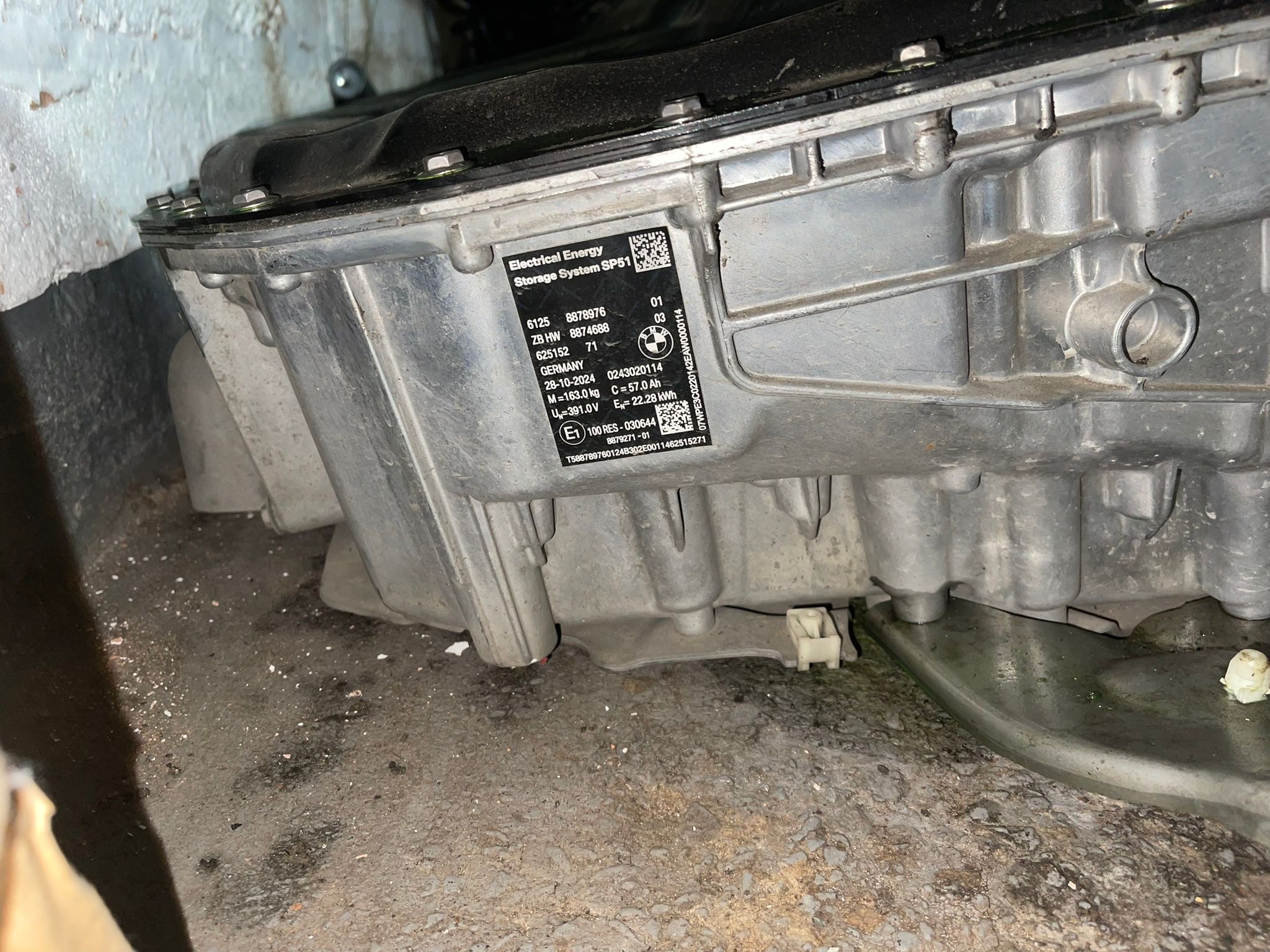

manifold wrote: Wed Oct 22, 2025 9:06 pm a link here refers to the SME module. Quite a few of these components in this box appear to be from this company:
https://www.vitesco-technologies.com/en ... stem-(bms)
CSC module:
https://www.vitesco-technologies.com/en ... cuit-(csc)
Hi, have you managed to do a full tear down of the battery pack into individual modules? Have you located the Sbox?
Love to see more photos and any more information.
I couldn’t get the links posted to work 🙂

Thanks, it would be brilliant if you could get one module removed and work out how the positive and negative connectors disconnect as they are quite different from the SP41 battery.
I am considering
buying one of these packs and your help would be invaluable. 🙂

No probs. Looks like just a socket is used to remove the terminals. There was a youTube video of a battery pack being stripped down but looks like it has been removed sadly.
