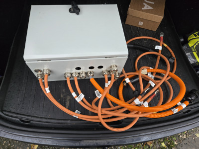

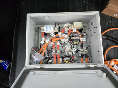

As part of the my project collection process I was looking for some kilovac ev200 contactors on ebay the other day and managed to bag a nice schneider electric metal contactor box stuffed with half a dozen or so kilovacs, standoffs, fuses and glands from a UK built EV bus. A bit overkill number of contactors for my project but good for me to have a few spares. The EV bus (as in autobus) had 4 battery banks apparently.
Pretty pleased with the box (with lockable key). Very well made unit.
