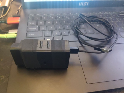

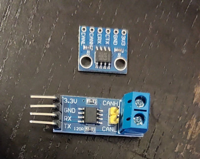

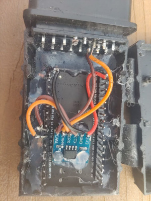

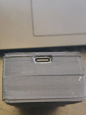

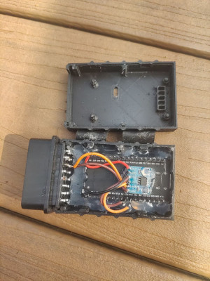

I used Alibros video to create a CAN adapter? in a compact version, to work with Savvycan.
Alibro uses the bigger 3.3v Can board and I used the smaller one , so it can fit in the 3D printed box.
The small board is powered directly from the ESP 32, and the ESP32 is getting power from the computer via the USBC cable.

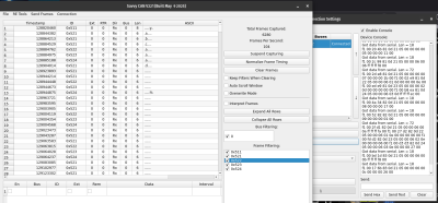

I realized that I need to buy an ISA shunt. not sure how to set it up yet but it is sending out some IDs, so I guess it works.
