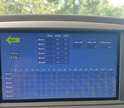

nice, you just changed 9600 to 115200? no changes to the nextion display?

I changed both. Nextion display too.

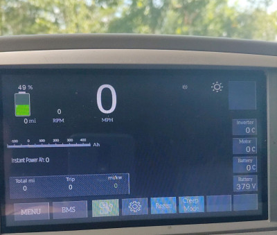

So.... After I thought that my tesla charger works, now it shows fault on the 2 out of 3 inverers that I thought were running. They were only pushing about 1.8 amps and after about 2 hours I got "fault" error on the 2 working inverters.
I am looking now for a 3.3.or 6.6kw Chinese charger on Aliexpress.

Octavius convinced me to check again before I used my metric tool and found out that this AC switch went out.
Now it is charging with 4 amps I tried to go higher but the inverter contractors keep going on and off. for now is good because is a thin AC cable and it is only 120V.
at least I am finally charging the battery.

Post by PetersonOctavius »
on 120v ac if you pull more than 10amps AC, the voltage drops so low that the charger resets itself, and tries again.

Post by Proton »
Nice to see the battery charging.
Now that I know the slowness on the screen was caused by the baud rate, I need to add some info back.
