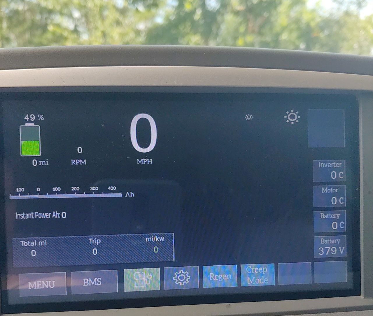

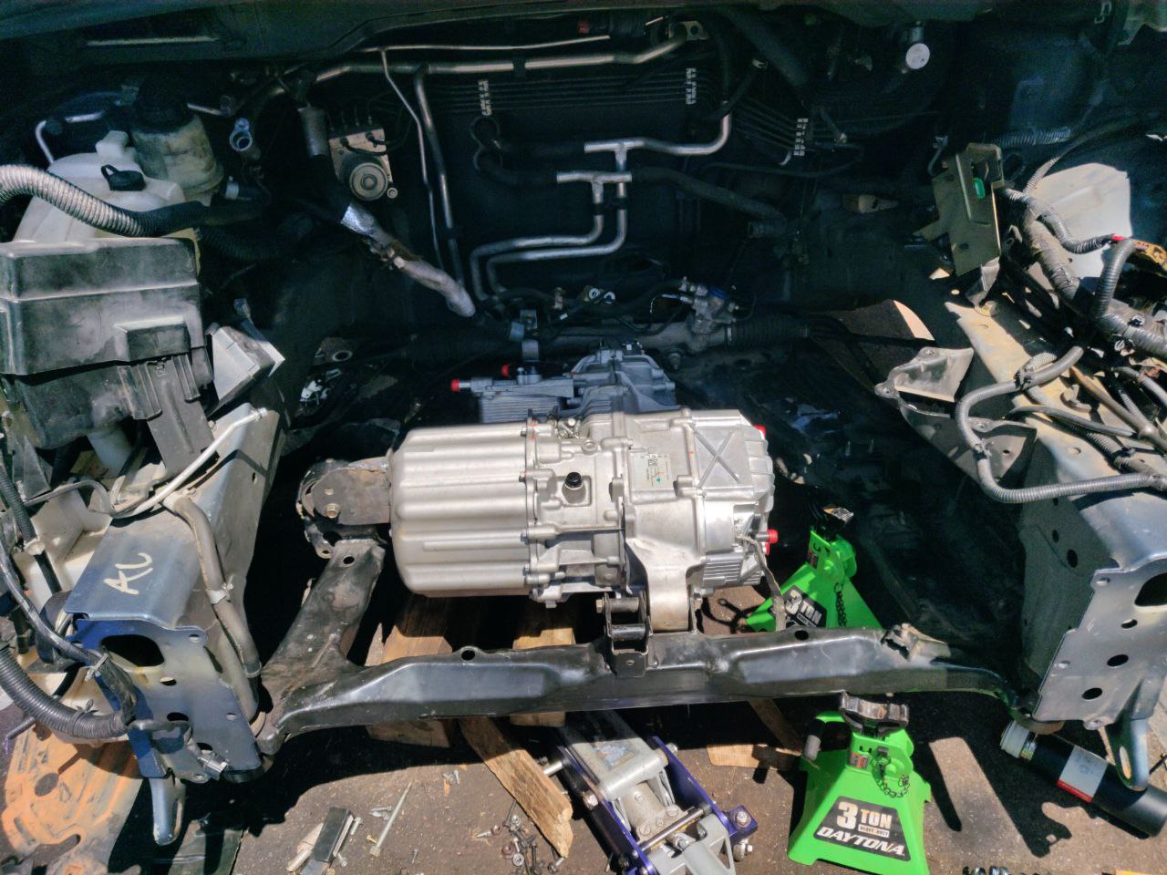

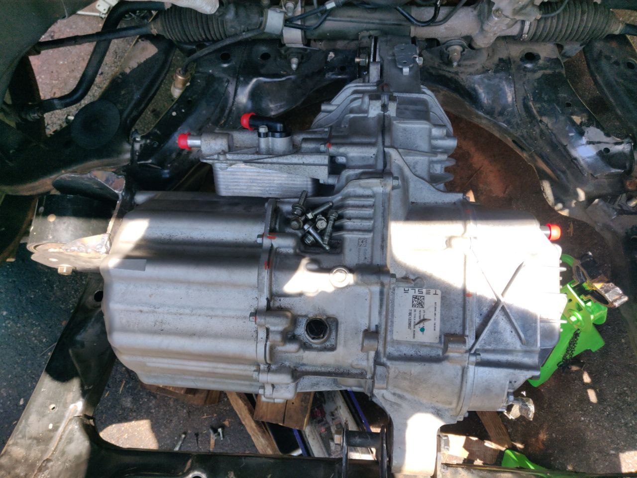

I started this conversion and made some progress.
For anybody interested in high voltage contractors, Battery hookup has some for $29.
TE Connectivity EV200AAANA 500a 0-900vdc Tyco 12/24v
https://batteryhookup.com/products/te-c ... a-0-900vdc
If anybody has info where in USA I can make some custom CV axles please let me know.
Next would be the CV axles and the OIL pump modification. did not want to do that but I guess I have no other option.

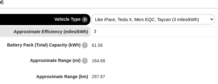

I need at least 120 miles range.
On my house I have 3kW of solar panels and I ordered another 12 panels 5.76kW that are probably coming today. Trina-Solar-480W-252-Cell-Mono.
https://www.renvu.com/Trina-Solar-480W- ... olar-Panel
these are big: Module Length [in]: 91" x 40", so 231cm x 102cm. that will cover 85%- 90% of the van roof.
I have to find a way to connect the solar panel to the future battery. This is only 37V under load.
.48kw x 6hr = 2.88 kw a day which will add to the range. I will look to add 2 solar panels and expand them while parked. will see how heavy they are.

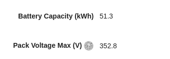

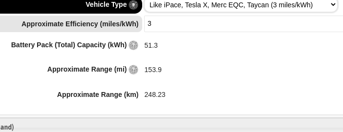

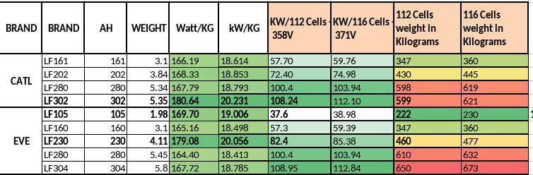

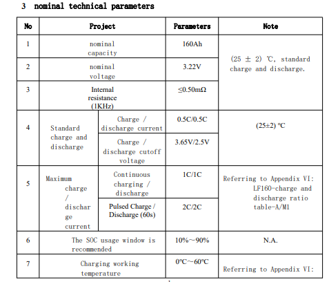

I am planning for now to use 160 AH LFP batteries at 358V that would be 57kW at max usable power.
Is anybody here with a completed car that can give me some numbers of how much they pull when accelerating or if 57 kW is enough for a good acceleration?

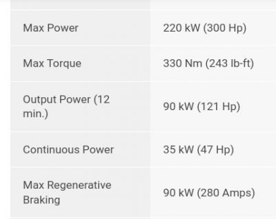

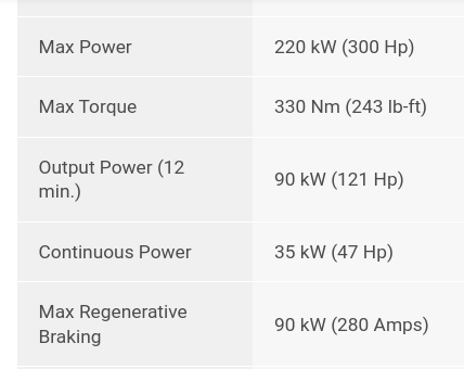

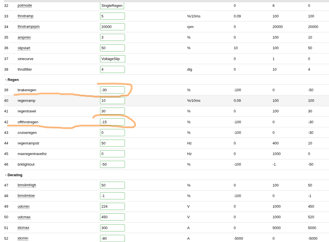

Continuous power for Tesla SDU is only 35kW. 160 Ah x 358V = 57.2kW.
Now, the only problem would be Regen. I would not be able to regen 90Kw that Tesla SDU can do.

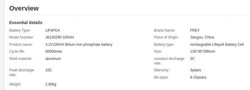

Just got the data sheet for the 160 AH batteries. they look good.
Pulse Charge/Discharge for 60 seconds at 2C. and normal charge .5C. normal discharge 1C. I can do easy 0 to 60

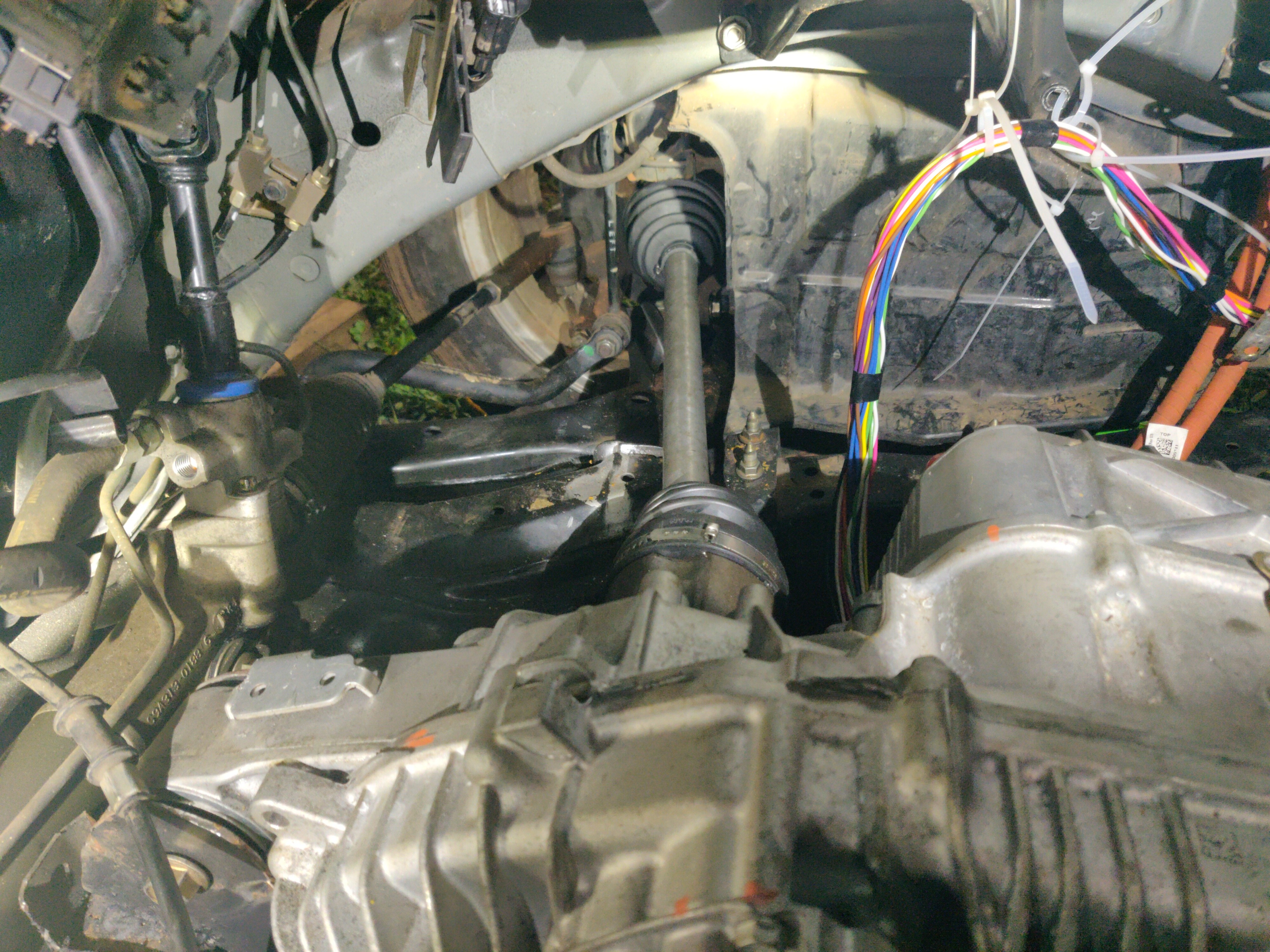

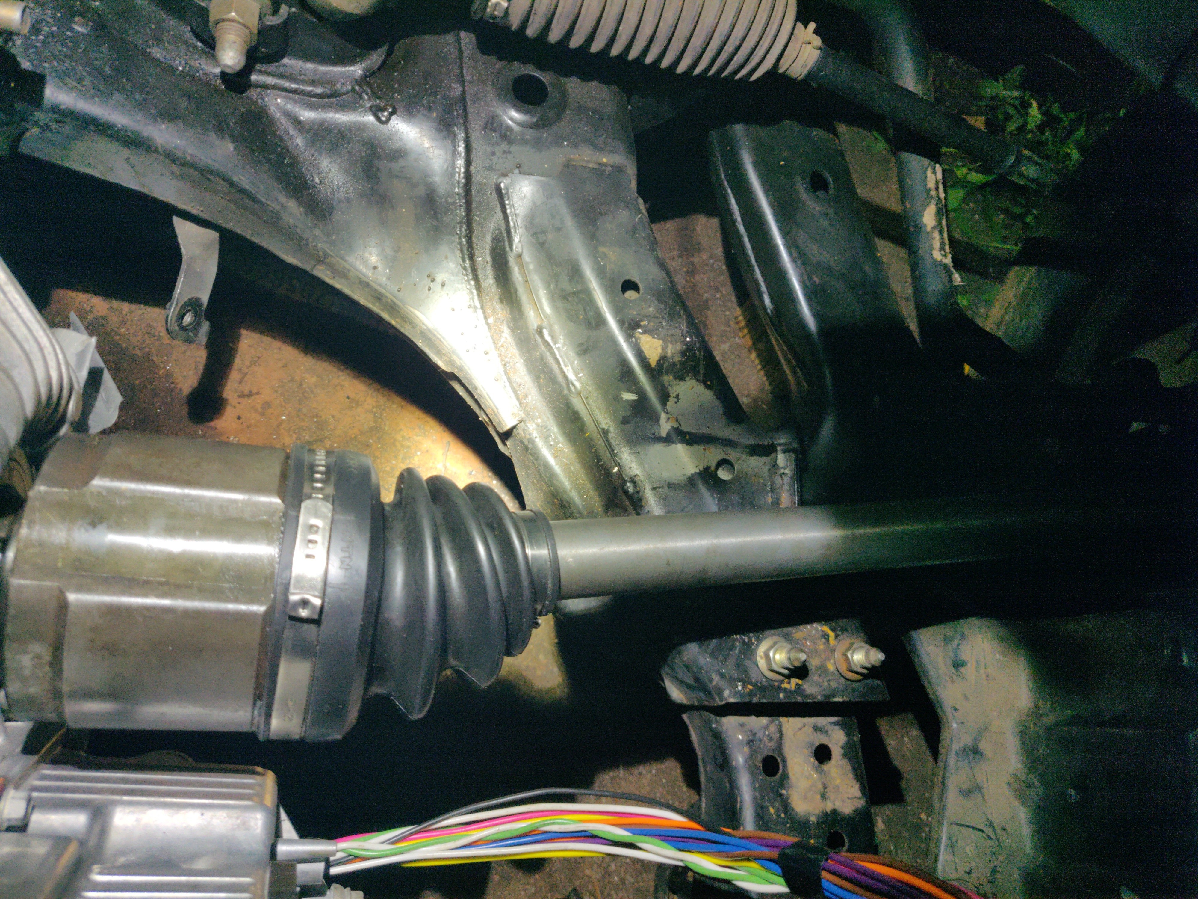

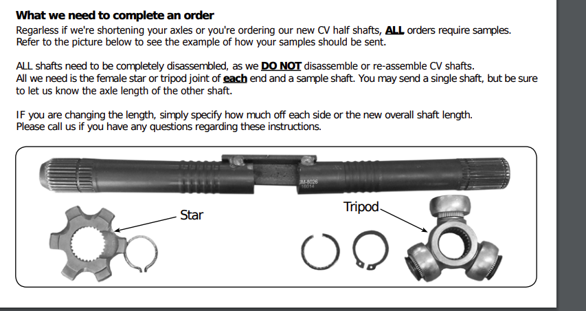

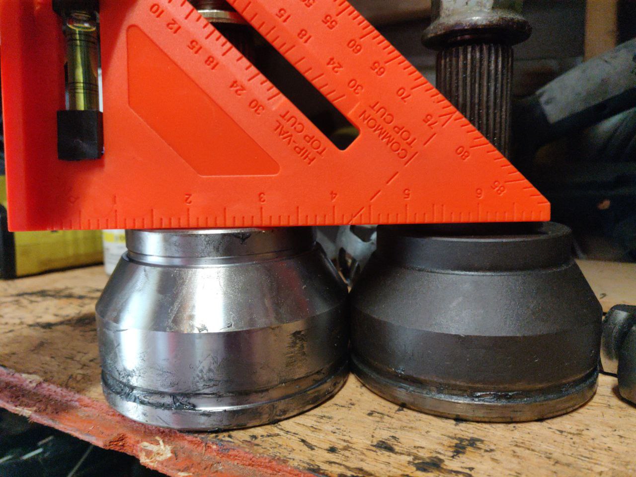

CV Axles:
the best price I found is at dutchmanaxles.com. they said $600 to $700 for 2. Next closest offer from driveshaftshop.com was $1600 + shipping.
https://dutchmanaxles.com/images/orderi ... ned_cv.pdf
Dutchman brothers need the following to fulfill the order.
Pretty much need to cut the Nissan axle and 1 Tesla axle and tac weld them at the required length and send it to them. they can make the Axle shafts only.
I like this idea a lot better because I can take the ends from Nissan and from Tesla and just plug them in. I can buy spares for Nissan and Tesla for the future.

Yupsz; it's the best wat. Let them cut a new axle with both profiles from different cars on each end.

That's super conservative. The data sheet specifies 2C for 60s, just roll with that. You're not going to accelerate for 60s
Same here but you will find even 60 kW of regen is quite hefty.

I was looking at the batteries I am using in my solar system, and they are powerful. Unfortunately they are also heavy. In the video I am saying abut 200lb but actually they are 274kg. just 114w/kg.
I already used them in my solar system for 4 years.

Can you measure (calculate ) the angle? It's better to have factual numbers then gut feeling.
And if you want to use feeling...how does it feel (rotate) now anyway.
Did you tu to spin it? Vibrations?

I still have to mount the 2nd one. I didn't used the motor to spin it yet.

Because I destroyed the first CV from Nissan I bought a second one. Problem is that 2nd one is about 5-6 mm in longer. I could probably still use it, but just to be safe I ordered another one that seems to be the right size.

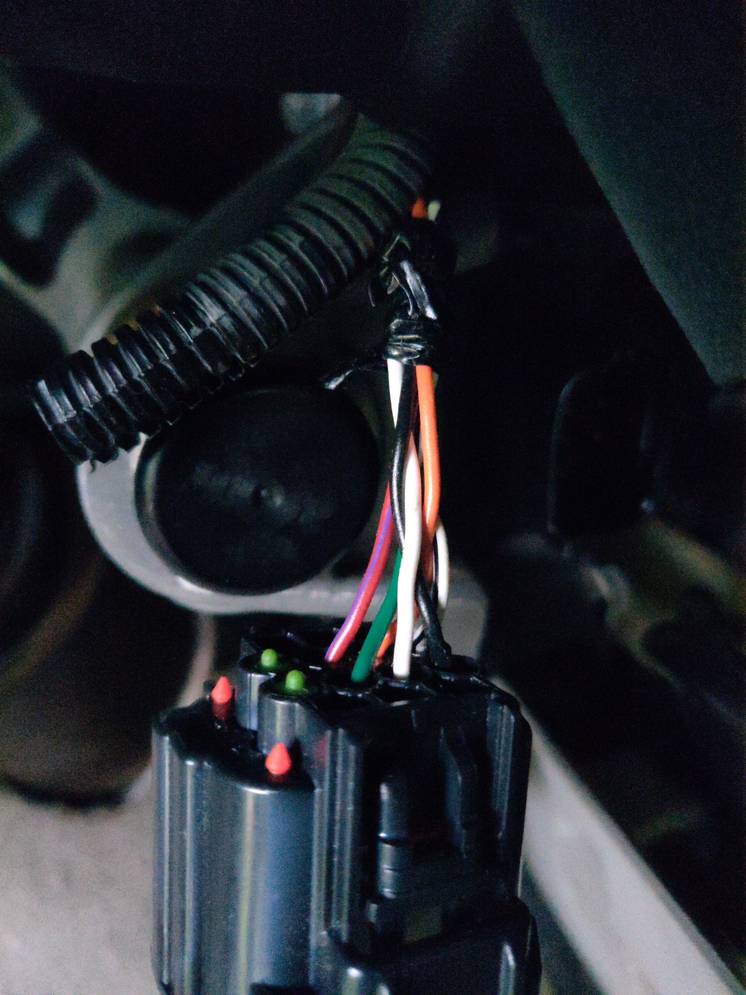

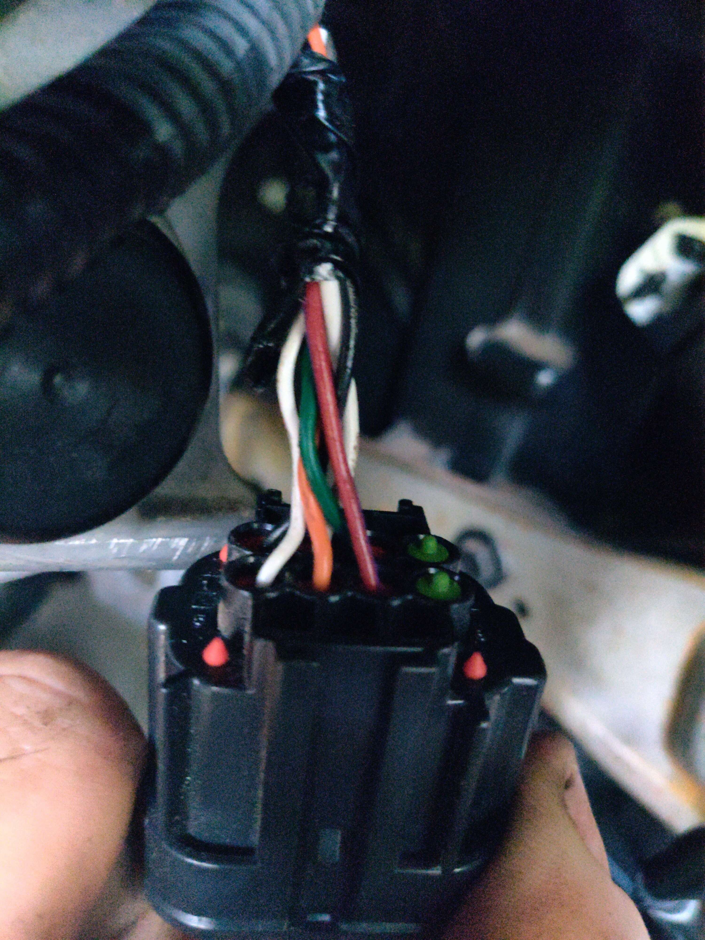

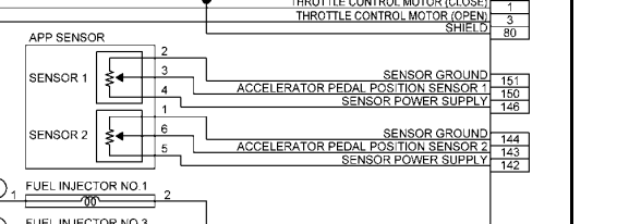

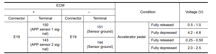

Initially I though that I have to use the Prius throttle I bought for testing, but now I discovered that the Nissan also has a throttle with wires. Problem is that I cannot find a diagram to show me which wires to use.
There is any way I can find out with multimeter which wires to use?
- Been thanked: 1914 times
Re: Nissan Quest Van with Tesla SDU.
I'm quite sure it'll need 2x 5V, 2x GND and outputs 2 somehow proportional position voltages.
Just a wild guess: pink and orange 5V, green ans white/black signals, black and white ground. Try with a very low current limit, like 20 mA

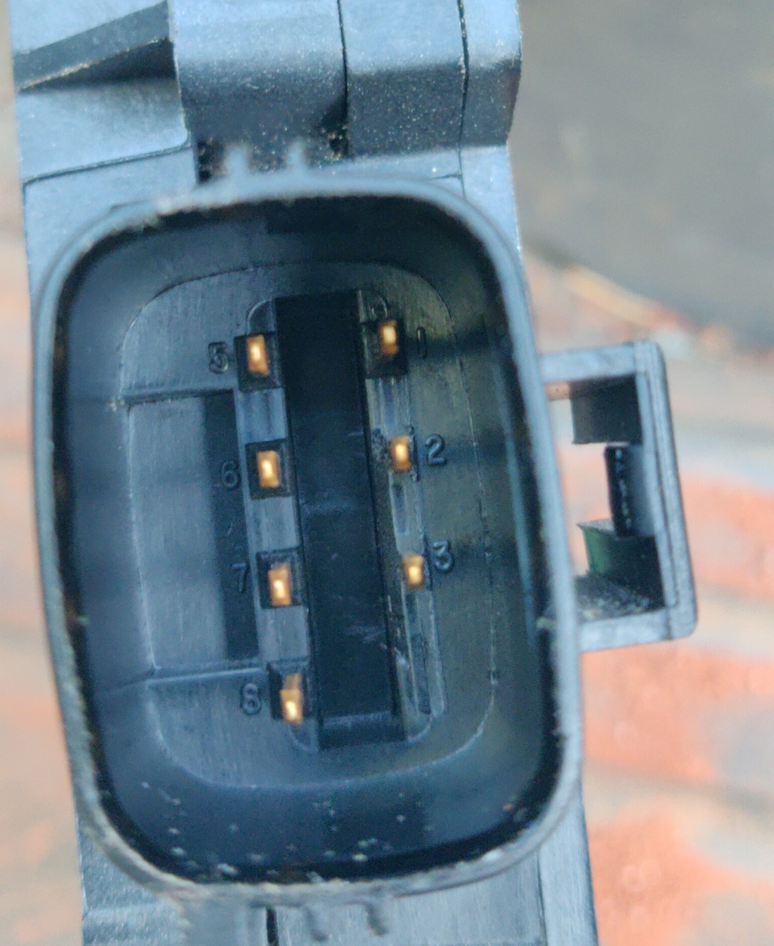

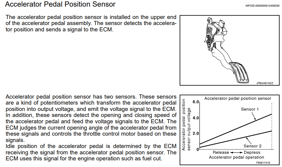

The Service Manual includes a schematic, I found one online (without registration bullshit) for a 2016 model: https://procarmanuals.com/pdf-online-ni ... ce-manual/Proton wrote: ↑Sat Jul 15, 2023 4:19 am Initially I though that I have to use the Prius throttle I bought for testing, but now I discovered that the Nissan also has a throttle with wires. Problem is that I cannot find a diagram to show me which wires to use.
As usual, the Nissan manual is quite outstanding, here are some screenshots, which are relevant for you:
(Page 1819)
(Page 1803) (Page 2233)
If you want to, you can add this information (if it applies to your case) with the part number and wire colors to the OpenInverter Wiki: https://openinverter.org/wiki/Nissan_El ... ttle_Pedal (the page still has to be created)
This is true for most throttle pedals, however I learned recently that the Volvo V70 II (with Bosch ME7? I think?) has a different setup: There is one analog output which is supplied with +5V from the ECM and there is a digital circuit with +12V supply from another circuit which outputs a PWM signal to the ECM and the ETM (Electronic Throttle Module). Later ones even have CAN I think.
I found that out because the throttle pedal shares a fuse with the magnet clutch of the AC compressor, and when the magnet clutch burnt out on my partner's Volvo, a weird Throttle Pedal error appeared at the same time
That was quite the rabbit hole of throttle pedals I went down and it took some time to make the connection
- Proton
- Posts: 366
- Location: Georgia/US
- Has thanked: 227 times
- Been thanked: 57 times
Much appreciated !!!
On mine it looks pins 4 and 8 are not used. So without those 2 pins we have 123567 which I am guessing are 123456
PIN 1 - Black
PIN 2 - White
PIN 3 - Green
PIN 5 - White/Black
PIN 6 - Orange
PIN 7 - Red/Blue
Or
PIN 1 - Black
PIN 2 - White
PIN 3 - Green
PIN 4 - White/Black
PIN 5 - Orange
PIN 6 - Red/Blue
