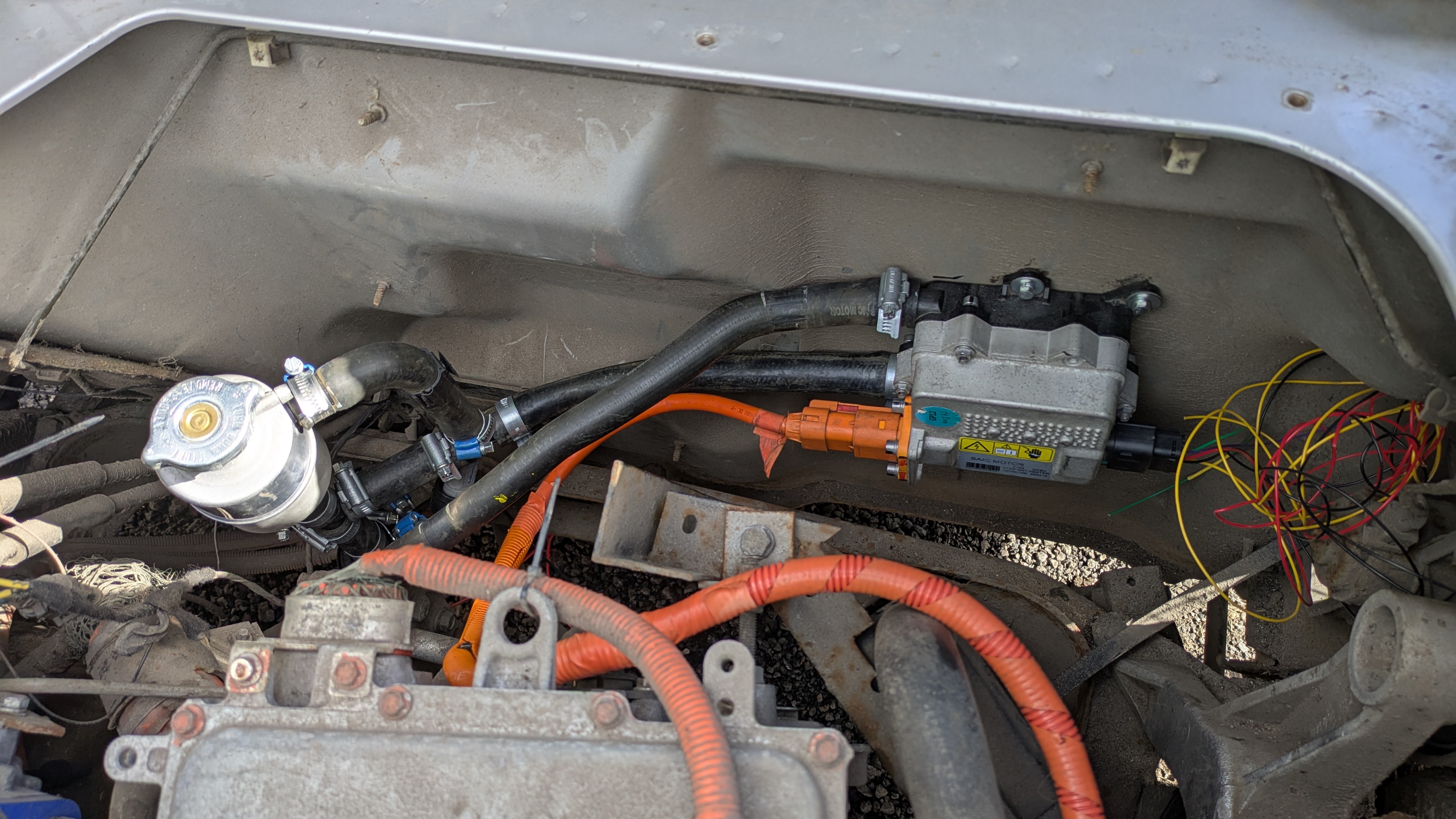

With the worst of the winter probably over and the first top down drive of the year done I thought it would be a good time to install a cabin heater.
I'm using an MG water heater, slowly been preparing everything in the last few weeks so that I could get it installed all in one day.
Here it is half way through the install, I have it plumbed into the original heater matrix outlets in the engine bay with a small header tank. At the end of the day I only had the canbus wiring to do, then I could fill it up and do some testing.
Unfortunately it didn't quite go to plan. I went to move the car before heading home and it didn't complete precharge which was very strange. A bit of investigation and long story short, I managed to reverse the polarity on the heater HV and blew the precharge resistor in the Sbox. Even more unfortunately I can't remove the Sbox without dropping the front subframe.

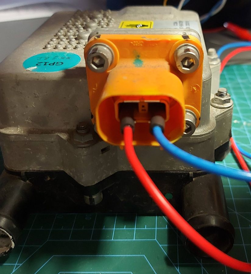

LRBen wrote: Sat Mar 01, 2025 5:08 pm ..... I managed to reverse the polarity on the heater HV and blew the precharge resistor in the Sbox. .....
Can you please confirm if correct HV orientation is the one on the pic here?

arber333 wrote: Sat Mar 01, 2025 6:35 pm Can you please confirm if correct HV orientation is the one on the pic here?
Yes it is, this is how mine was wired on the bench and powered for reverse engineering I done.
As per wiki https://openinverter.org/wiki/MG_Coolant_Heater
I can tell you for certain having them the other way around doesn't work.
I think one reason for the mix up was that I used a cable not from the MG heater originally, in this cable the red and blue are swapped compared to that photo, so somewhere along the line I got it in my head that the cable was correct.
I should have confirmed before with a multi-meter before plugging it in to check once again.

Back on the road again! Made an attempt to swap front and rear spheres but it was a bit too tricky to get the rears off without dropping that subframe as well. So i've left it for now.
This time I managed to wire the heater correctly and so the new precharge resistor is still intact. I was able to get a good look inside the battery box after almost two years and I'm happy to say there is no sign of water ingress at all. I threw in an extra bag of desiccant before sealing it all back up just to be safe.
With that all done I just need to wire the heater into the canbus lines and we should have some heat in the cabin finally.
