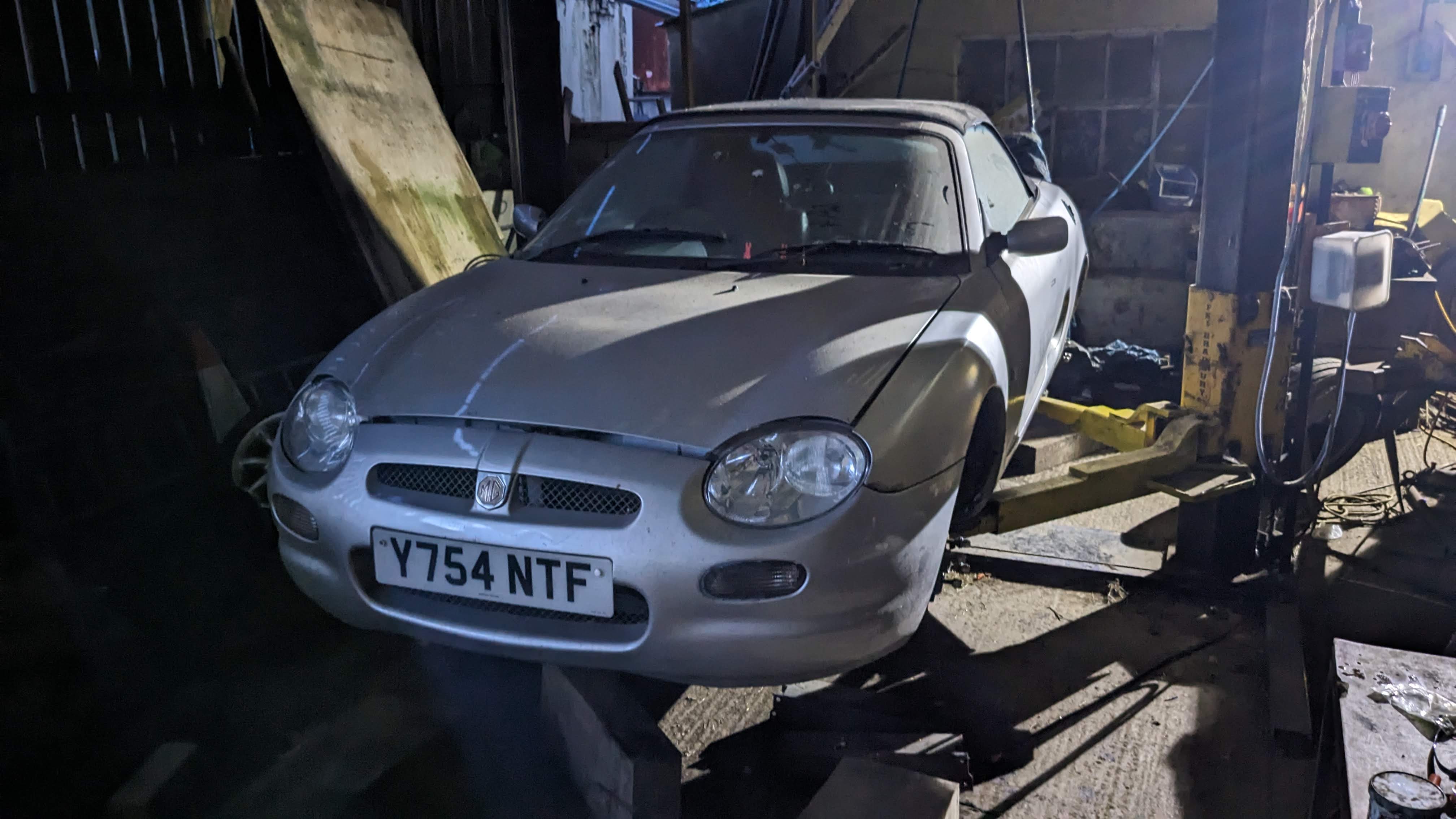

Re: [Driving/WIP] MG F - Outlander Rear motor and inverter.
Upgrades are pretty much done now. BMW hybrid battery sitting nicely in the front subframe, freeing up space in the cabin for a passenger seat yet again.
Zombieverter is in running everything, had to make a few additions to the charger module to run stand alone but it's working great now. I'll submit those changes to the main Zombie release once I've had a chance to test it a few times.
Didn't end up making much in the way of QoL upgrades, wiring is still a mess, still no heating, still using the original throttle sensor for now. But I did redo the coolant loop which has made a noticeable difference to charging temperatures at least.
Just need to pump up the suspension and then it's road worthy. MOT booked for the 18th November which gives me some time to tidy it up a bit.
Here is it looking a bit dirty again after four months in the barn.

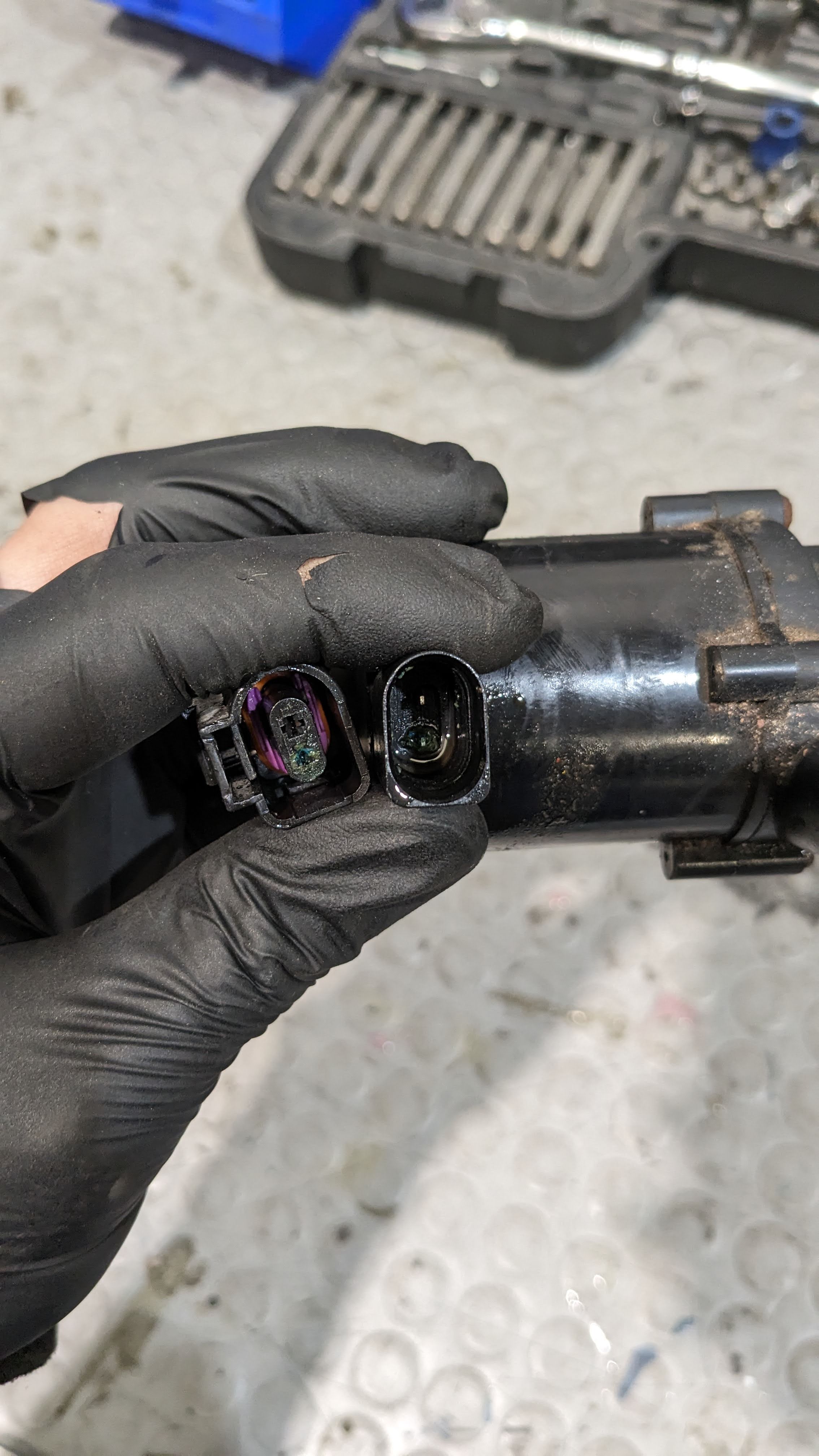

Learnt a lesson in water proofing today.
Driving to work I noticed a slight cut out of power as I pulled onto the first fast road of my commute. Thought it was a maybe some issues with the throttle. A few more miles and it got allot worse, I checked throttle values in the web interface and it all seemed fine. Ran through amp and voltage min levels just in case those had changed for some reason.
Eventually realised my water pump was not pumping, checked the wiring as best as I could without a multimeter but it seemed ok. The pump was very hot so I figured it had failed, it was a cheapy pump anyway.
Manged to get 20 out of the 28 miles to work then had to get trailered the rest of the way. On hills it would cut out, after a few seconds I could move again a few feet before it cut out again. There were allot of quite fast hills in the remaining 8 miles so I had to throw the towel in.
Values in zombie for inverter and motor temperatures were well under the cut off values set, however I do have a resistor in place of one of the motor sensors and zombie takes an average of the two. So I expect I was hitting an internal cut off temperature and it was the inverter that was derating me.
Once I got to work I removed the pump to find water ingress in the connector. Which is where my issue lay. Replaced the pump with a Bosch pump and made sure this time to add lots of silicone around the connector and wires.

those pumps are poor i found - i've had 2 fail. My spare in a roadside emergency is to pinch the one from the cabin heater loop.

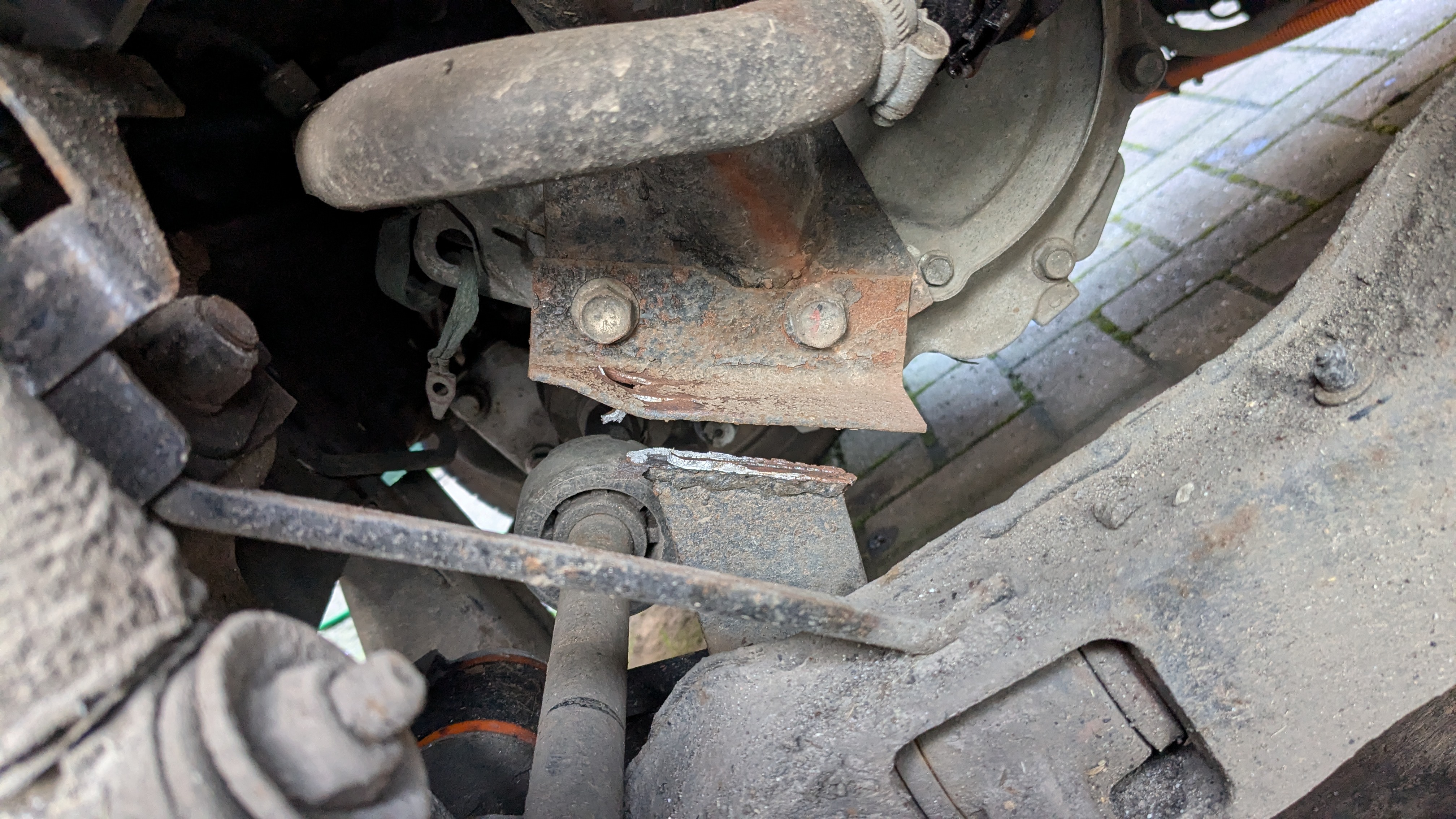

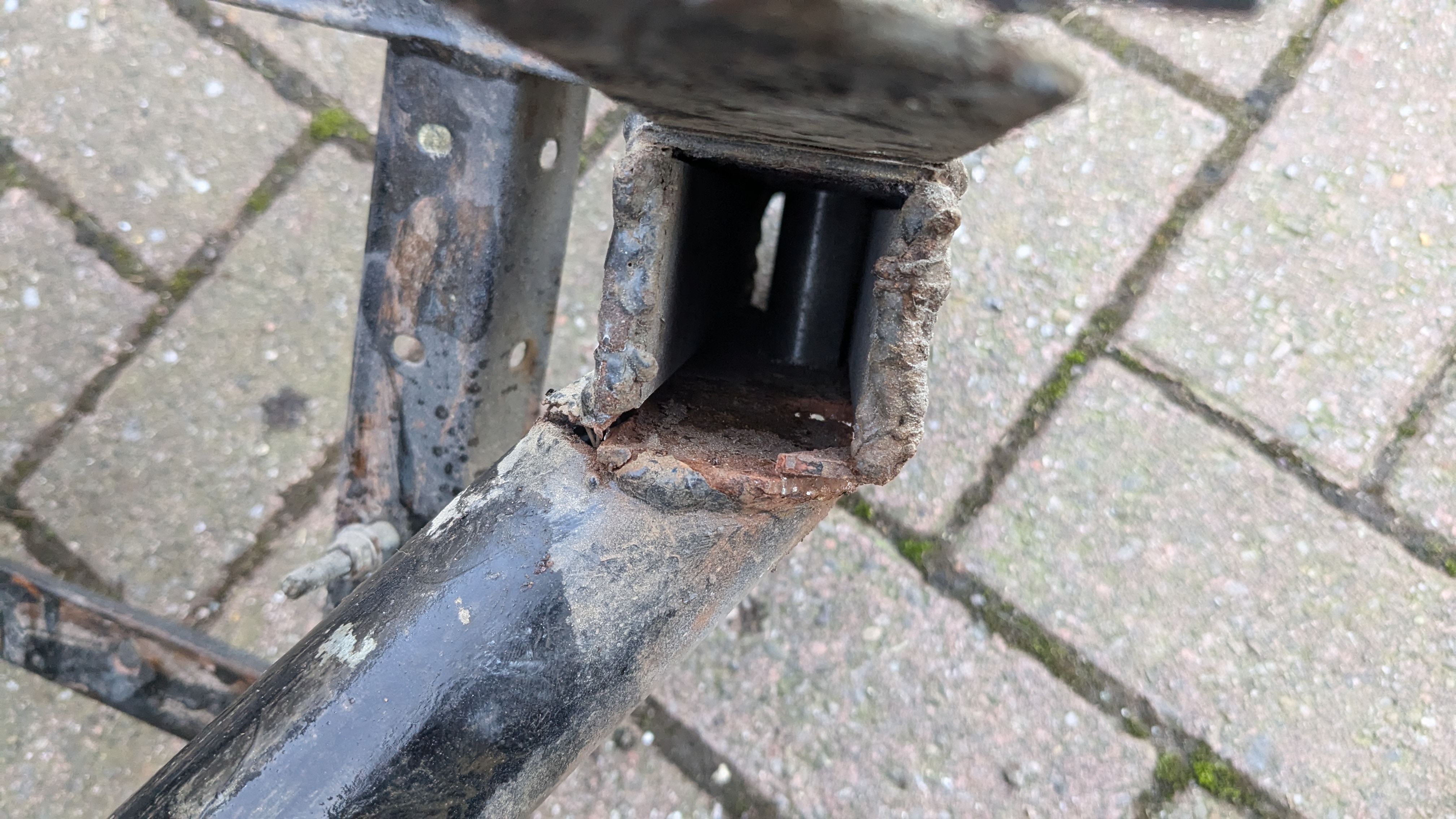

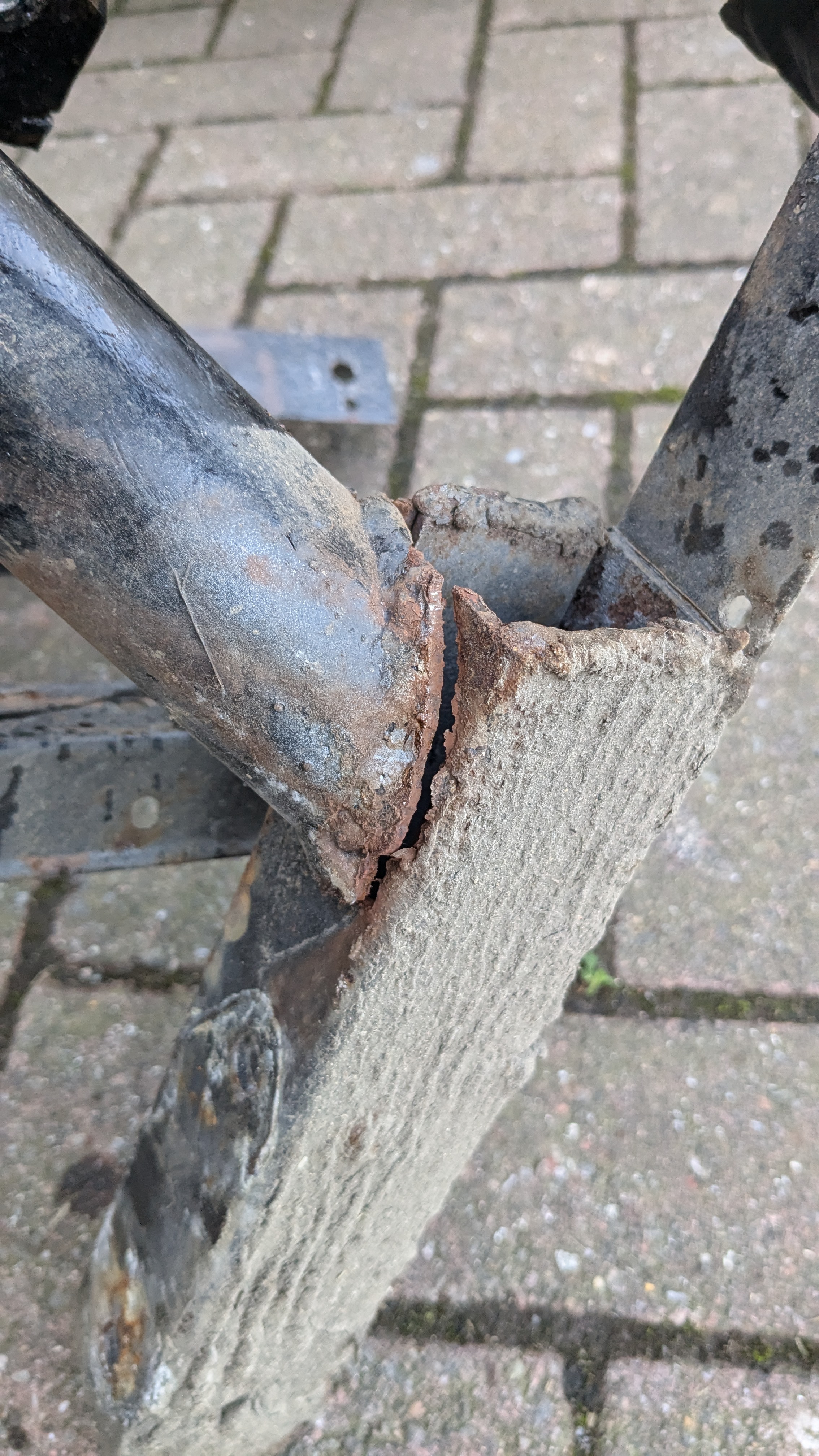

So I had to jinx it by saying how great everything was running. Driving home Monday evening there was vibration under acceleration. Closer to home that turned into a clunking noise on accelerating or regen. Upon inspection I found the motor torque rod had broken free, it was dark so I assumed my shoddy welding had given out. I had recently replaced the worn tie rod bush with a Polybush, given vibration wasn't an issue I figured the Polybush would be nice for a bit more durability. Although as much as I can try to blame the polybush, it was poor fabrication work that failed.
I switched off regen and nursed it home before the main mount failed and the motor fell out.

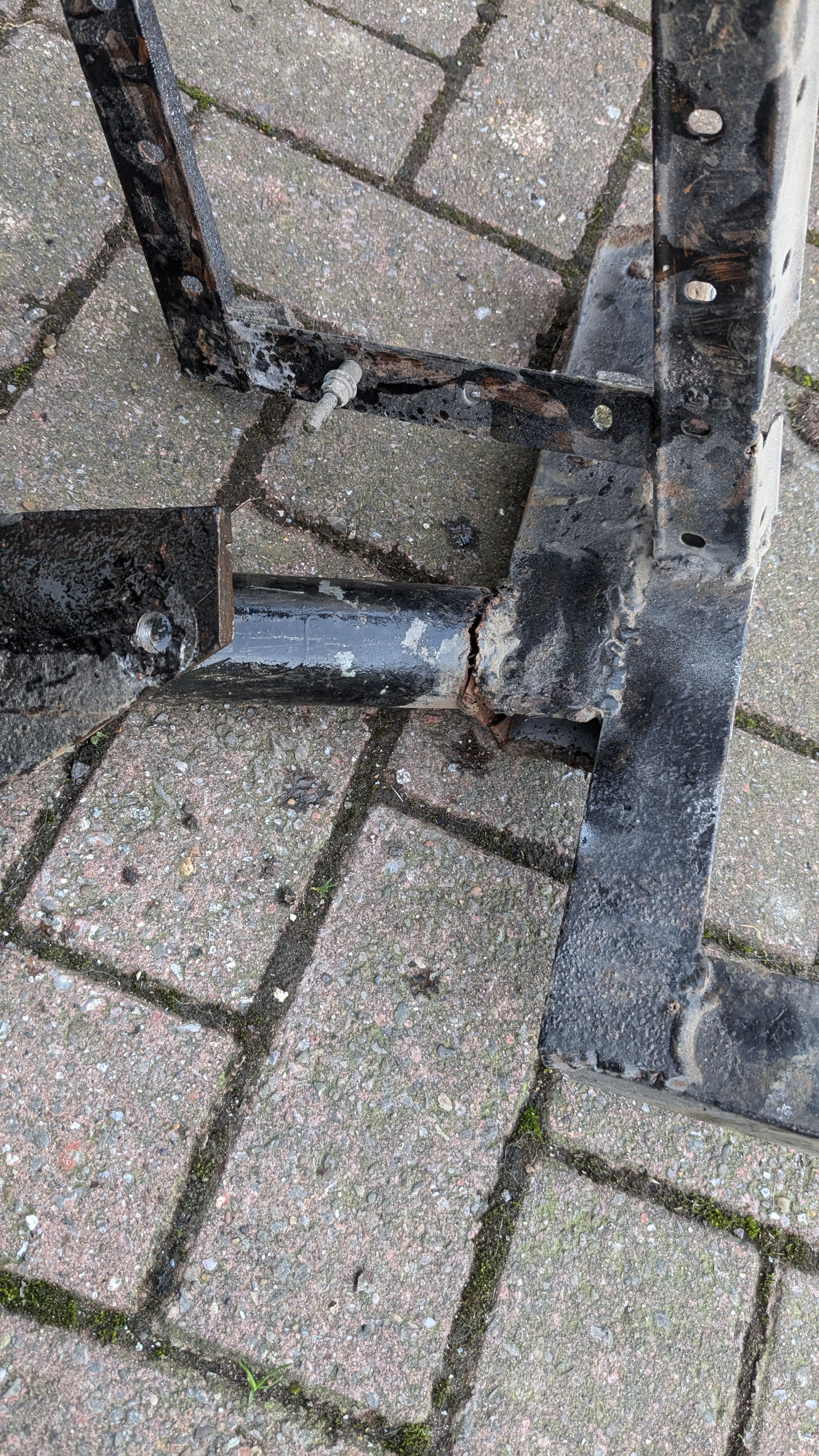

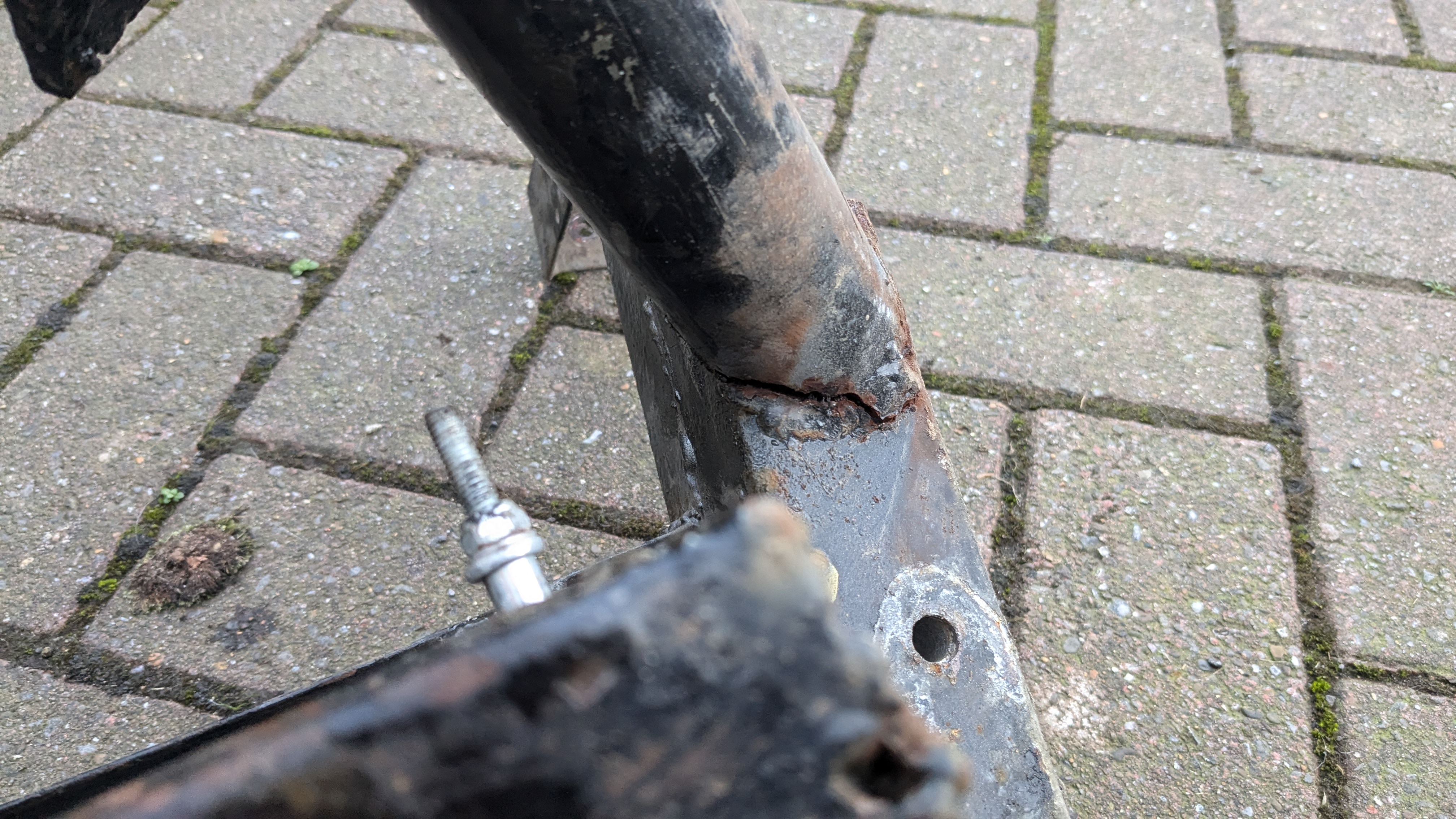

Managed to get some time to look at it today. Removing the wheel and side cover it was looking pretty obvious and maybe quite an easy fix. Just unbolt that bracket, weld it back up with some reinforcement and we are back on the road. However on that evening I was worried about how much the motor was rocking under load, especially with a hard mounting on that side. I was quite worried it would give out before I got home. So I took a look at main motor bracket on that side and saw some further weld failures.
For reference here is the bracket all nice and clean and new a couple years ago. Here it is now. I wasn't 100% happy with it at the time. Even less so now. I'll get it to the farm this weekend and clean it up, redo those welds and add a ton of reinforcements. I would ideally like to redesign the main mount from scratch, but I don't really want the car off the road for too long.

Even OEM's can "under engineer" engine/motor mounts.

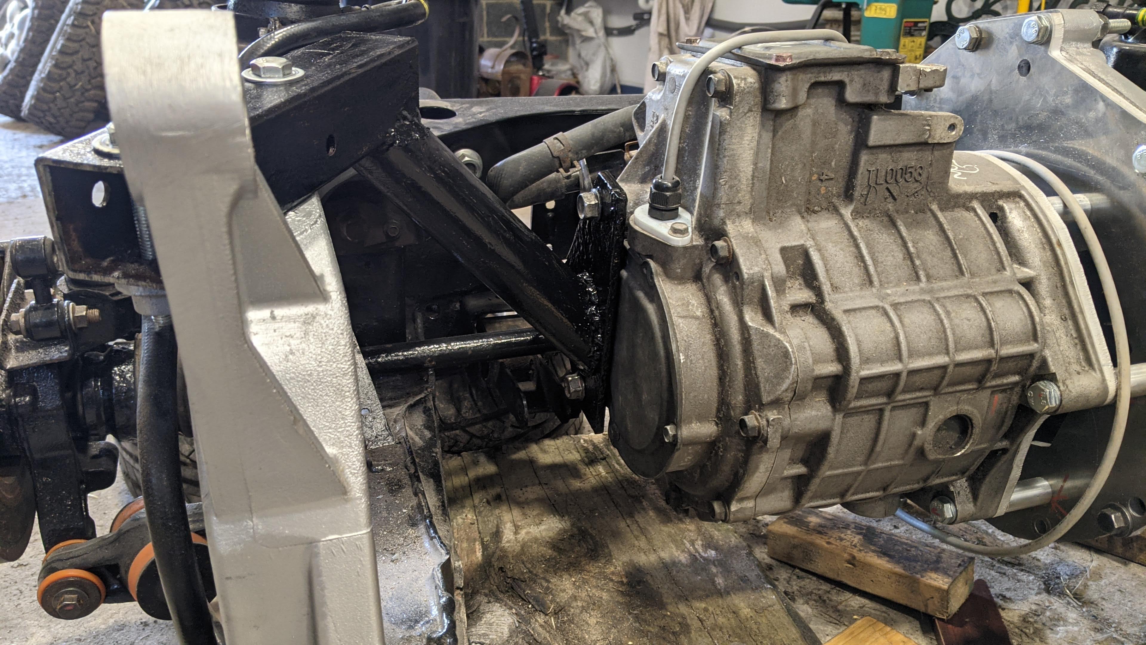

Back on the road again today. Forgot to take any photos but I just cleaned up and redid the welds, then added a few more supports. Seems to be running well so far. Much less movement under load than I ever remember seeing, so I think these mounts were giving out for quite a long time.
I'll come back to this if I ever get around to mark 3. I have some rough ideas of using the MG ZS drive train, then potentially I can fit the batteries in the engine bay with an MG charger in the fuel tank area. Would be quite cool to EV an old MG with modern MG parts. In all likelihood I'm not sure I'll ever get around to this though. Maybe in another 10 years when I can fit 24kWh into a suitcase.
