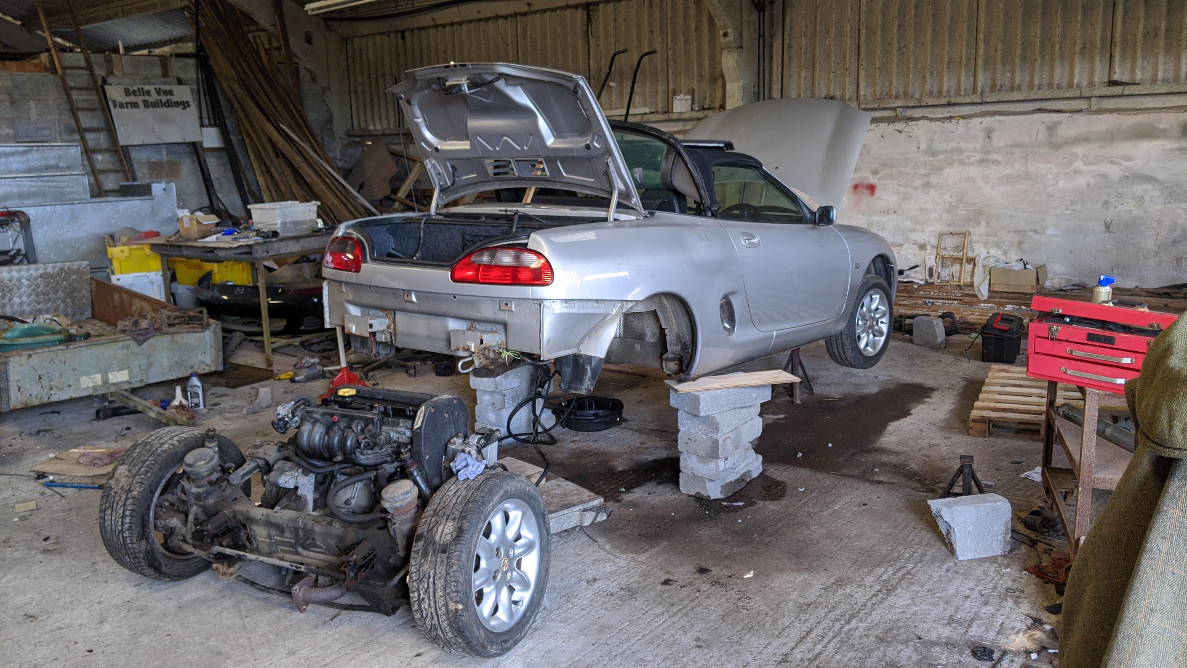

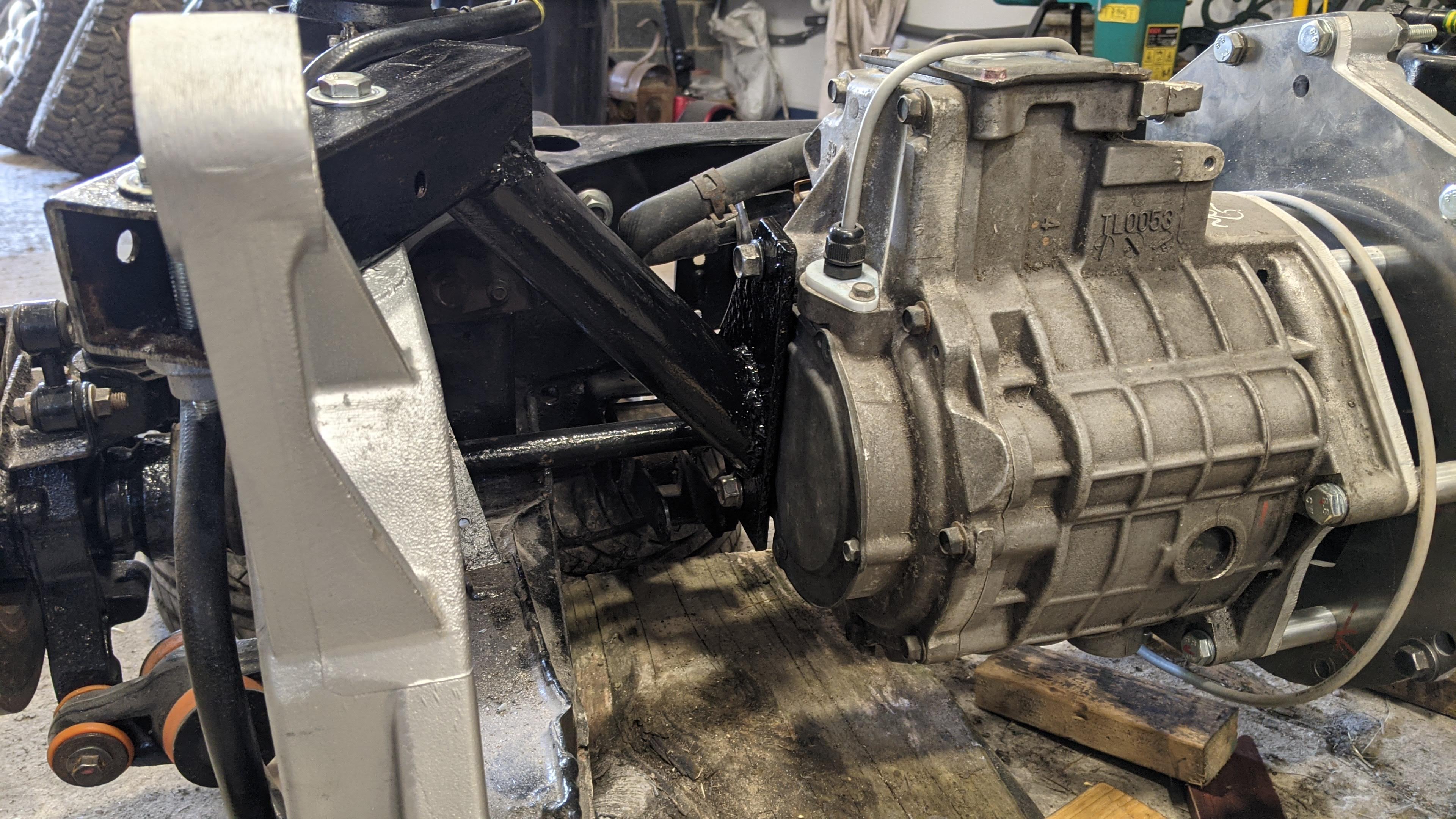

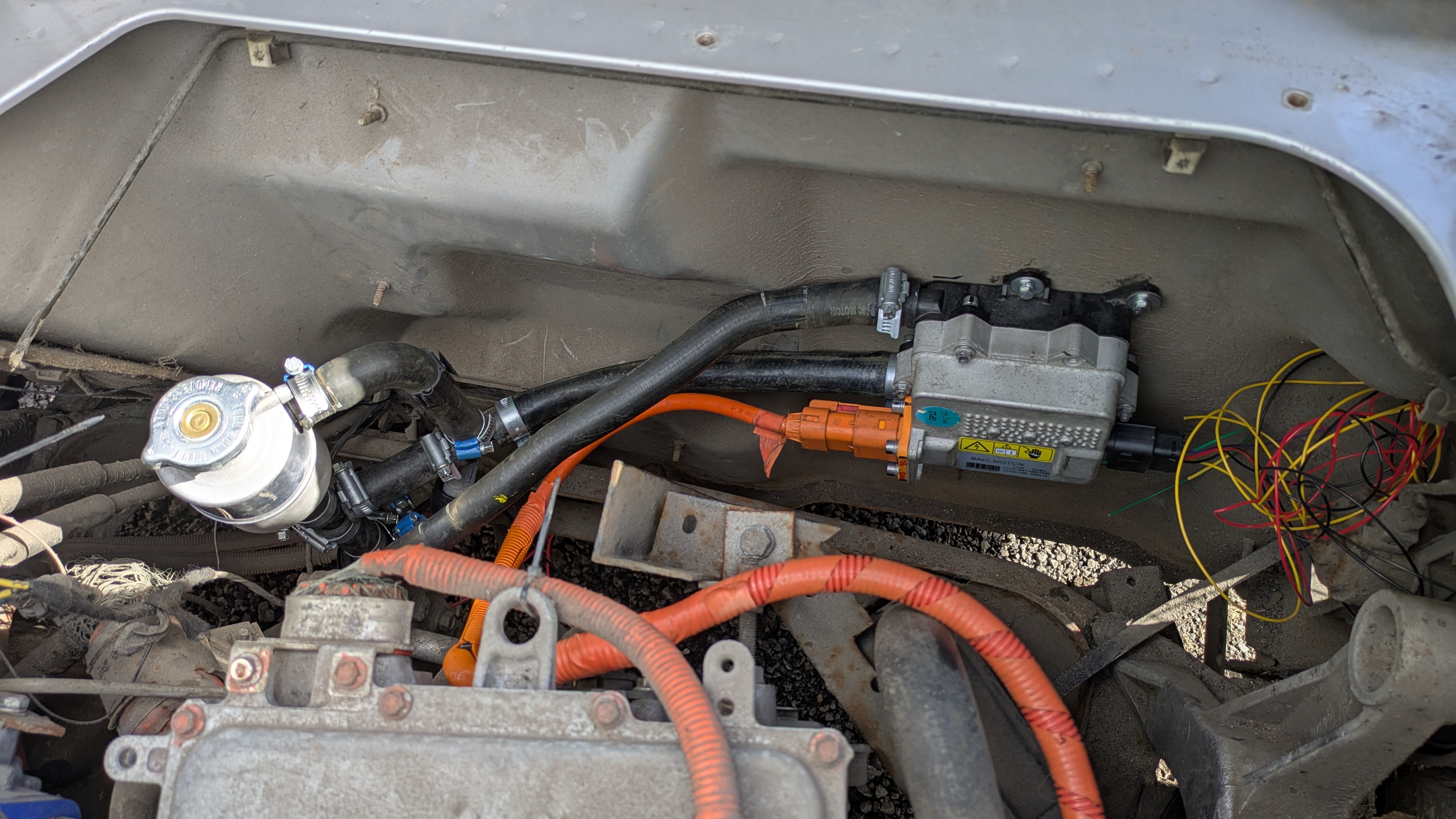

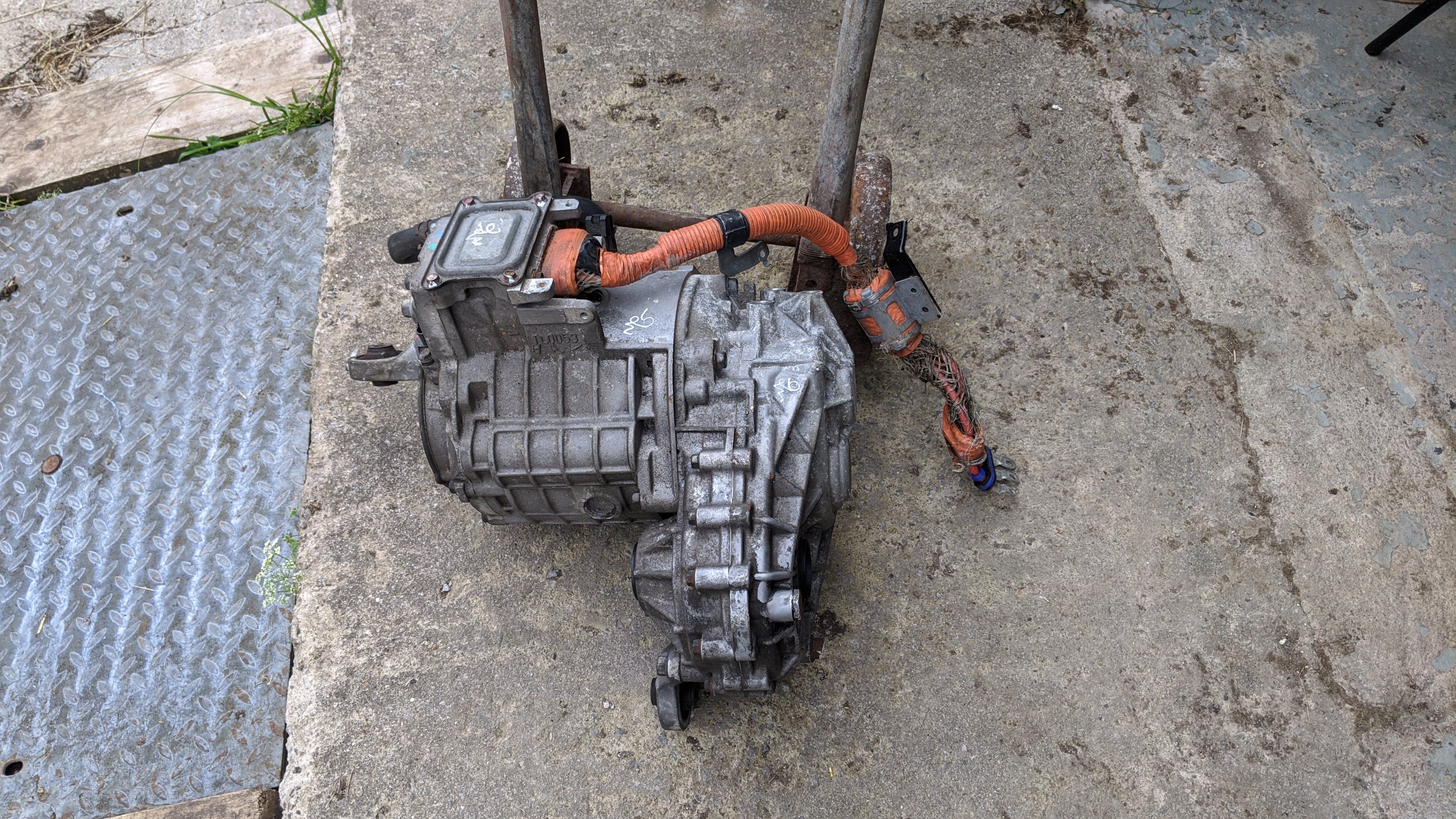

Here we go! Had the Outlander rear diff delivered this week. Going to spend the next week trying to find a replacement wiring loom plug for it.

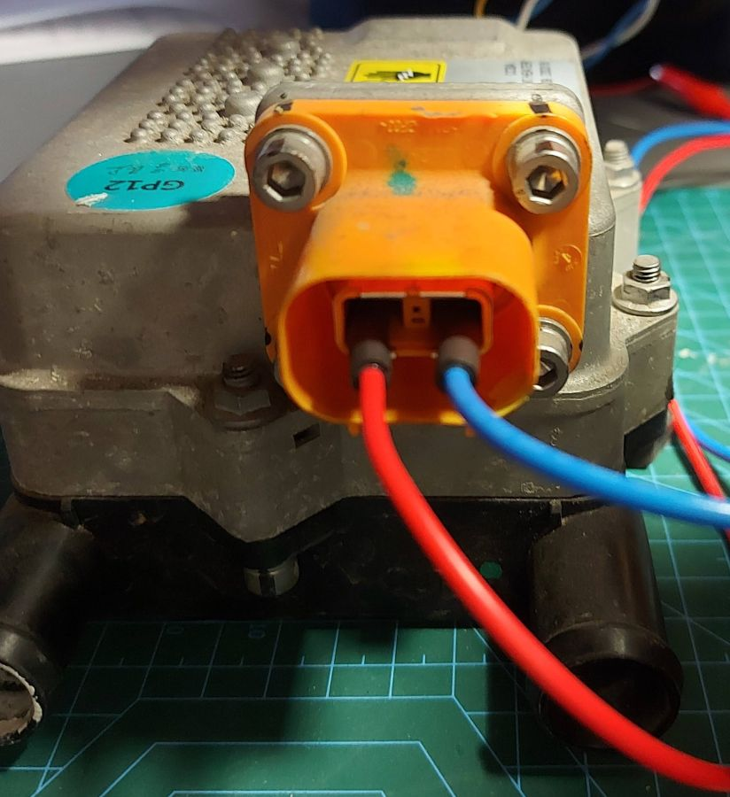

Ordered one of Johu's control boards for the inverter. Planning to play around with it on the 48v battery from my quad bike initially and see if I can start getting lights to blink or something.
Already starting to think about other tasks on the car. Things like:
Cooling, I think I will connect the inverter and motor cooling lines together and run them to the radiator at the front of the car. I did buy the inverter pump but I think it might be a bit small for pumping coolant that far.
Dash readouts. It's pre canbus, so I'll have to spend some time figuring out how each readout receives its data and then think how I can emulate that to be relevant to the new drive train.
Battery location. Planning on using BMW hybrid batteries, MG Fs are light on the front so I'll put the first pack there and see how it goes. I was hoping to weigh the car before and after to see how this affects the front/rear balance. But car scales seem very expensive.

When you remove the fuel tank there should be a fair bit of room for batteries, there won't be much room under the bonnet.
Have you got the pump for pumping up the suspension? I can't remember what the height is meant to be but should be easy to find out.
The electric steering will save you time there and no CAN will also help.

Thanks for the pointer on the fuel tank. Waiting for space in the shed at the moment before I get the car in and drop all of that out.
I have a pump for the suspension. It was almost scraping the bottom of the car on large bits of gravel when I first got it! Pretty easy to pump up actually, although it might be trickier the next time as there will be air in the system. But that's a problem for future me.
There is already bits missing from the car now so the time for weighing it has passed. Although ICE weight distribution should be easy enough to find out. Will be plenty of time to weigh it after when it's finished.
Got the motor spinning today in manual mode. Going to plug in the throttle tomorrow and try to get it running on that. Then I need to add in forward and reverse controls.
Video of the setup at the moment:

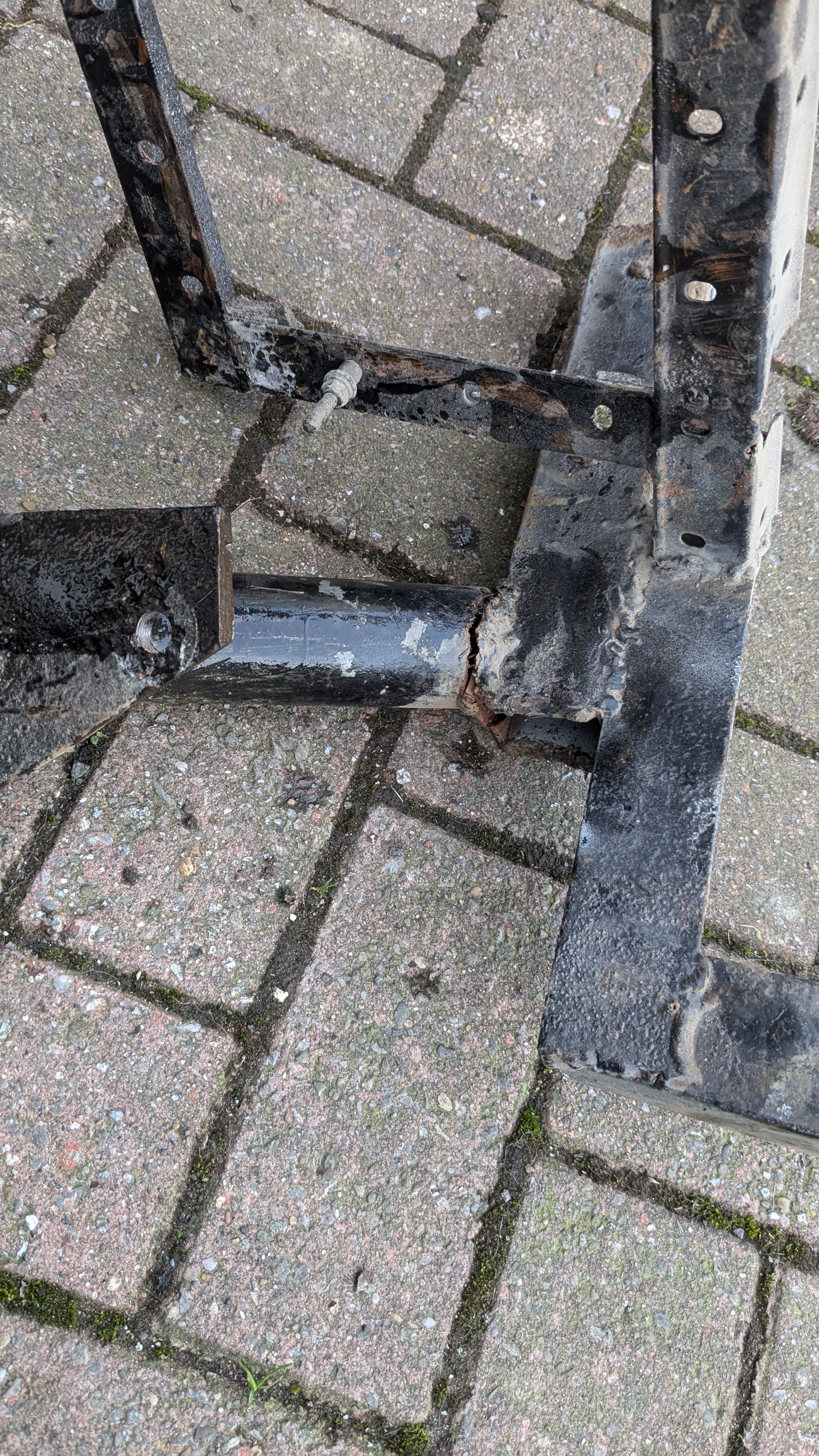

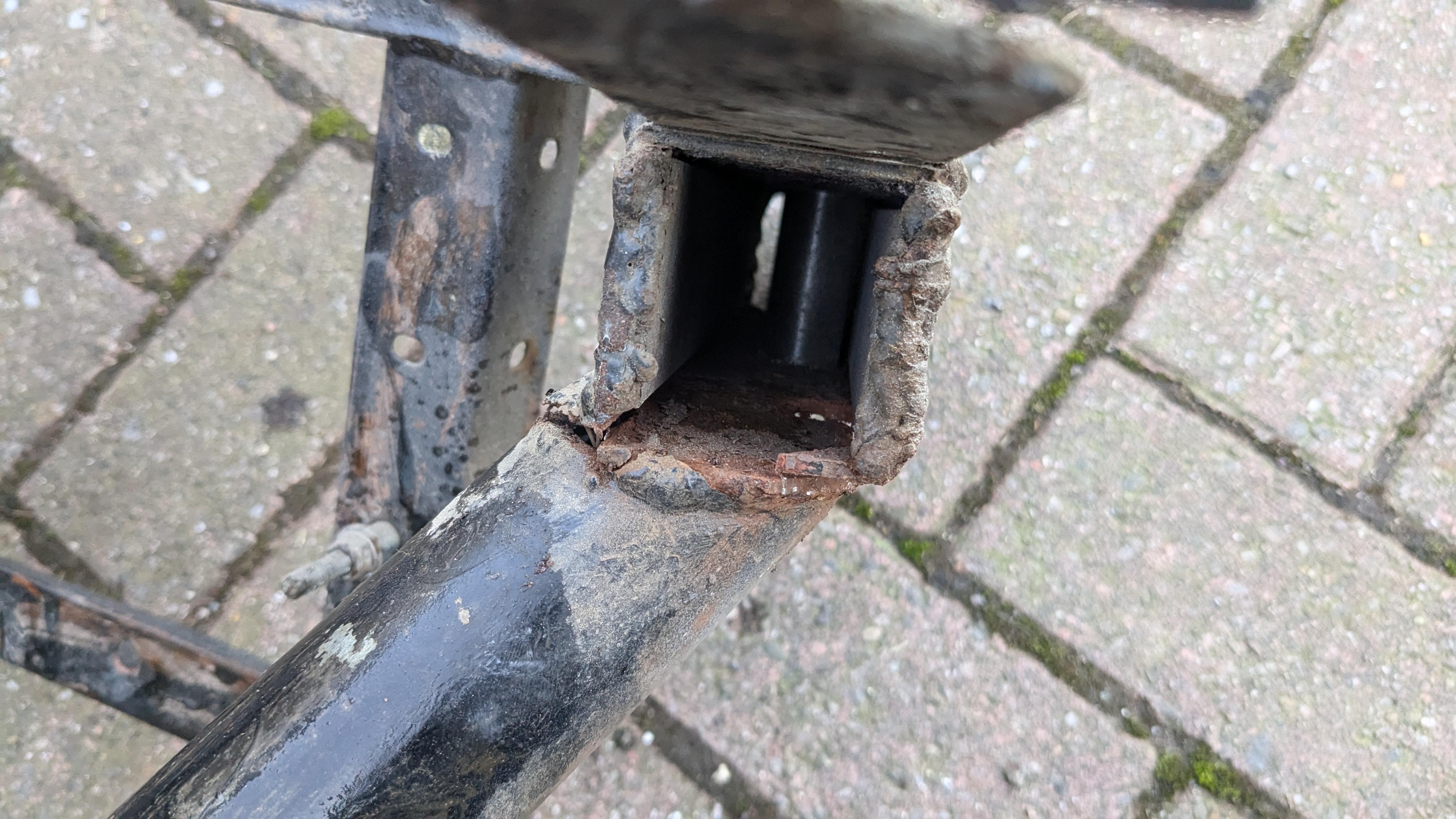

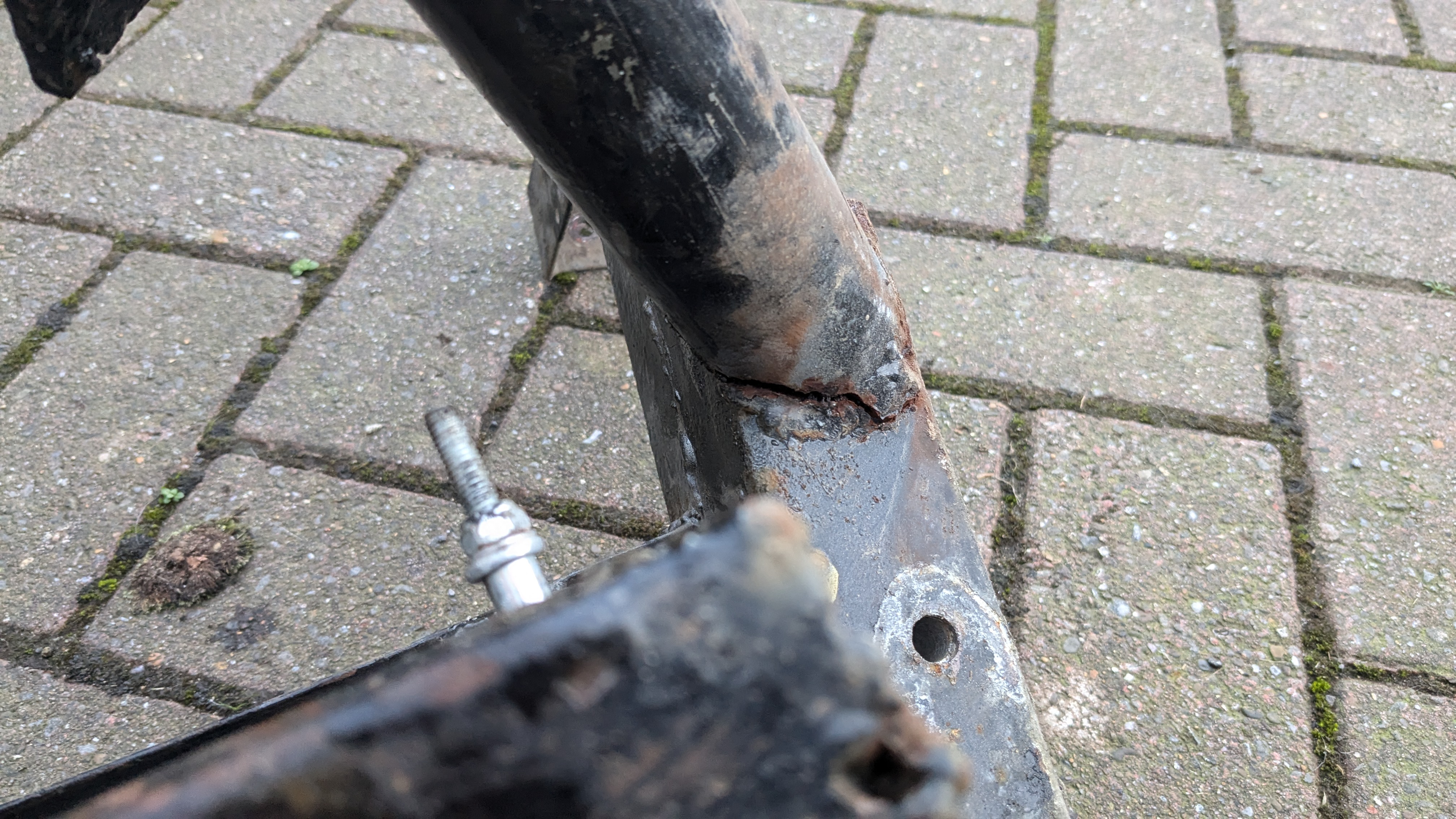

On a three day week now so I have a bit more time for this project. Also I also have to squeeze in upgrading my quad motor to 72v and a Defender restoration.

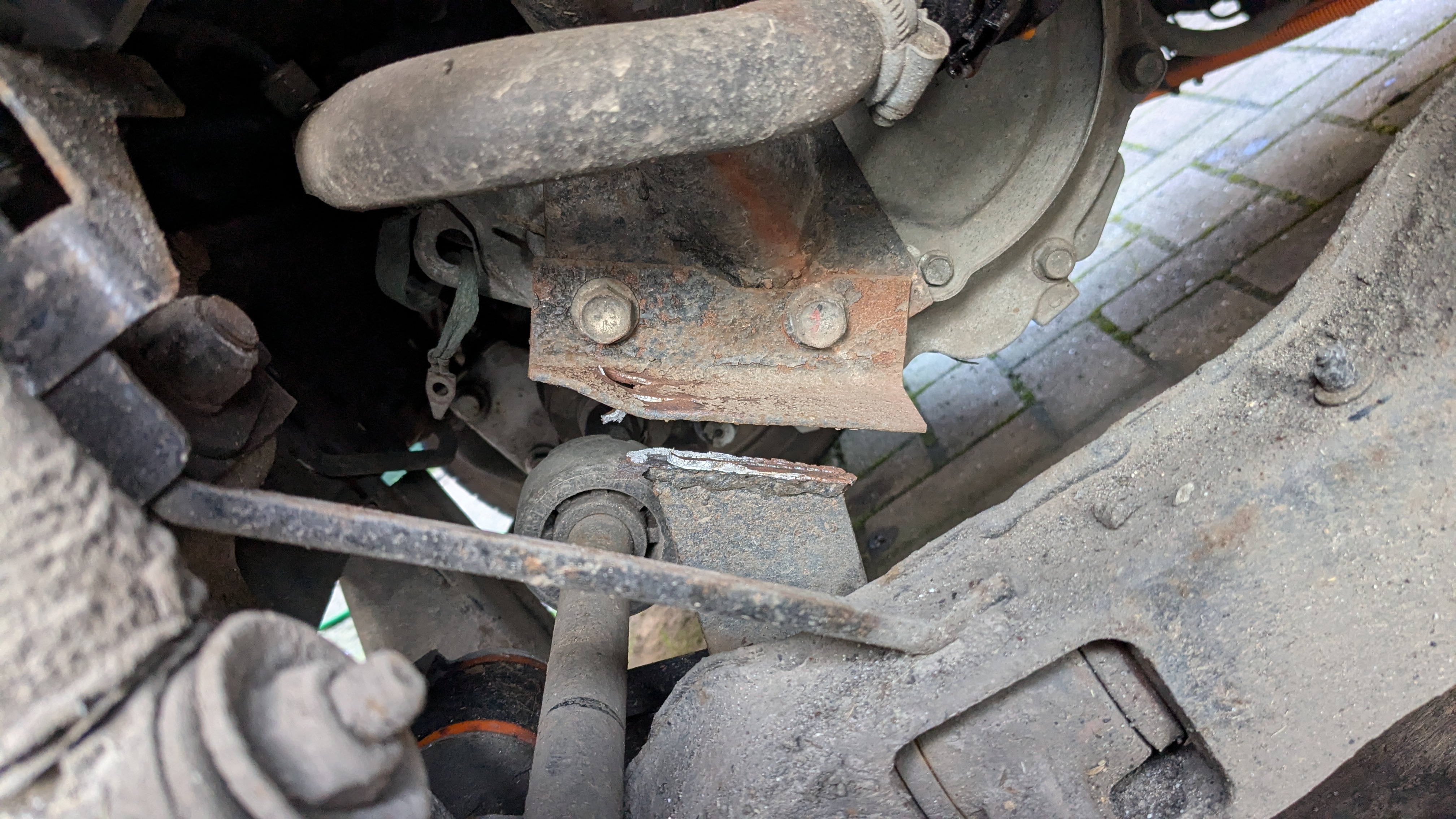

I now have the sub frame out of the car. Planning to disassemble it and split the engine and gearbox next weekend.

This photo reminds me of the time I helped a mate take his rear subframe and engine out. He had a large 3 or 4 inch plank the full width of the car with notches out of it for sills etc. The car was jacked up enough for this plank to go underneath at the back of the doors with a trolley jack so I was able to jack the rear of the car up high enough to roll the subframe out. It was only marginally less precarious looking than you're setup.LRBen wrote: ↑Sat Sep 12, 2020 7:35 pmThat's true. I think I might go down the 16s2p route in the end.
