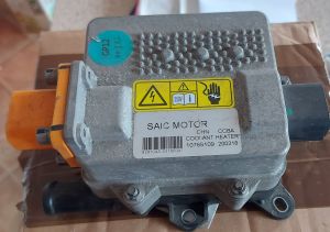

MG Coolant Heater
Heater Operating Voltage 230–450V
Rated Heater Output 3.5kW
Part No. 10769109 or 11009807
Mechanical
Dimensions 18cm x 14cm x10cm
Fittings 19mm

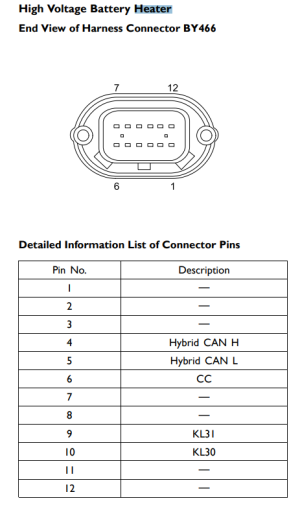

Low Voltage Connections
Mating connector Molex MX150 33472-1206
!Note numbering is 1 is top left if the Keying wings are at the top.
CC is a 12V wake up in / ignition (ensure to apply 12V only after KL30 has 12V, not at the same time)
KL31 is Ground
KL30 is permanent 12V
Pin 7 and 8 are for HVIL (continuity when HV plug seated)
No CAN termination inside

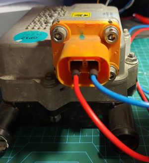

High Voltage Connections
Red-PositiveBlue-Negative
TE Connector Component Side: 2-2310540-2 HVA280 Key A
Mating plug should be (will updated once confirmed)
- 6-2103177-1 = Finger accessible latch, black
- 5-2103177-1 = Finger accessible latch
- 4-2103177-1 = Finger accessible latch with CPA
- 1-2103177-1 = Tool accessible latch
- 2103177-1 = Tool accessible latch with CPA
I tested and use 4-2103177-1
