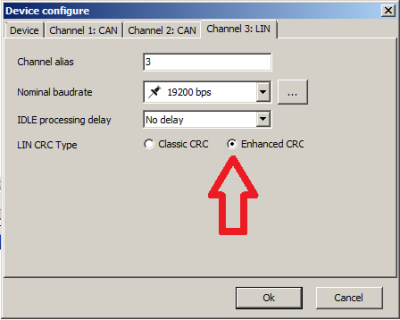

Check CRC? ID47
Posts: 2414
Location: Bristol
Has thanked: 209 times
Been thanked: 572 times
Re: Nissan Leaf ZE1 AC compressor LIN
Marat wrote: Sat Nov 02, 2024 8:56 pmCheck CRC? ID47
The CRC is calculated as the Avanched LIN 2.0 CRC and it checks out as correct according to my Lin capture device. But can mess around a bit with this.
